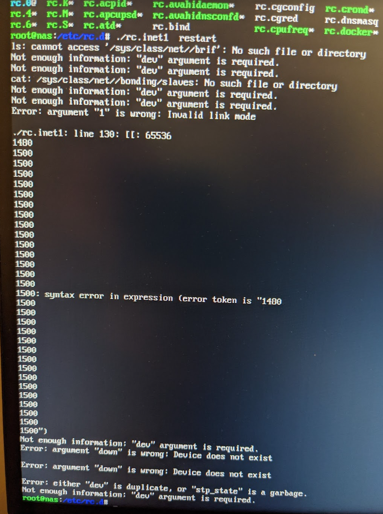

@ljm42I was getting the slider turning itself off automatically also. I managed to get it working by deleting the dev and dev wg0 instances in the config file, but the output from my running of the testnet.php script is below (and I have attached the diagnostics file). I also have a weird issue with deleting files from some android apps over SMB since updating from 6.9.2 and I'd love for these to be the same issue and resolved together, but likely not...
root@Tower:/tmp# php testnet.php
Array
    [DHCP_KEEPRESOLV] => no
    [DNS_SERVER1] => 208.67.222.222
    [DNS_SERVER2] => 1.1.1.1
    [DHCP6_KEEPRESOLV] => no
    [BONDING] => yes
    [BONDNAME] =>
    [BONDNICS] => eth0,eth1,eth2,eth3

HEY dev is empty!
tower-diagnostics-20221019-2209.zip

Thanks! This is definitely the problem we're chasing in this thread, and the diagnostics are helpful.
@b1ue @erak @chris smashe @AW139 @Klinkaroo @boardyuk @ZosoPage1963 @Quadrapole @x86intel @proteinart @aqua
Good news! We resolved the issue with the missing config values. This will be fixed automatically in the next release, but in the meantime here's what you can do:
  • First, stop the array.
  • Then navigate to Settings -> Network Settings and make any small change that makes the Apply button appear, then undo the change and hit Apply. This will rewrite your network config files and fill in the missing values.
  • Then start the array.
  • Finally, make a dummy change to each of your WireGuard configs to rewrite them with the new values (and undo-any manual changes you might have made)
At this point your WireGuard tunnels should start without issue.

Thank you for posting this. I landed here on a Google search.
Yesterday I stupidly made a change to my wireguard setting to try to get remote access to a custom network through wireguard. The change crashed my entire server. Had to pull my USB drive and manually edit wg0.conf to delete my change just to get unRAID to boot again. Then I changed my docker settings to allow "Host access to custom networks" -- which allowed my two dockers to talk to one another (and for me to have wireguard access to the custom network docker) but it killed internet access for me.
My output on the githubusercontent showed that my issue was not the issue in the thread, but in fact solved by you mentioning "disabled 'Host access to custom networks' in Docker settings". Wireguard is working again. My adguardhome-sync dockers are no longer working after disabling "Host access to custom networks" -- but whatever, I can manually sync things if needed.

These steps did not work for me. I'm currently using Unraid version 6.11.5. The network change I made was to my static ip, I switched it to a new one and after saving changes moved it back. For wireguard the change I made was to the port used, i then changed it back. To confirm there was nothing weird going on, after the first failure I restarted the entire unraid box.
wg-quick up wg0
[#] ip link add wg0 type wireguard
[#] wg setconf wg0 /dev/fd/63
Warning: AllowedIP has nonzero host part: 192.168.1.1/24
[#] ip -4 address add 10.253.0.1 dev wg0
[#] ip link set mtu 1420 up dev wg0
[#] ip -4 route add 10.253.0.3/32 dev wg0
[#] ip -4 route add 192.168.1.0/24 dev wg0
RTNETLINK answers: File exists
[#] ip link delete dev wg0
wg-quick down wg0
wg-quick: `wg0' is not a WireGuard interface
