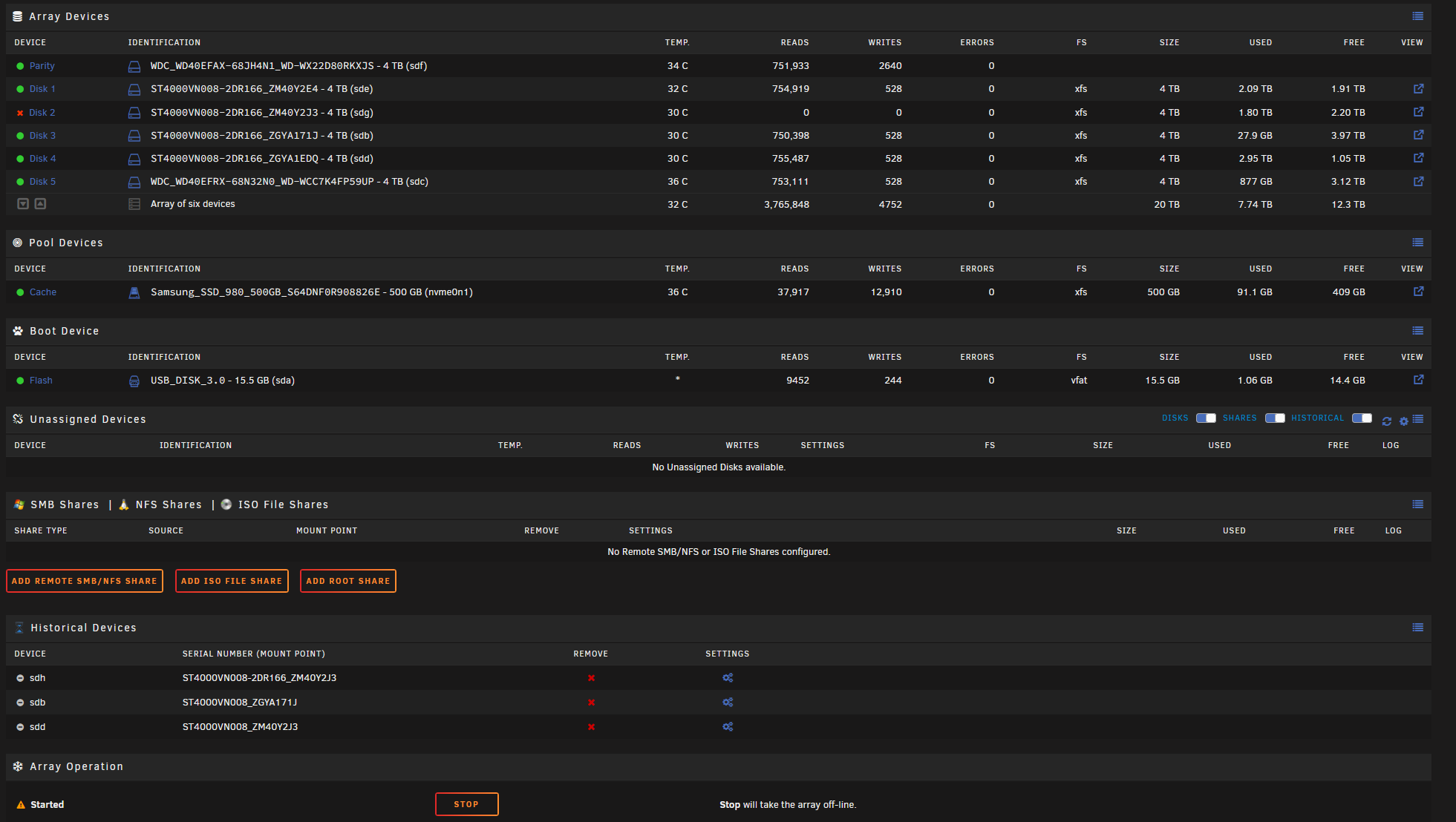

I have been having some trouble with parity checks lately, being really slow, taking 52 days to finish and so on and I saw on some forum post that swapping SATA cables might do the trick. Mine were really old from various other systems I had so I have no idea if they were bad or not so I swapped them all out for new ones.

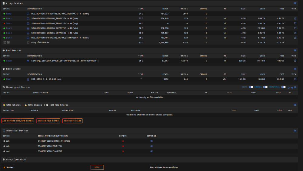

That's were the trouble starts, one of my drive stopped working after that. I try running xfs_repair but when I did that another disk started having problems. I have to admit I have little idea what I'm doing and I don't know what's happening. Sometimes my system feels like a house of cards.
I noticed the disks with the error changed partition names, like in the Unassigned Devices they all of a sudden had sdb and sdd but they had a different ones when part of the array.
Logs and screenshot of the disks are attached. I hope someone here can help.
Thanks a lot!

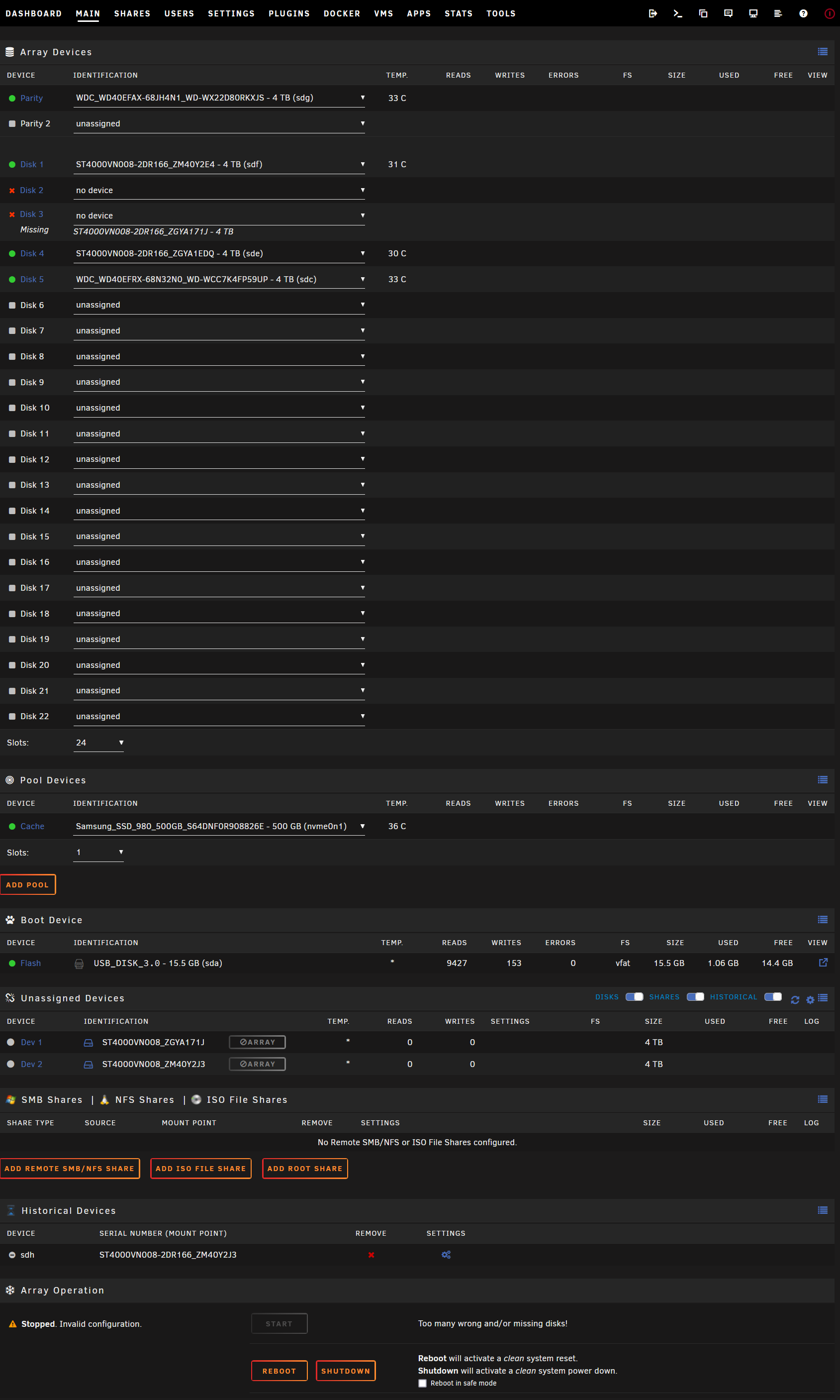

I updated the BIOS and it seems to have fixed one of the drives, but the original one is still out. This is the error I get now:
Oct  8 18:15:12 Cybertron kernel: ata4.00: exception Emask 0x50 SAct 0x2000 SErr 0xb0802 action 0xe frozen
Oct  8 18:15:18 Cybertron kernel: I/O error, dev sdd, sector 24 op 0x0:(READ) flags 0x80700 phys_seg 1 prio class 0
I'm baffled. I'm getting no errors or anything and the disk seems to be there (logs seem to say so as well) but the menu says the disk is disabled.
Anyone know what's going on?
