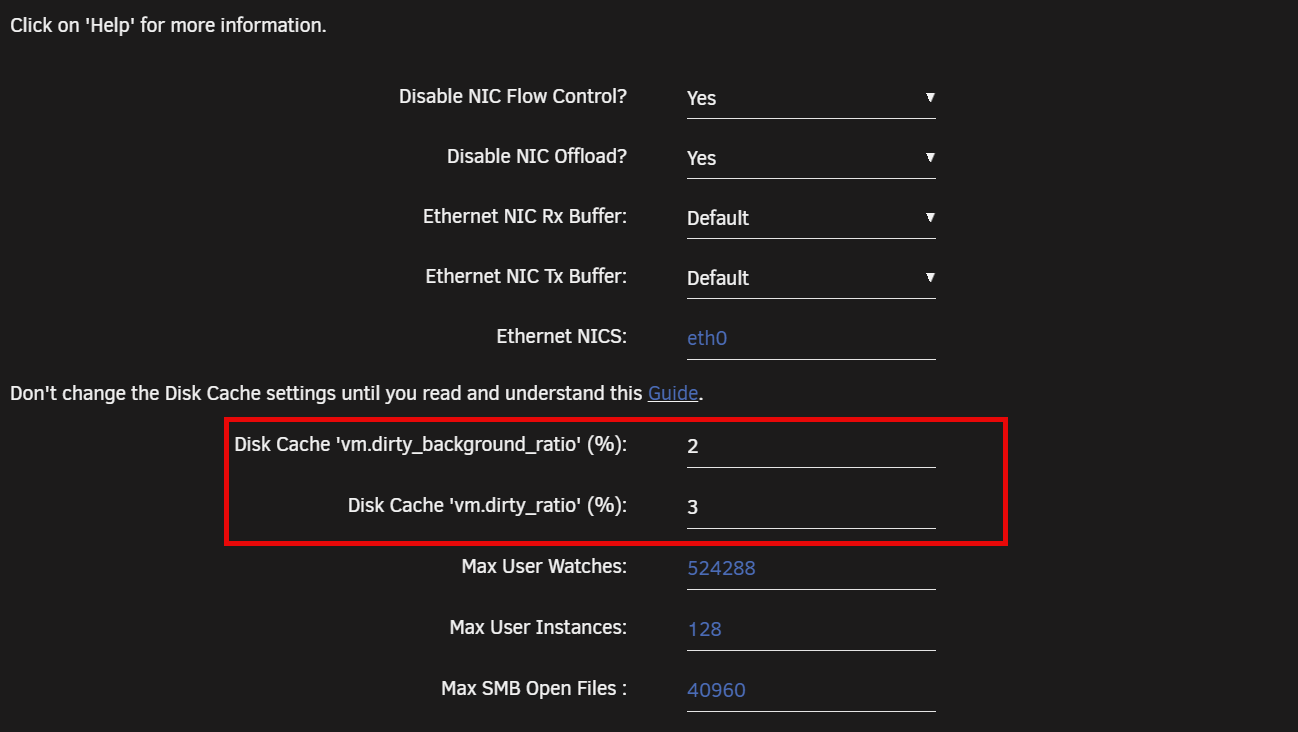

Can you try installing the Tips and Tweaks plugin and setting these values lower, let me know if it helps you with memory backing on?
The help text said to set them to 2 and 3 for gaming and streaming VMs and that lower values are better if you have a lot of RAM which in my case 64 GB probably qualifies. I won't know for another couple of hours if this has worked.
The command cat /proc/buddyinfo is helpful for checking fragmentation. It shows free blocks of various sizes ranked from smallest to largest left to right.
If you have a lot of small blocks and few large ones it indicated fragmentation based on the research I was doing. The Normal zone is most relevant to VMs.

I can confirm after letting my system sit for quite a while setting
vm.dirty_background_ratio
to 2 %
and setting
vm.dirty_ratio
to 3 % solves this memory related issue and improves VM performance when using memory backing.
@SimonF this issue may affect more than just me as @johnsanc was seeing. After a memory backing enabled VM is up for a while other VMs won't start properly. I also personally noticed slowdowns on my main VM that seem to be related to this. Perhaps something needs to be set in Unraid automatically to modify these values when memory backing is in use. Is this something that can be done for 6.13 to improve VirtioFS support further?
I'm not sure if that setting did the trick or not, but either way it sounds like those defaults were not appropriate for my use case.
I tried making the changes you listed and let it sit several hours. I started my Windows 10 VM and it hung at the boot screen... so no noticeable change. I have 128GB of RAM and I originally allocated 96GB to my Windows 11 VM (with memorybacking), and 8GB to a Windows 10 VM. I dropped my Win11 VM down to 64GB and now Win10 boots without any issues.
So I guess even though I had plenty of memory to go around, something wasn't playing nice. Not sure if maybe I needed to reboot my Win11 VM after changing the two settings you mentioned for it to take effect. Maybe I'll try out a few other memory combinations tomorrow to see if I can reproduce the hanging behavior of my Win10 VM.
