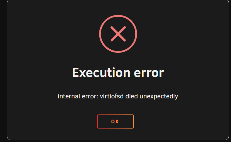

@SimonF so I did this and replaced the file. When I add a few mounts and try to start my VM I get this error.
I got this working, it took me a little while to figure out what flock and posix_lock meant. I edited the xml and switched those from on to off for each mount. Now Windows is booted. I'm going to test and report back tomorrow if it locked up. I'm doing a trial of Backblaze personal backup now to really stress test it. Thanks Simon!
