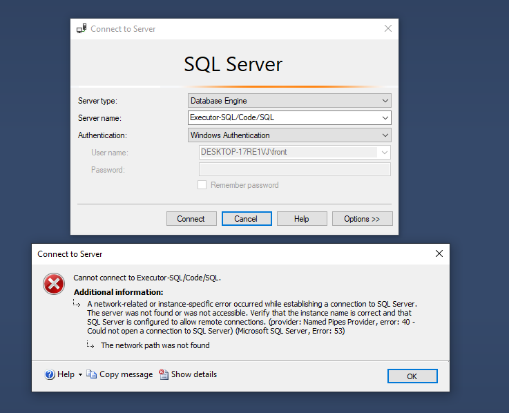

Hi All,
Newbie here.
I've installed the docker "MY-SQL-Server" and it installed just fine, no issues.
But when I go to do the initial login I get issues of it not being seen.

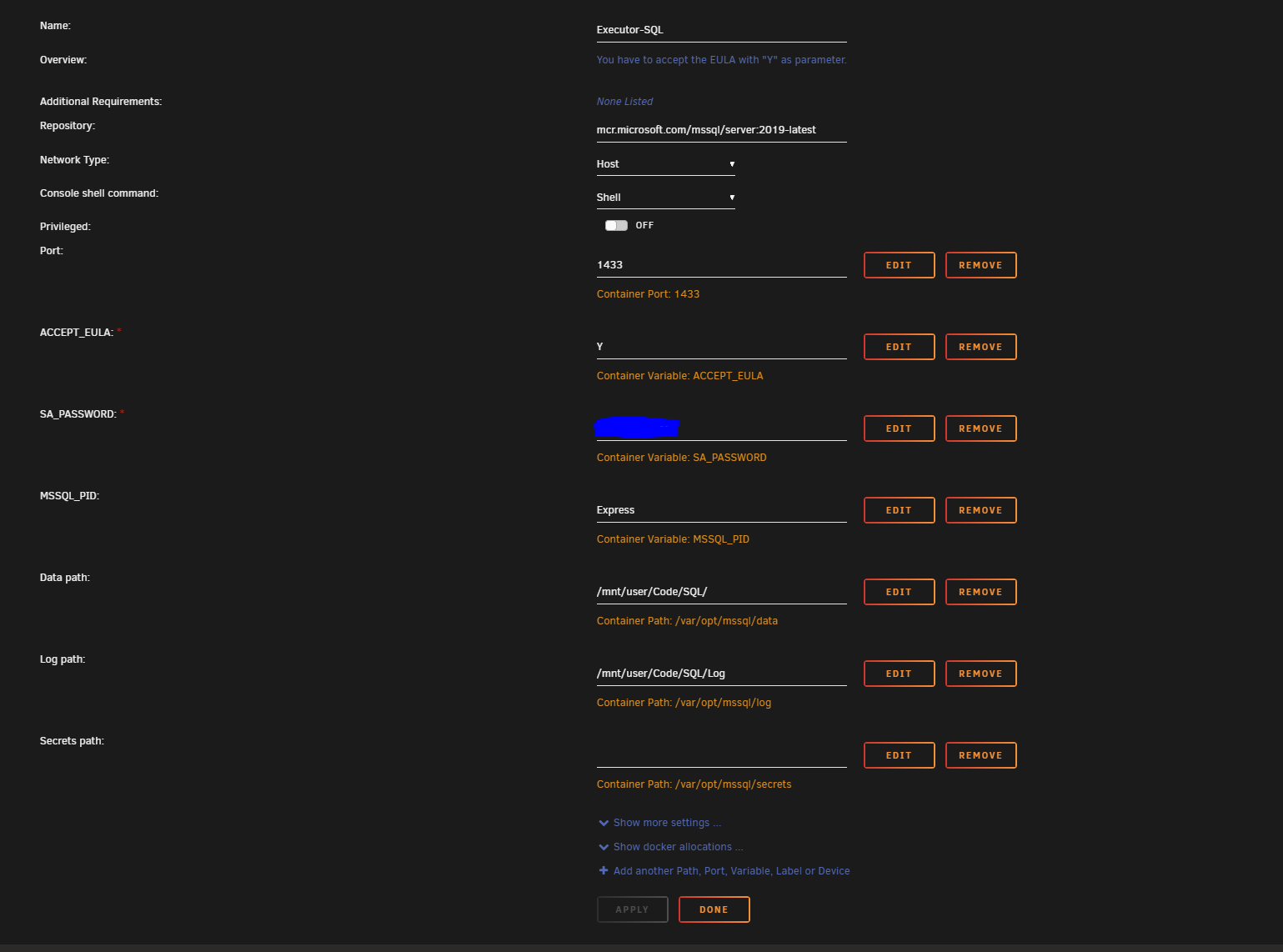

Current Settings for the docker:
When I then go into SMSS and enter in the server name I get an error (See below).
I've tried to browse to my network but it doesn't see it.
I'm not sure what I'm missing. I am new to running a server so it's very possible I'm missing a bunch of things, or maybe did something wrong.
Any help would be greatly appreciated!!
Error msg

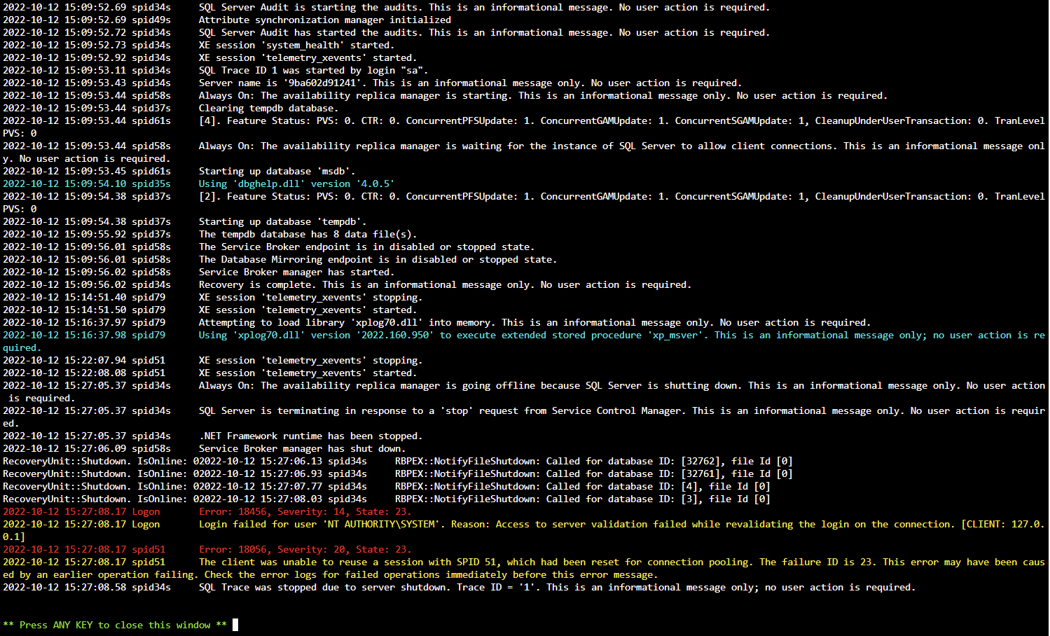

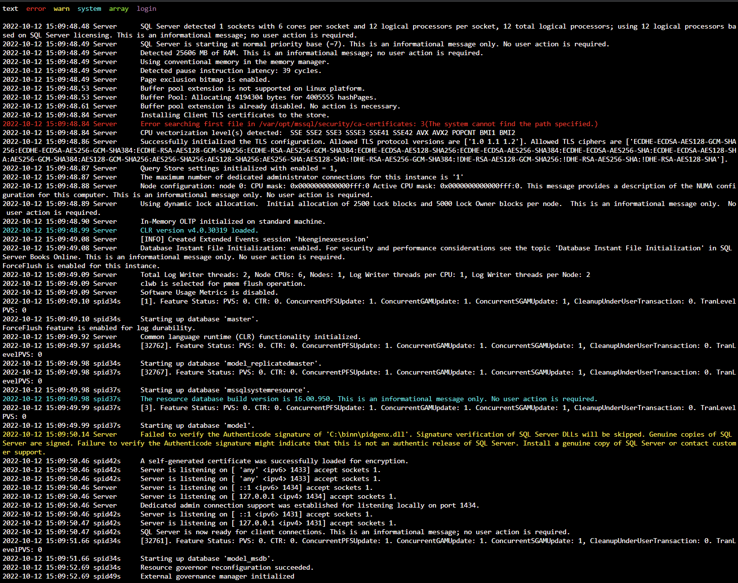

Just giving this question a bump. Also adding the logs from the SQL Server container in hopes that might help.
