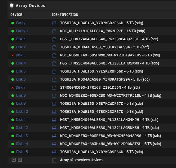

I have two data drives that have been disabled because of errors. I am preclearing two 18tb replacement drives right now but they are both larger than the parity drives so they will have to replace those first. I've replaced drives several times before but this is a little more complicated so I don't want to screw anything up. What's the best procedure for this situation? Will the array still be protected if those two are disabled and I replace a parity drive? I'm probably just being overly paranoid about this.

One of them is probably fine but the other one is over 7 years old so faulty or not, that one's getting replaced. I was hoping to avoid having the array unavailable.

Diags are after rebooting so we cannot see what happened but disk3 looks fine, disk7 should be replaced since there's a failing NOW attribute, parity swap requires that the array be offline during the parity copy part, it will be online for the rebuild.
