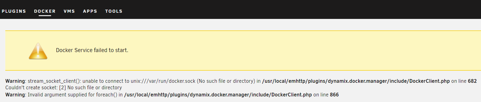

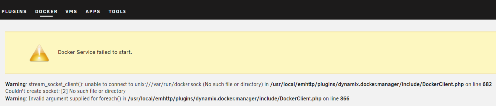

  5. Both cache drive shows in pool normally, and I thought everything is fine now, but that is not the case
    1. I am not able to access the Dockers tab and it shows something as follow:
    2. Warning: stream_socket_client(): unable to connect to unix:///var/run/docker.sock (No such file or directory) in /usr/local/emhttp/plugins/dynamix.docker.manager/include/DockerClient.php on line 682
      Couldn't create socket: [2] No such file or directory
      Warning: Invalid argument supplied for foreach() in /usr/local/emhttp/plugins/dynamix.docker.manager/include/DockerClient.php on line 866

  7. I am now not able to use any Dockers, and I at the moment am afraid of doing any more configuration until further advices are given. Please help thanks a lot!
