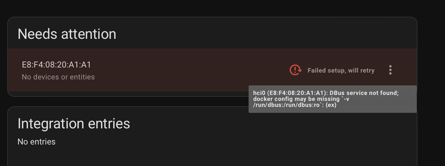

March 7, 20233 yr I am also having this issue, trying to forward /run/dbus causes the container to error out: I have also tried to forward /dev/bus/usb/ to the container and it seems like it can see the devices but cannot utilize them: From HA: Edited March 7, 20233 yr by Deadpool1985
March 18, 20233 yr On 3/7/2023 at 7:51 PM, Deadpool1985 said: I am also having this issue, trying to forward /run/dbus causes the container to error out: I have also tried to forward /dev/bus/usb/ to the container and it seems like it can see the devices but cannot utilize them: From HA: I think you need to pass through '/run/dbus' as a path rather than as a device. I got mine working after installing bluez through un-get and then using the following docker command: docker run -d --name='homeassistant' --net='host' -e TZ="Europe/London" -e HOST_OS="Unraid" -e HOST_HOSTNAME="my-server-name" -e HOST_CONTAINERNAME="homeassistant" -e 'TCP_PORT_8123'='8123' -e 'PUID'='99' -e 'PGID'='100' -e 'UMASK'='022' -l net.unraid.docker.managed=dockerman -l net.unraid.docker.webui='http://[IP]:[PORT:8123]' -l net.unraid.docker.icon='https://raw.githubusercontent.com/linuxserver/docker-templates/master/linuxserver.io/img/homeassistant-logo.png' -v '/run/dbus':'/run/dbus':'rw' -v '/mnt/user/appdata/homeassistant':'/config':'rw' --device='/dev/bus/usb/007/005' 'lscr.io/linuxserver/homeassistant'

January 22, 20242 yr On 11/8/2023 at 7:12 PM, dopeytree said: How do you mount /run/dbus ? In home assistant it's saying... Just add a path like that: Works perfect for me:
