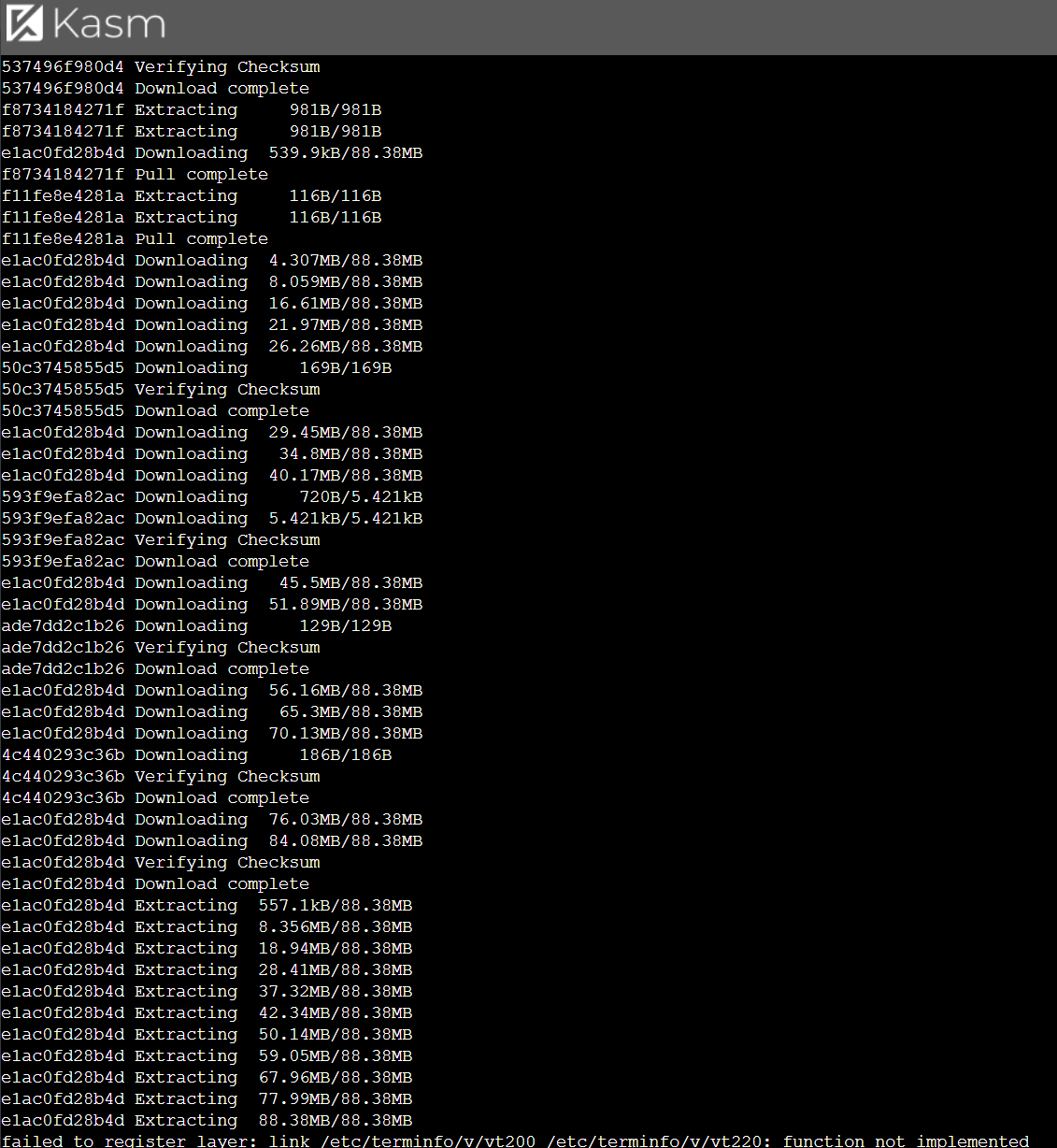

February 22, 20233 yr On 10/28/2022 at 6:16 AM, arch1mede said: I tried this, it did not work for me. Sadly. Is your install wizard completeing after you launch the container and choose which apps you want to install? When i choose more than a couple apps, mine is hanging and not finishing. I tested with just doing one or two apps and watched the progress in the container, and one of the last steps is provisioning the user accounts. So if the install wizard is not completing, the admin and user accounts will not get provisioned. I am looking for how to troubleshoot why my installation wizard is not finishing, and i came across your post so it thought I'd chime in
June 2, 20242 yr Have similar errors, Ive installed it, it boots up, asks for my Admin and User password to save. Then it goes initiating and crashes with an error Tried like 4-5 different version images, im unaware what kasm is not receiving.
