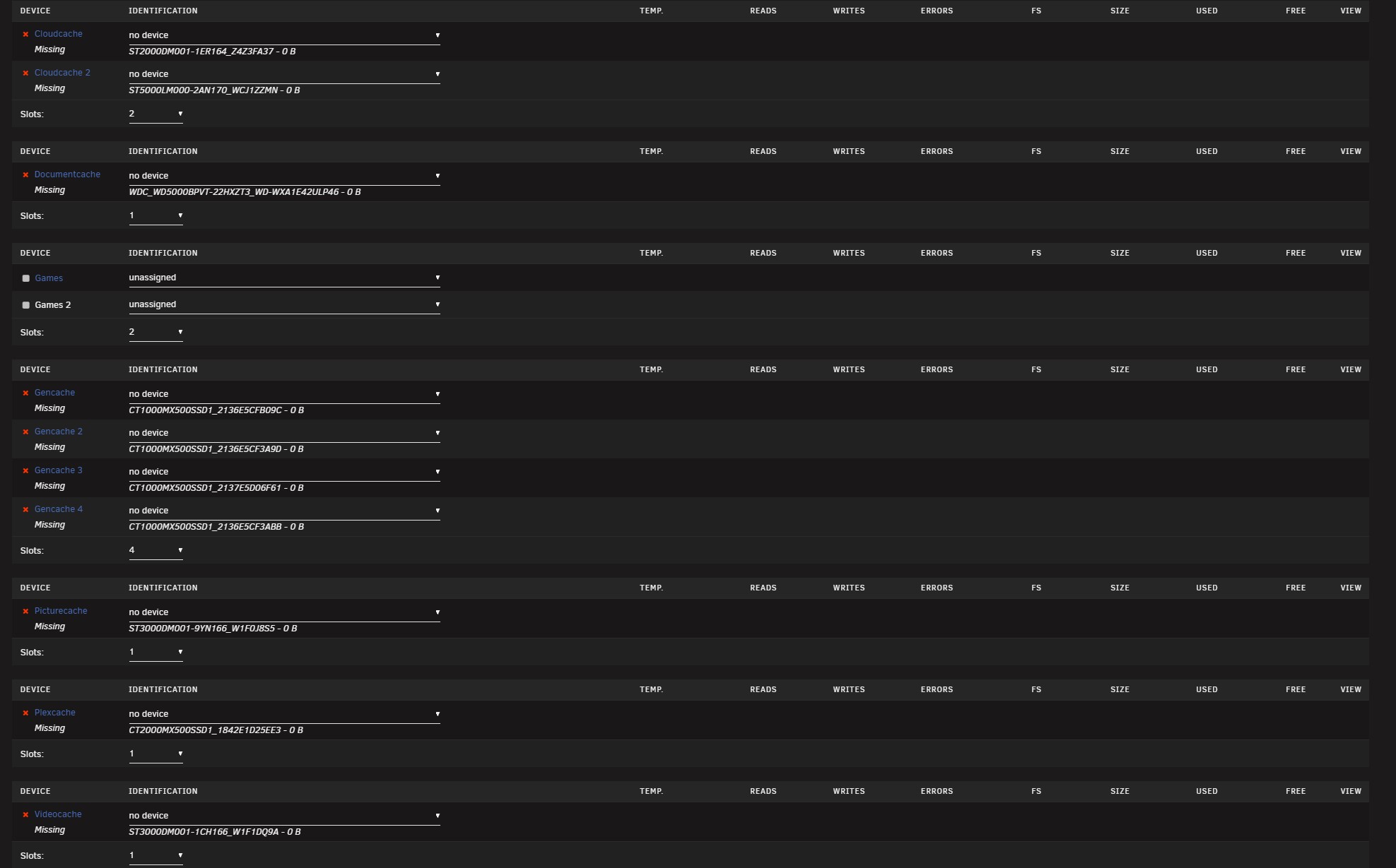

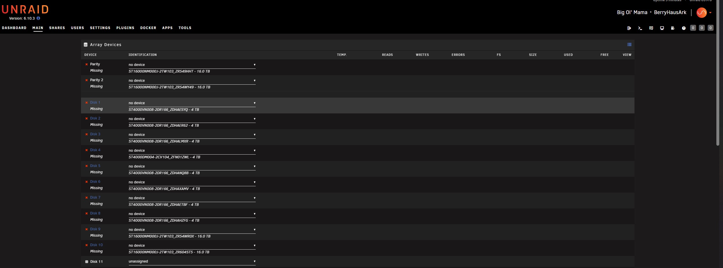

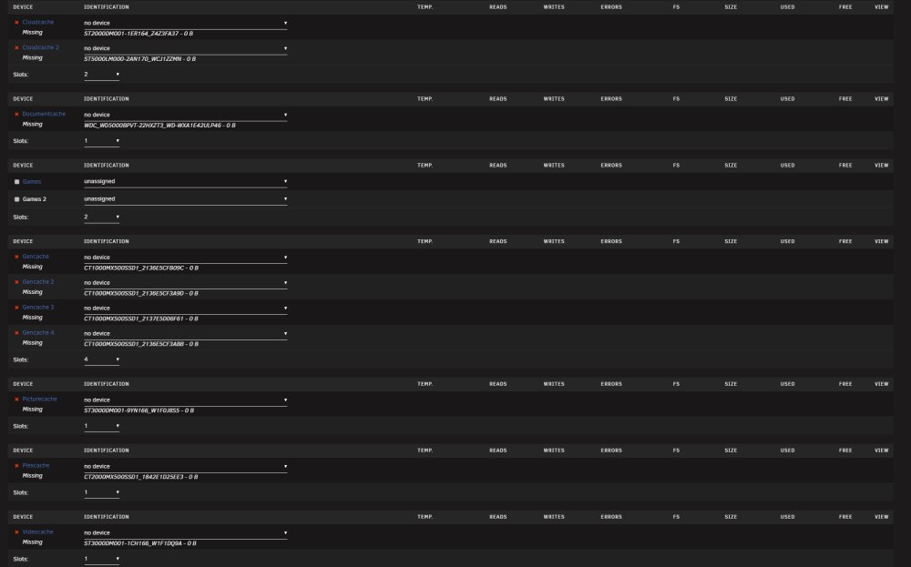

As the title says all of my drives are now missing after my UPS initiated shutdown (at least I hope that's what happened because I was out of the house when the power went down).
I'm attaching my diagnostic zip for review along with two screen shots of the array tab and my missing devices.

Also, in the vars.txt file it shows each disk with the DISK_NP_MISSING status.
I have tried multiple reboots, re-seating my HBA card/connectors, pulling out all drives and re-seating them, and even praying but sadly nothing has worked. Any advice/help would be amazing! Thank you in advance!

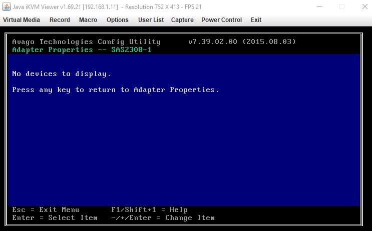

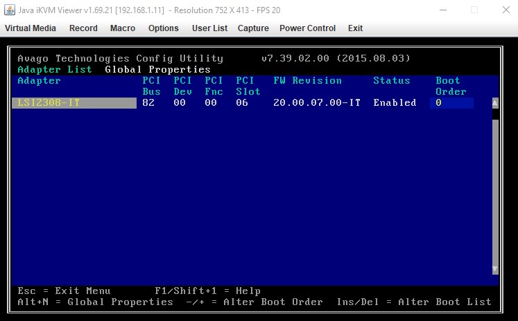

EDIT: I have also verified that my HBA card (LSI2308-IT) is being seen and is enabled (see attached screenshot). But digging into the card, specifically into the SAS Topology it does not show any devices attached to it. I'm not sure if this is correct but this may be the smoking gun.

There are no drives on the onboard SATA and the LSI is also not detecting anything, check to see if the drives are spinning up and if they are being detected in the board/LSI BIOS, if they are not detected there they also won't be detected by Unraid.
The drives are not spinning and nothing shows up in the bios (although I may be looking in the wrong spot). The drive indication light does turn on/off if I pull a drive and put it back in. Although that is probably un-related and just a feature of the backplane.
