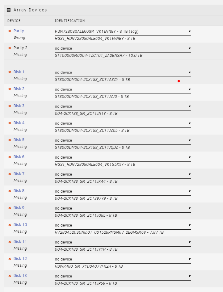

Formatted my usb key, copied over 6.11.1 files, copied the .key, super.dat and pools folder from backup to config folder of the USB key. Booted up and my array drives are showing as missing, even if I repopulate in the order listed, I still cannot start the array as it says too many drives are missing.
Did I miss a cfg file? Or can I do tools > new config and repopulate the drives as originally listed? Would there be any data loss?
Devices names changed, this can happen with some controllers and/or using an old firmware, do a new config, assign all devices to their original slots and check "parity is already valid" before array start.
