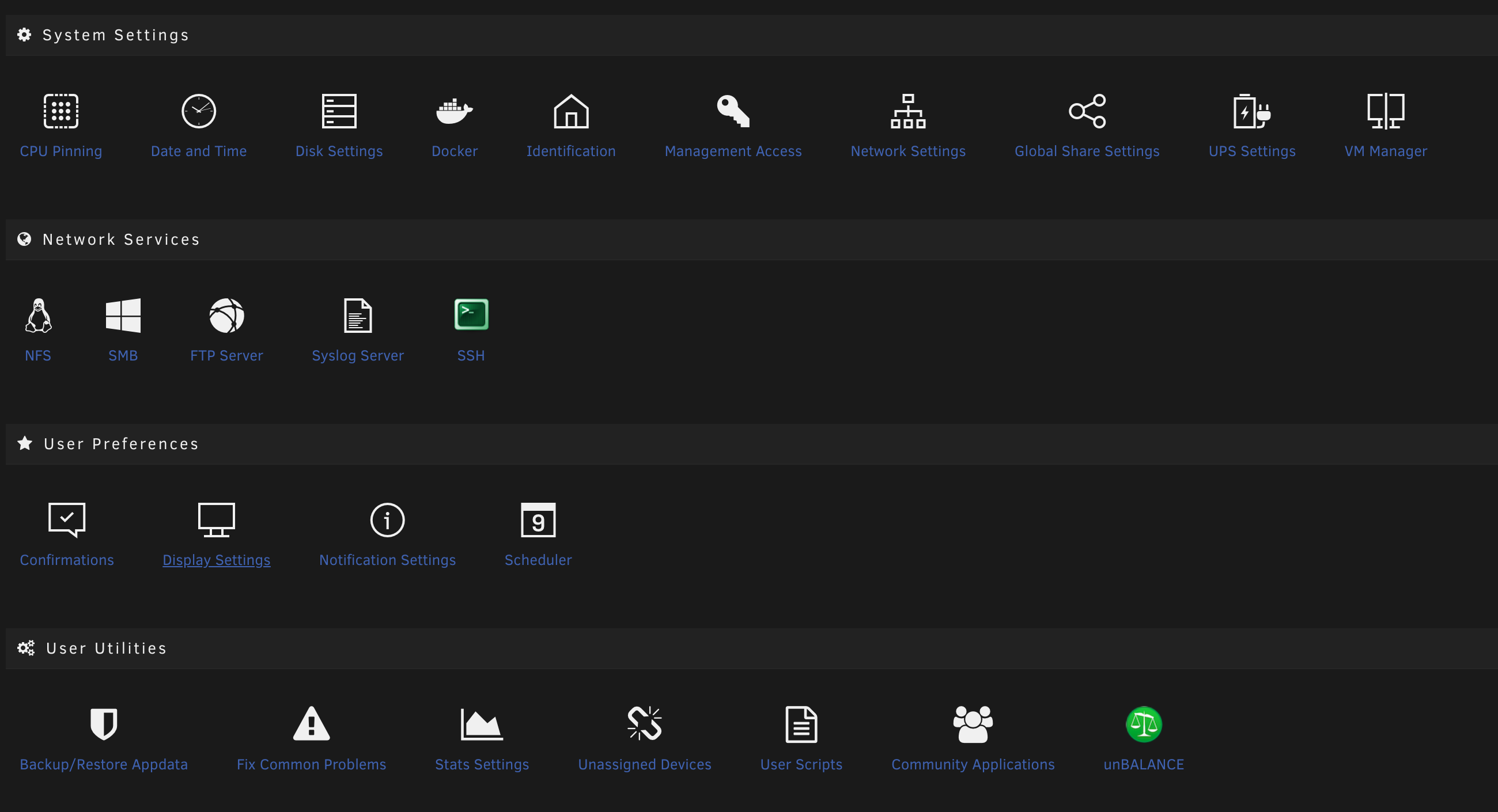

I don't have that?...
Upgrade your OS.  Dynamix Wireguard has ceased development since it was incorporated long ago
Ah ok. I was a new user 6 months ago and it didn't have it then I guess. Haven't upgraded as I heard some had things stop working (not complaining, very common!). Going away next week so don't want to break stuff now ;)
I've installed the Dynamix one and it's working. I guess the thing to do when I get back is remove it and upgrade unraid...
