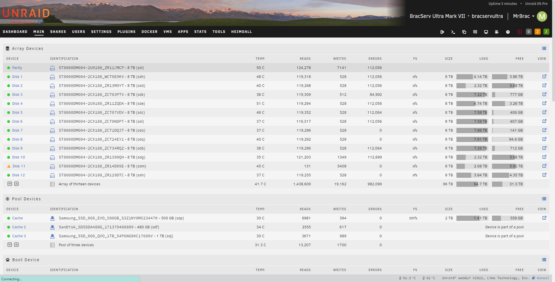

Right now doing rebuild on disk 11 with bad sectors. But disk 10 has crc issues and now i Can tell its i/o error and now it needs to have its XFS fs cleaned again

Still read errors on disk10, rebuild will skip ahead on errors, hence the speed.

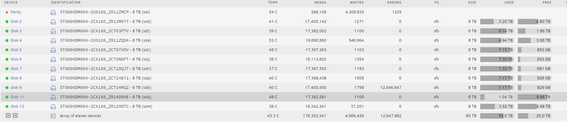

Now it says my parity is X
Says disk 9 has errors but I ran xfs repair and nothing
I cant sleep with this crap , so I redid parity in maintenance its now doing a parity sync.
Before it was trying to do a check but I removed 2 disks so that would cause confusion right?
so the parity is totally invalid and has be redone. + the disk is brand new I can not believe I have this many disks with issues.
I keep running xfs repair on  so called issue disks and it has no problems.
