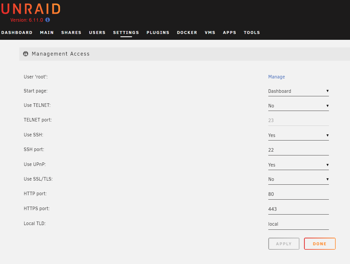

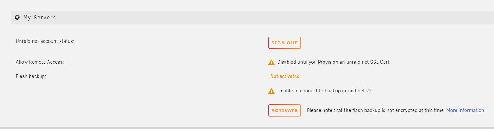

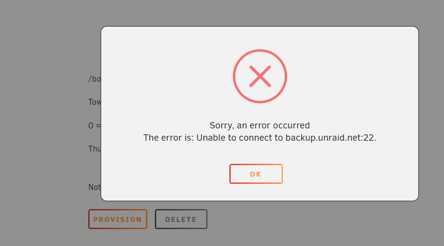

October 15, 20224 yr ATT, unraid 6.11, it has always been shown that port 22 cannot connect to the server, and I cannot enable this service regardless of whether I set port 22 forwarding on the router.

October 17, 20224 yr On 10/14/2022 at 10:17 PM, Sam666 said: ATT, unraid 6.11, it has always been shown that port 22 cannot connect to the server, and I cannot enable this service regardless of whether I set port 22 forwarding on the router. Please disable any port forward for port 22, you do not want to open port 22 on your server up to the Internet However, flash backup does need to be able to make an OUTGOING connection on port 22 to backup.unraid.net. Do you have a firewall that could be preventing that?
