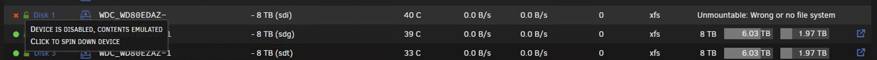

I've got a disk marked as "Unmountable: Wrong or no file system". I have two parity disks in my array, the GUI seems to suggest that the disk is being emulated, however the data on the disk is missing:
1645993771_Screenshot2022-10-16at15_21_50.thumb.png.f034ce1b32a89adbaf239291d1e701d6.png

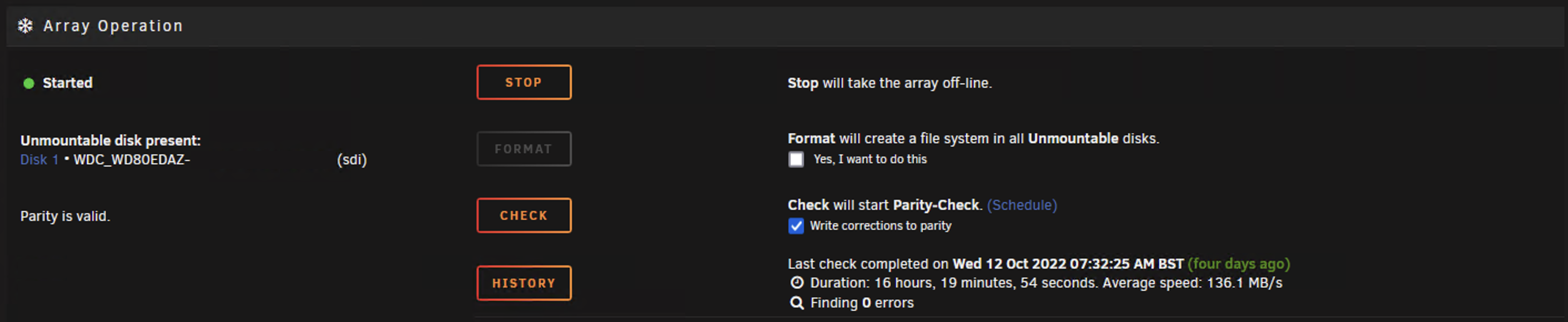

I have the option to format the disk, but don't want to do that as the data isn't being recreated from parity, so think doing this would loose the data:
1146240094_Screenshot2022-10-16at15_28_15.thumb.png.24971b146194ed6f0ddfb7fc856377da.png
Is there anything I can do? I've tried a reboot and same issue.

17 hours ago, Squid said:
Run the file system checks against disk 1  https://wiki.unraid.net/Check_Disk_Filesystems
Thanks, its an encrypted volume so had to go via the GUI, followed a helpful guide from Spaceinvader One.

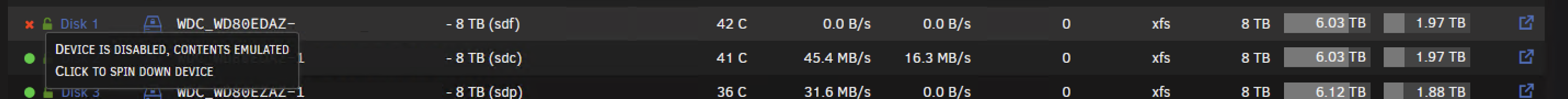

Ran the XFS recovery (had to use -L flag) and rebooted th eserver. I'm still getting the disk error (see screen shot below), but now the disks being emulated and can access the data. Just to add, there arent any SMART errors on the disk, so don't think thats the issue.
763285106_Screenshot2022-10-17at11_45_57.thumb.png.9d941a38373a515b4ef30735dbc6a290.png
Do you know what the process would be to fix from here? Remove the disk from the aray, format and rebuild from parity?

yes, because a write to the drive failed, so the OS automatically disabled the drive.  To re-enable you must rebuild the drive from the parity information
DO NOT FORMAT
Stop the array, unassign the drive 1
Start the array, stop the array
Reassign drive 1
Start the array and start the rebuild.
