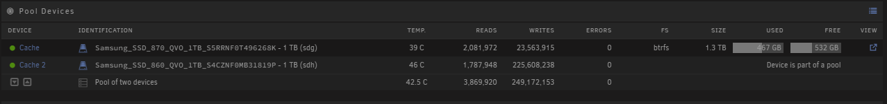

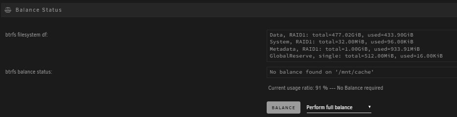

October 17, 20223 yr Hi, I changed one of my cache disks to new larger one. Now when I start array I can't stop it because it says disabled BTRFS operation is running. Syslog has thousands of rows unraid kernel: BTRFS info (device sdh1): found 1 extents, stage: update data pointers Cache balance show: Balance button does nothing. Pool also looks normal: I had waited about week now for that BTRFS operation to stop. I took diagnostic zip also and it's attached. What should I do to get my cache to back normal state? unraid-diagnostics-20221017-1449.zip
October 17, 20223 yr Community Expert Log is spammed with Nvidia related issues but looks like the btrfs balance is stuck, and there still a device missing, type in the console: btrfs dev del missing /mnt/cache and post the output
