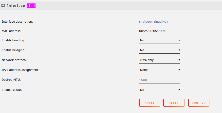

Remove the gateway from eth1, also eth0 should be you main NIC, does the 10GbE NIC have internet access?
Hi @Jorge
Yes - it does have internet access through eth0.
eth1 doesn't have anywhere to clear a gateway from?

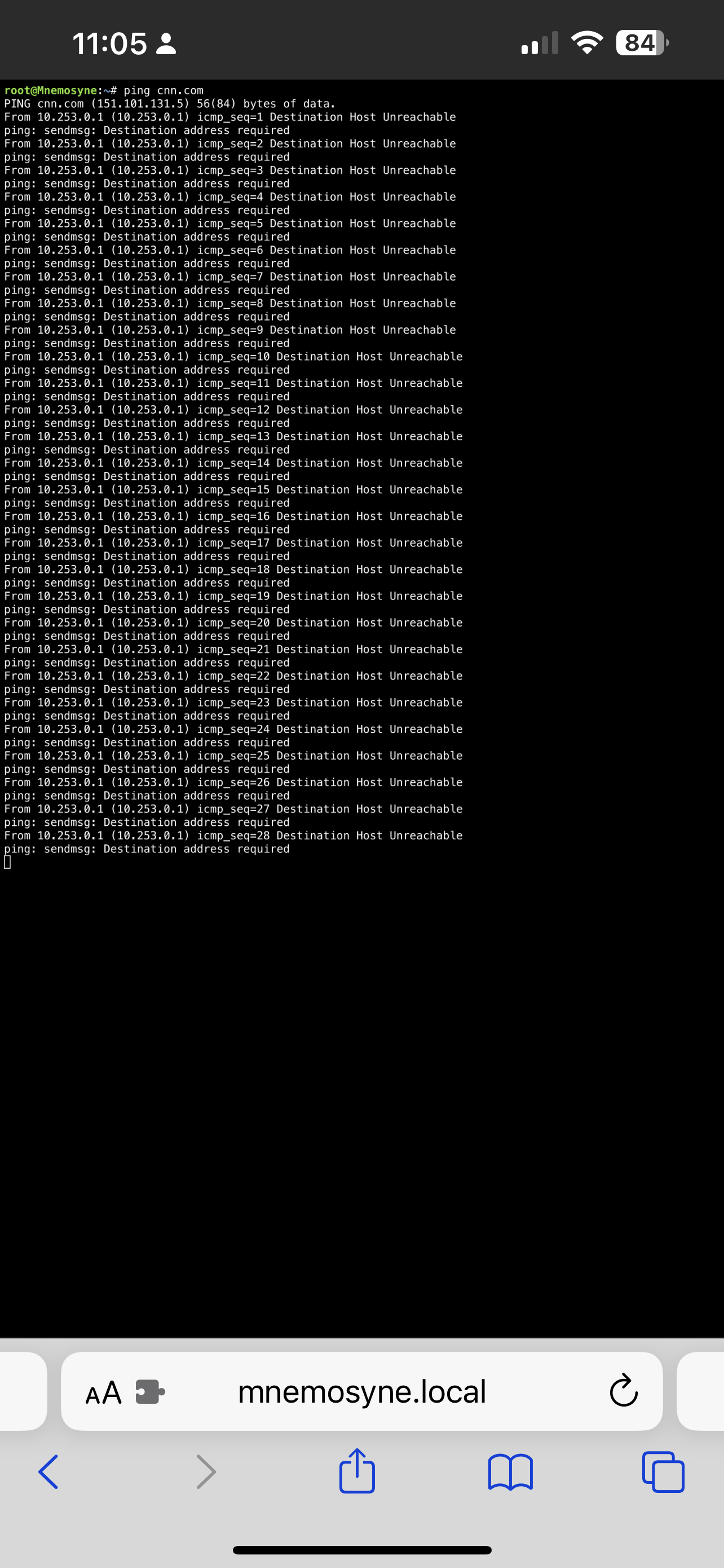

No luck there either.... This is pretty frustrating!
root@Mnemosyne:~# ping cnn.com
PING cnn.com (151.101.3.5) 56(84) bytes of data.
From 10.253.0.1 (10.253.0.1) icmp_seq=1 Destination Host Unreachable
ping: sendmsg: Destination address required
^CFrom 10.253.0.1 icmp_seq=2 Destination Host Unreachable
--- cnn.com ping statistics ---
2 packets transmitted, 0 received, +2 errors, 100% packet loss, time 5001ms
root@Mnemosyne:~#
mnemosyne-diagnostics-20221017-1150.zip
Nothing wrong the I can see, are you sure the router is correctly configured? Make sure the connection is a simple as it can be to start, no firewall, etc, just the server connected directly to the router.
