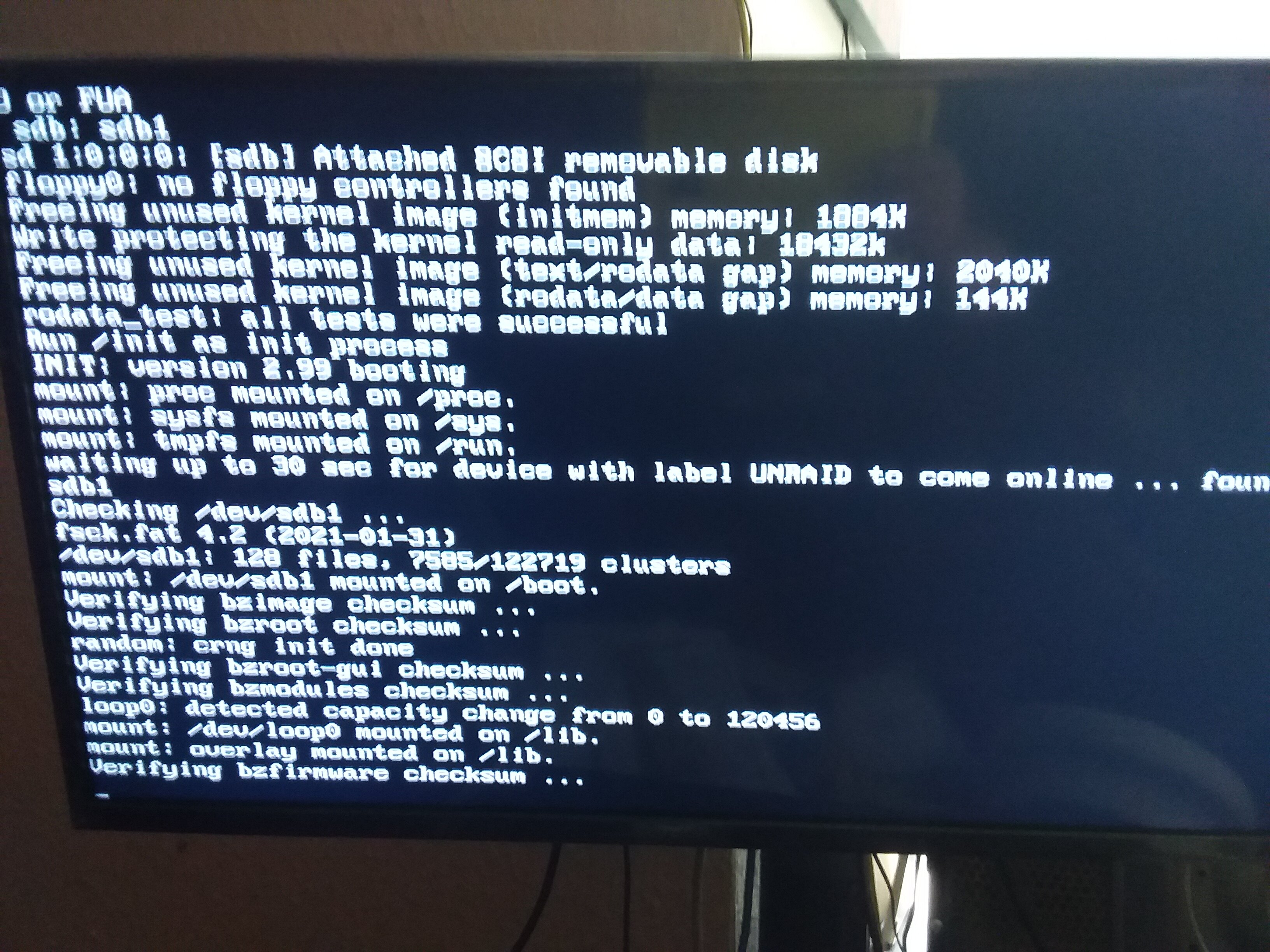

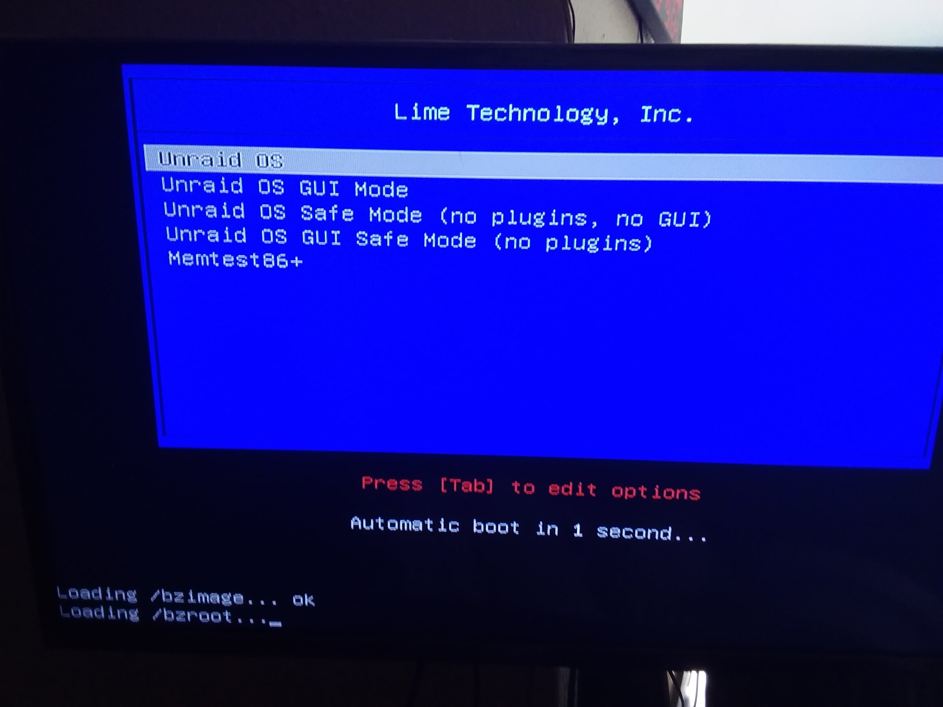

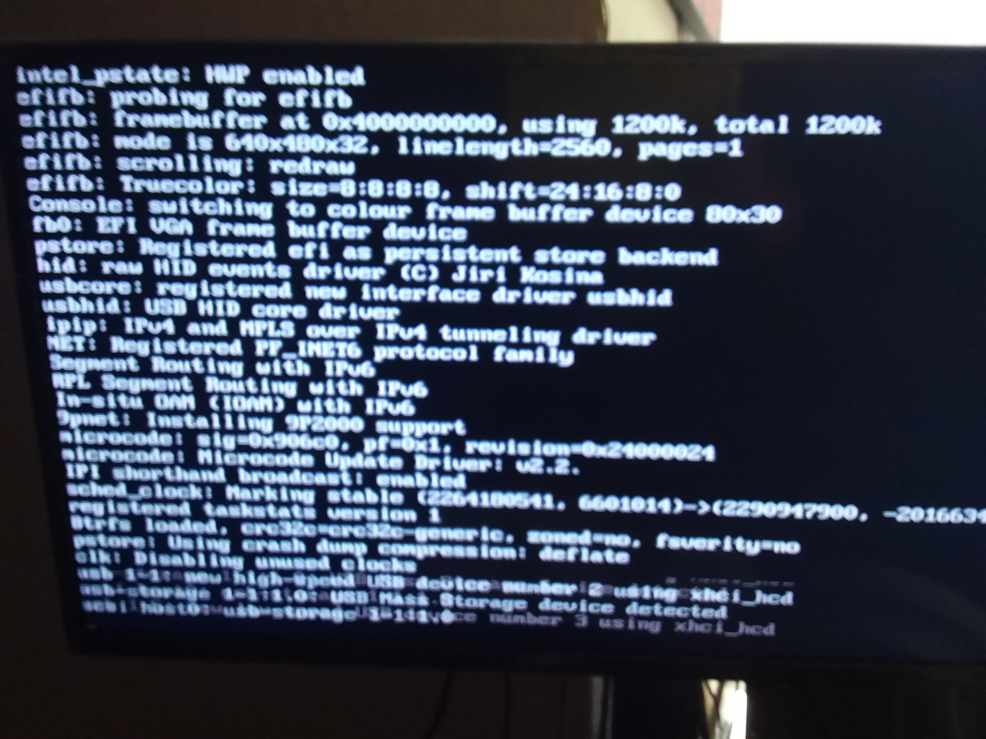

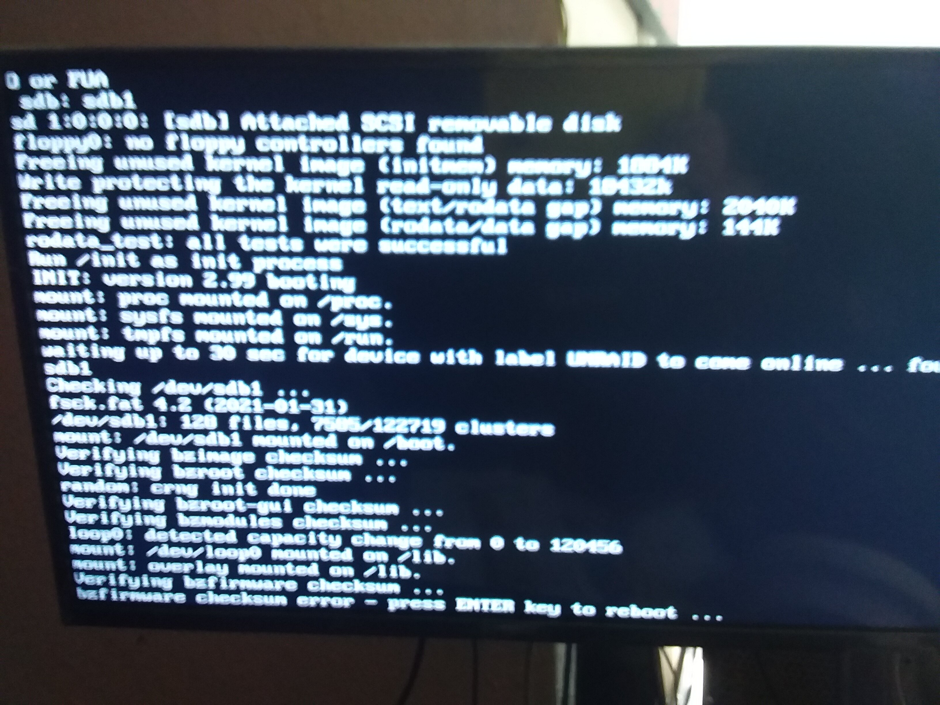

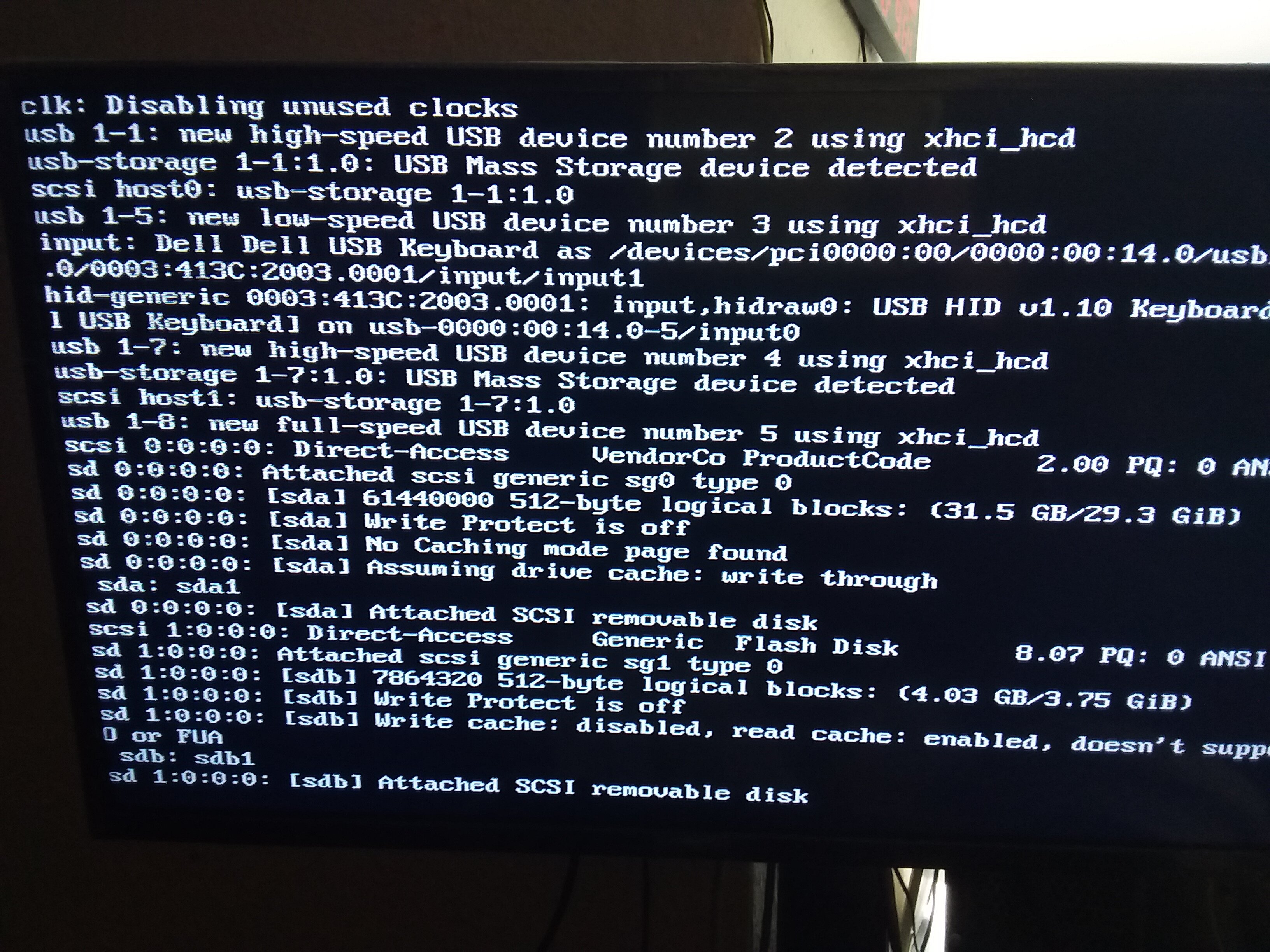

On 8/20/2024 at 12:50 PM, Cloggy said:
Memtest is okay, still checksum error, I will upload screen shot tomorrow.
Meanwhile, 3 weeks later....
Followed this - https://unraid.net/getting-started
then this - https://docs.unraid.net/unraid-os/getting-started/advanced-bios-config/
found a zip file somewhere along the way and put the bz files onto the USB
Still no joy with the checksum, I am hoping you can tell from the screens, I really am a complete newbie to all this!
Try a different flash drive using a stock install, if the same thing happens run memtest.
I have done all this, its still the same. I have used 4 different USB sticks. I just cannot see what I am doing wrong?
4 hours ago, JorgeB said:
I have!! It passes every time!
Try the same flash drive in another PC, that will confirm where the problem is.
Okay, done that, still no difference.
If the flash drive has the same problem in a different PC it suggests it's not correctly created, try a different one.
