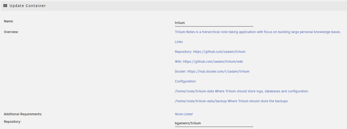

The reason for the outdated version is the changed repository (as far as I understand). Here an example with the Trilium docker:

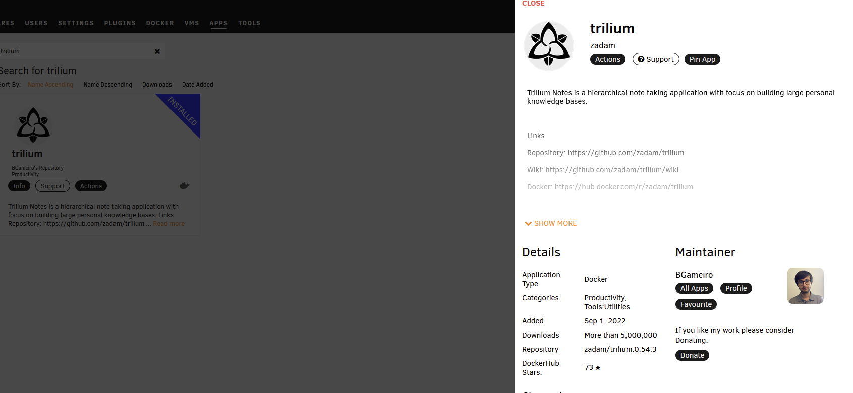

This is the setup which I have on my "main" server. As you can see the repository is bgameiro/trilium. But when I installed trilium on my new server, the apperance changed, as it was a much higher version. The repository in this case is zadam/trilium:
In both cases it was referring to the same application inside "Apps" (you can see it based on downloads), but the changed repository is excluding my docker from updates (as the old one is depricated and I didn't see / understand that). The same happens also to other application as for example lidarr.
