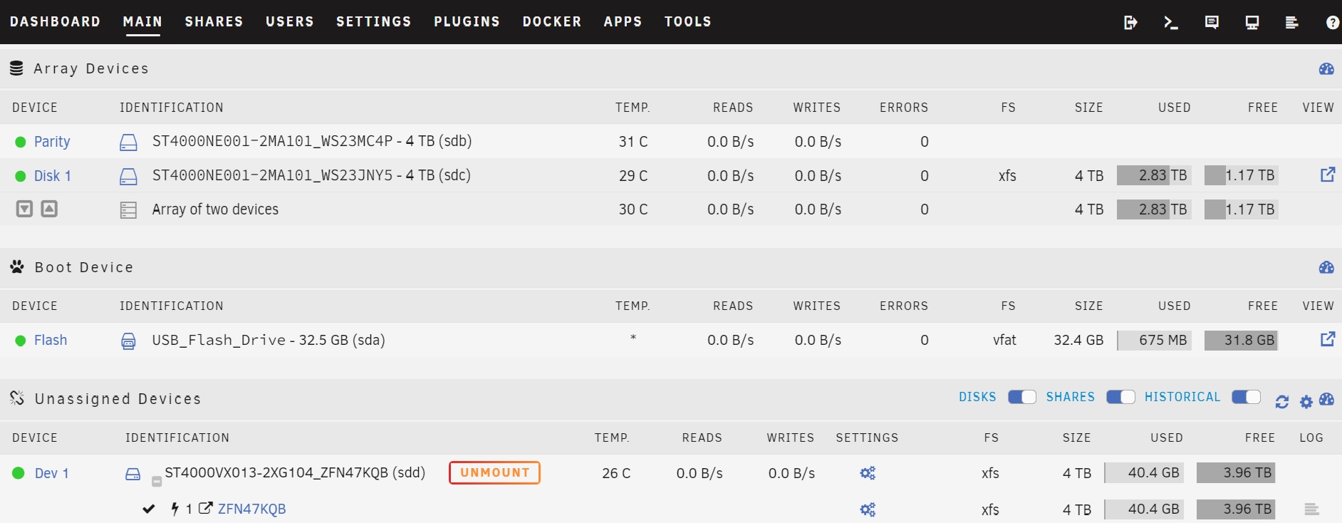

There is no cache unless you created a pool with drives...
What does your main tab look like? Post a screenshot
Screenshot
