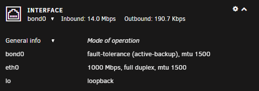

The issue is that transfer speeds using Windows click and drag from my main PC are horrendously slow. In the attached picture you can see eth0 reports a gigabit connection, but I currently have a movie transferring, with Windows reporting 2mbytes/sec and that being reflected in Inbound: 14.0 Mbps.

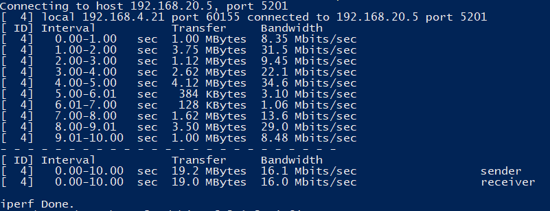

This is the iperf3 results from my machine (after the transfer was completed):

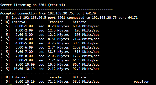

I do have a second machine that gets roughly 14mbytes/sec transfer speeds using Windows click and drag (still not the reported gigabit) but a lot better. Here are the iperf3 results:
Both PC's are connected via WiFi via an Eero due to apartment living limitations, the device should have at least a 500mbits/s link.
This shows the network is the problem, iperf only tests network bandwidth, results are not device/share related.
It sounds like it's time for a new modem/router?
First of all you should ask yourself why both machines are not within the same LAN (subnet) and WHO is transfering packets between both LANs.
I have strong doubts that this is a single router, maybe your packets are forwarded to mars and return through a different gateway?
Check your routing, you may get a surprise.
The routing is as such:
Unraid Server ---(via Ethernet)---> NF18Mesh <---(via Ethernet)--- eero mesh <---(via Wireless)--- eero mesh as extender <---(via Wireless)--- PC
So my suspicion after confirmation by you guys is that it's definitely something in the chain causing the issue.
And after I typed the above I thought to check the network speed and lo and behold:
Limited by wireless signal strength. Don't trust the network speed reported on the box for wireless because signal strength will mess with it.
The 2kbyte/sec transfer speed sorted itself out after disconnecting the network drive and reconnecting, so we'll chalk that one up to Windows being the best operating system of all time. /s
Network issue. I'm stupid. Thanks everyone.
