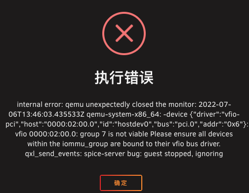

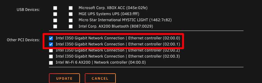

Updated 6.11.1 and my virtual machine is not working properly!
我的ikuai系统不能直接上网口!
image.png.a57f83ce48e59a6956d5771b9703f91b.pngimage.png.26e808e908b995b3e9afe95eca8607e0.png
As long as you cancel the direct connection to these two network ports, it will work normally again!

Iommu group 7 includes also an nvme drive, try to use pcie acs override "both" instead of only "downstream", to see if you can spit the ethernet card from the nvme drive.
You should bind to vfio at boot the devices you want to passthrough.
Edited by ghost82
8 hours ago, ghost82 said:
Iommu 组 7 还包括一个 nvme 驱动器,尝试使用 pcie acs 覆盖 "both" 而不是仅 "downstream" ,看看你是否可以从 nvme 驱动器中吐出以太网卡。
您应该在引导您想要通过的设备时绑定到 vfio。
Hello, my setup is already downstream. But it still doesn't work, I installed the patch provided by a big guy in the forum and successfully grouped it! But still thank you for your help!
