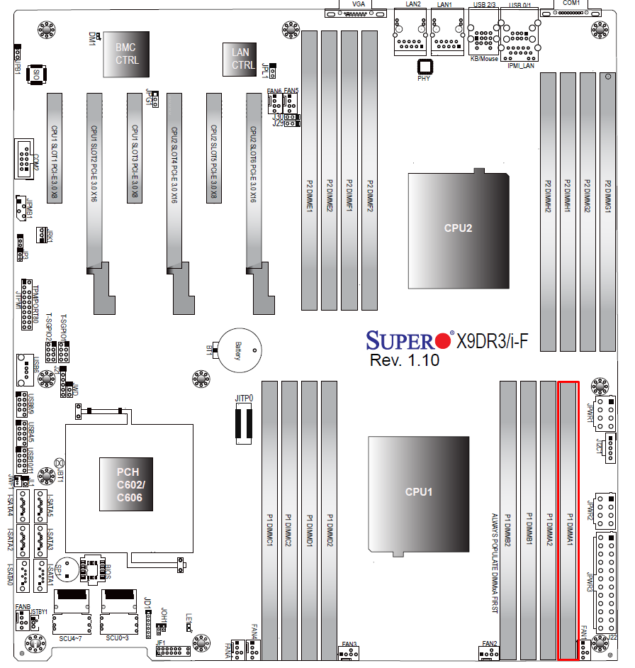

Now, the weird thing is: Even after I took out the RAM module, which I made out to be at CPU 0 BANK 7, the server kept crashing. Without showing anything in mcelog.
And it gets even weirder: I played around with a lot of different RAM modules. And placing them in different slots sometimes resulted in the server not being able to boot up at all. So usually I get 2 or 3 beeps but in these scenarios, the server just hung with powered up fans, no beeps at all.
If I place RAM in the slot P1 DIMMA1 (red in the image below), which should be the first slot to place RAM according to the motherboard manual, the server won't start at all. Same goes with other slots from CPU 2 (top row).
Yesterday, I ran a Memtest for 3 passes and didn't get any error. But I read somewhere that Memtest can't detect any memory errors with ECC RAM. Is that correct?
So either I'm having a bunch of broken RAM (I literally have a stack of about 20 which I got off an "old" server and non of them seem to work any better) or maybe my motherboard or CPU is broken or causing problems with newer versions of Unraid? Or do you have any other ideas?
Thanks for reading and taking some time to brainstorm with me :)
That suggests a hardware issue, how many DIMMs do you have total? If you install just two DIMMs per CPU, using the first 2 slots, does it post?
Hey, thanks for the reply!
Recently, I was using 3 DIMMs only (2x CPU 1 and 1x CPU 2) in more or less random slots. But as I wrote before, this setup is very unstable. I have 13 other unused DIMMs of the same type. I never used all of them, because I didn't bother to demount the fans, which are blocking 3 of the slots (I also don't know if these 3 slots are working).
According to the motherboard manual, the preferable slots for 4 DIMMs (2 per CPU) would be P1-A1, P1-B1, P2-E1 & P2-F1. So I'm assuming these should be the "first 2 slots" for each CPU. Result: No success (no booting/no beeps).
So I tried some other constellations:
  • P1-A1, P1-A2, P2-E1, P2-E2: No.
  • P1-A1, P1-B1: No.
  • P1-A1: No (here I used different DIMMs)
  • P2-E1: Yes.
  • P2-E1, P2-E2: Yes.
  • P2-E1, P2-E2, P2-G1, P2-G2: Yes.
Could it just be CPU 1 that's failing, you might wonder? Unfortunately not, because:
  • P2-E1, P2-F1: No.
  • P2-E1, P2-F1, P2-H1, P2-G1: No.
Both P2-F1 and P2-H1 seem to be broken as well.
Sorry if this is so cryptic. I could also take some time and label the broken slots in the picture above if that would help.
In summary, random (I think) DIMM slots are preventing the server from booting, or in other words: appear as broken.
Could a power outage have caused this? I know I had some in the past.
But why, then, did the updates destabilize it so much? Pure coincidence?
I hope I'm not causing any headaches, I know I'm starting to have one 😬
Edited by lamebot

Yesterday, I had another very strange problem: The server fans howled very loud every few minutes. I let it running during the day and returned to a running server in the evening, still doing it's howling. It was like a wounded animal begging me to put it out of its misery 😅
It crashed later that evening and the problem stopped today, after I removed two DIMMs and went back to 3x 4 GBs for both CPUs.
Can anyone help me narrow this problem down? Could it be a broken memory controller? How can I find out whether it's mainboard or CPU related?
Considering the error messages, I don't think it's a faulty PSU anymore (the server would probably crash more instantly, right?).
Thanks for reading and have a great weekend
Not easy to say for sure without swapping parts, but the memory controller is integrated in the CPU, so unless the are some bad traces in the board the problem will be the RAM or the CPU.
Hello,
What bios version you using? Do you check BMC EventLog?
This issue probably Memory Ecc Error , You have to use Memtest86 Pro to Inject Ecc Function, verify your memory all work perfect. (Not memtest86)
And Server Motherboard dont recommend install memory 3 6 9 this multiple.
Hi
I was using the latest BIOS and checked BMC Event Log sometime ago, no new errors.
However, I found out what the problem was: RAM. I couldn't believe it but it seems like most or all of my 16 DIMMs (some of which I didn't even use before) are broken or not compatibale with newer versions of Unraid. Maybe the problem was there all the time but it became way more visible because of system changes. Don't know if that makes sense.
After I installed differnt RAM, my system was running without problems. Well, almost no problems.
The problem with the fans spinning up like crazy came back but I was able to fix it with some IPMI changes, which I found in some other threads.
To be more specific, I had to lower the fan thresholds to 150/75/0 and changed the fan control to only use CPU2 temp and HDD temp, because at least two other sensors are doing weird things sometimes, like dropping to 0.
So both of you were right pointing out that it still might be RAM. Thanks for the help :)
