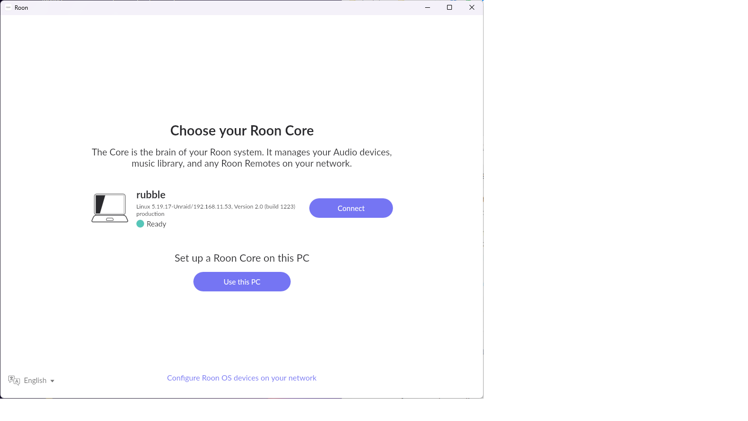

When you first run the Roon client, you are presented with a screen that says "Choose your Roon Core" where it will try and find a running Roon Core on the network, or you can "Set up a Roon Core on this PC"
If you've already selected the Set up a Roon Core on this PC, then you can get into the software and start listening to music: BUT that wasn't the right move. As you've set up your Roon Core on the network already, you need to backup the local installation process. Open your Roon Software, go to Settings, then logout. Close the software. Re-run the software and hopefully it'll find your Roon Core on the network.
After you hit Connect to core, you'll be presented with the username/password to get authenticated with Roon registration software. You've already started the free trial (I can see that from your screen shot up there).
So that was the missing piece. When you first log in. Got that now working. Have the ARC running now. Does the Roon Core populate my music automatically? Or do I need to do a command or something?

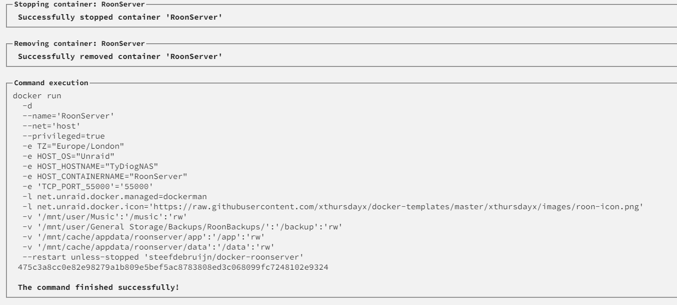

  • Can you nuke the Docker, delete appdata, and start over? you enter credentials via a Roon client after connecting to Roon core. If I recall. It will have to rebuild your server.
  • rutherford
    rutherford
    The idea behind Docker is that the software has everything it needs to run all inside its own walled garden. You specify a few little holes it has to see through in the docker config page on the unrai

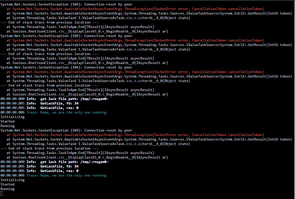

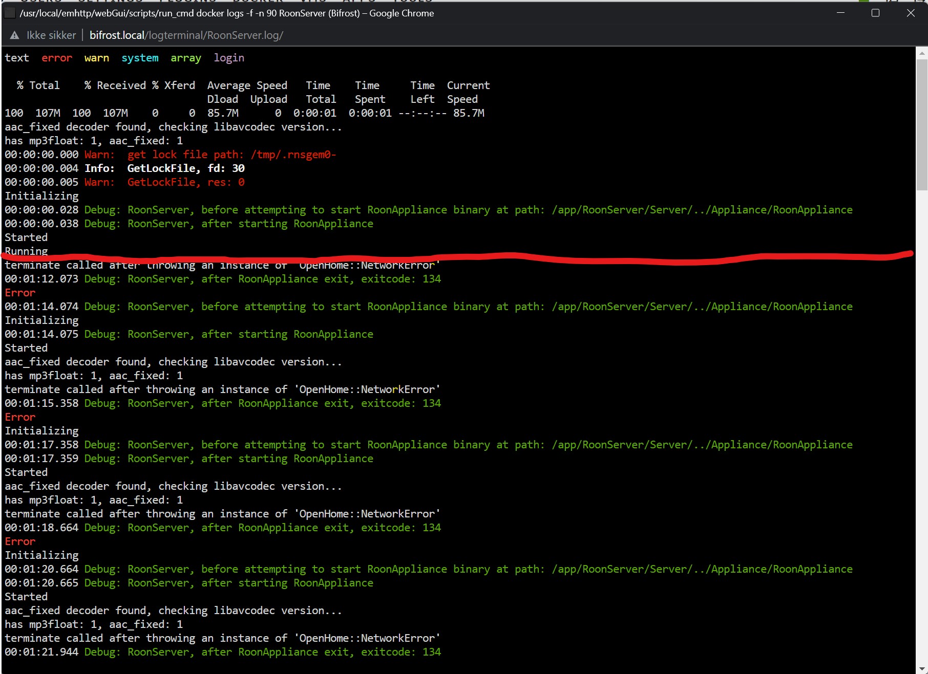

Hi guys. Having a huge problem here. I installed the docker as per the guide. Then followed up with connecting to the new server in the Roon software on my Windows laptop. It found it right away and asked for my login. I did that, and then nothing really happened. Roon just times out and report a network error.
Looking at the logs, something defenitely is wrong.
Looking above the red line, is after I installed the docker, but before I logged in in the Roon program. Below the red line is after I log in. As you see, it just start looping the same 10 or so lines again and again.
What the hell is wrong here?

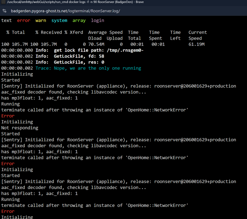

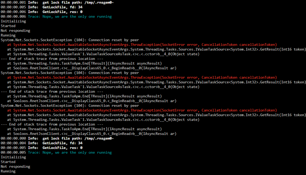

After roon told me there is an update, I installed it the internal way and until now I'm not able to login or see my roon core.
With started roon docker container I'm not able to see log. When stopped I'm able to see the docker log which says "permission denied". Tryed everything. Removing the old Docker, installed it completely new. Moving old appdata ...
What else informations do need?

27.12.2023 22:18:40
/run.sh: line 39: /app/RoonServer/start.sh: Permission denied
27.12.2023 22:19:40
27.12.2023 22:20:40
27.12.2023 22:21:40
This is my Log
Edit2:

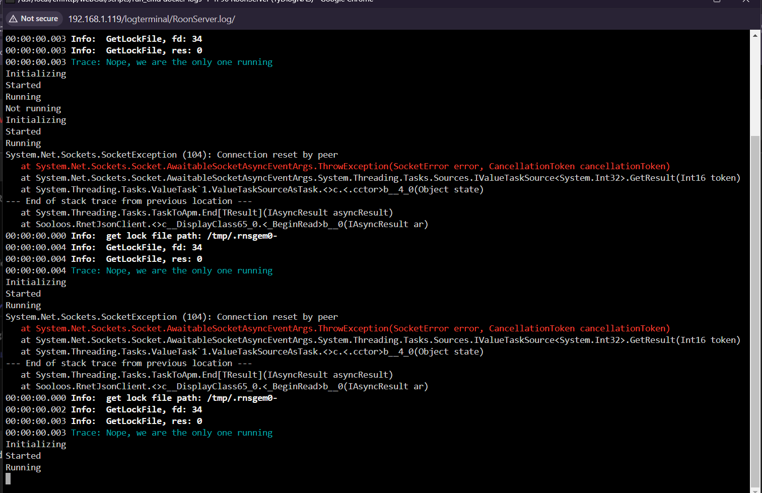

29.12.2023 17:42:05
00:00:00.000 Info:  get lock file path: /tmp/.rnsgem0-
29.12.2023 17:42:05
00:00:00.003 Info:  GetLockFile, fd: 34
29.12.2023 17:42:05
00:00:00.003 Info:  GetLockFile, res: 0
29.12.2023 17:42:05
00:00:00.003 Trace: Nope, we are the only one running
29.12.2023 17:42:05
Initializing
29.12.2023 17:42:05
Started
29.12.2023 17:42:06
aac_fixed decoder found, checking libavcodec version...
29.12.2023 17:42:06
has mp3float: 1, aac_fixed: 1
29.12.2023 17:42:10
Running
newest Log.
Still no connection to the Roon Core ...
Edited by dan4UR
After complete Reinstall
My core is up and running. Also connection from android client is up again.
Solution:
I had to completely remove the Docker container, and manually remove the "roonserver" folder in appdata. Then I did a complete reinstall with allocations within the docker template. After this I wasn't still able to discover the core neither the android client nor Windows 10 Client.
The solution was configure a new core. First was to restore from backup, restart the core and after that I logged in with my credentials and now everything ist up again and running.

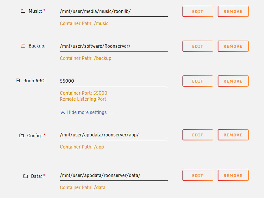

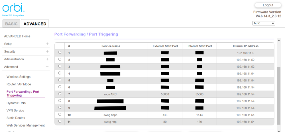

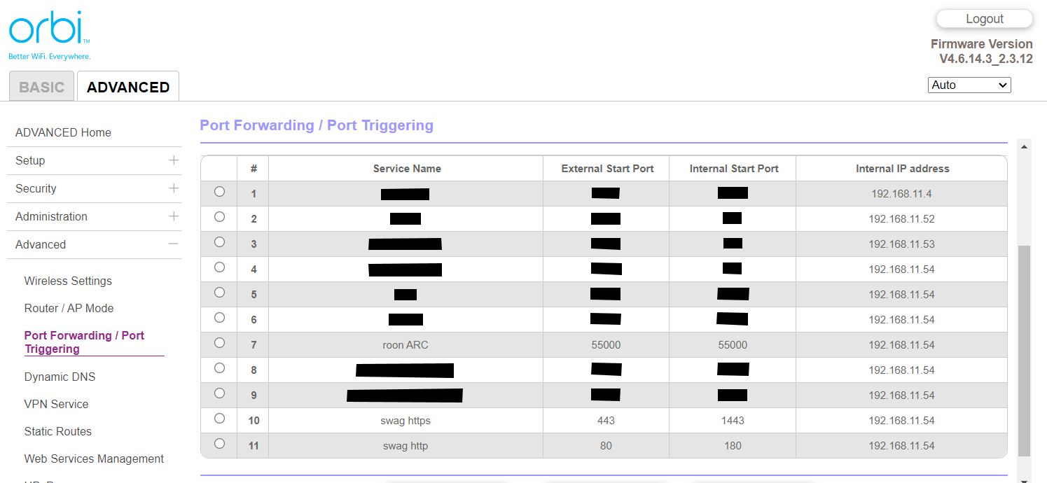

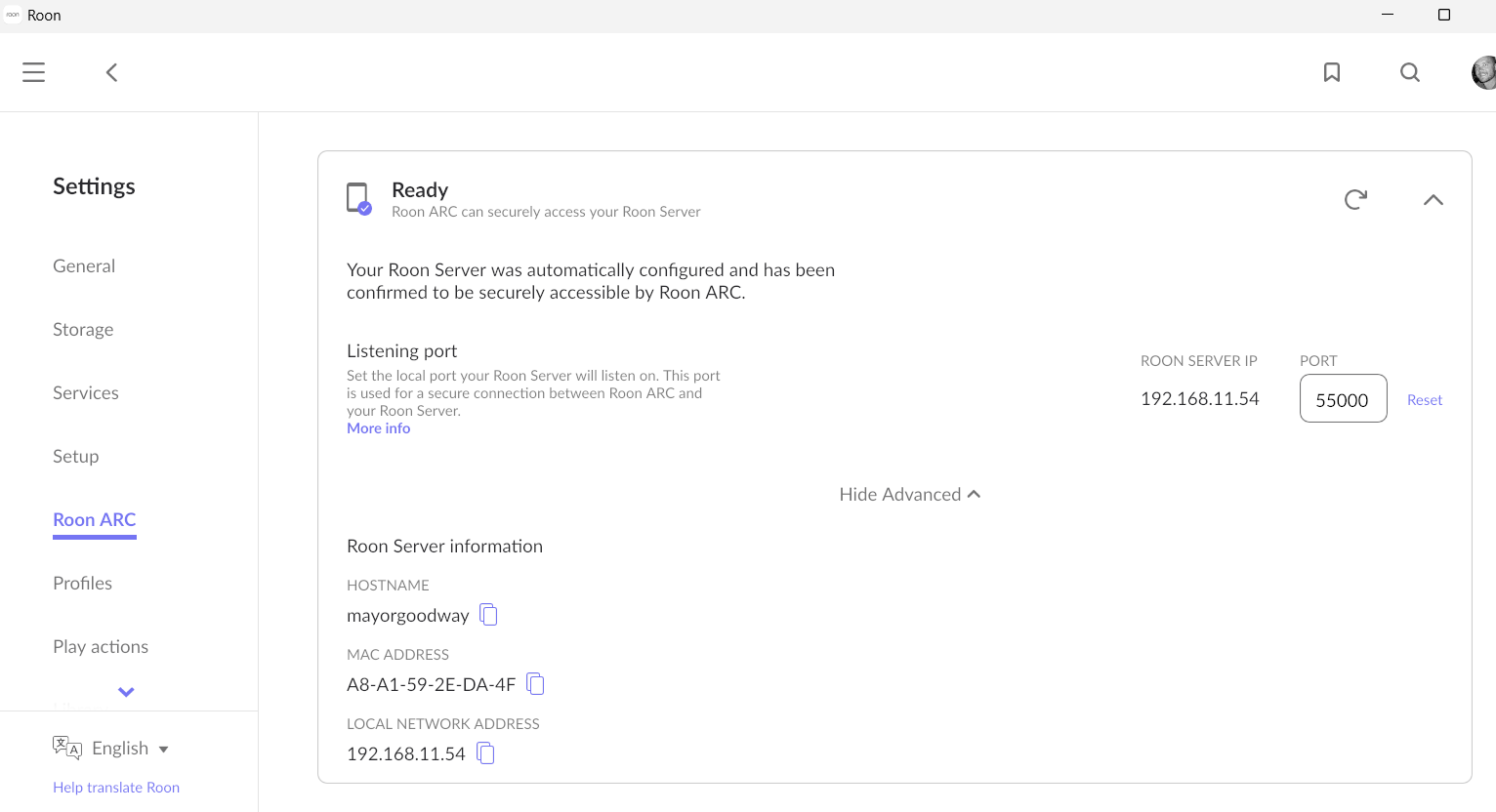

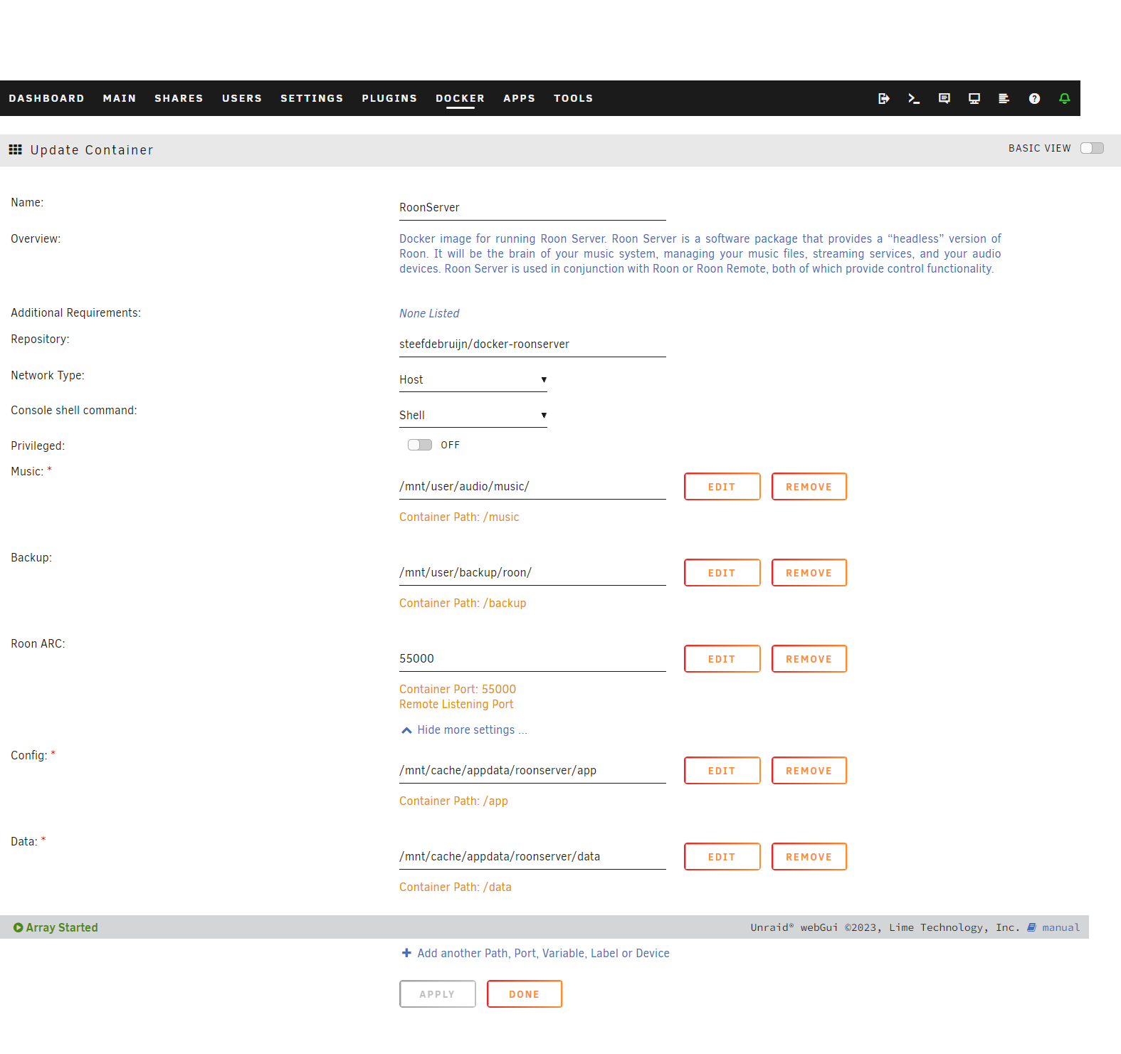

So Roon is up and running fine for me locally. But I can't get Roon ARC working. Prior to running this on unraid, I had a stand-alone NUC running it, and ARC worked fine there. I copied the firewall settings over to the IP address I assigned the docker container, and within Roon when I run the check it says everything is good to go. But ARC can't reach it. Compared to other docker apps, it doesn't show any port mappings. Is this expected behavior? I left the default 55000, and even tried manually adding 55555, but neither show up.

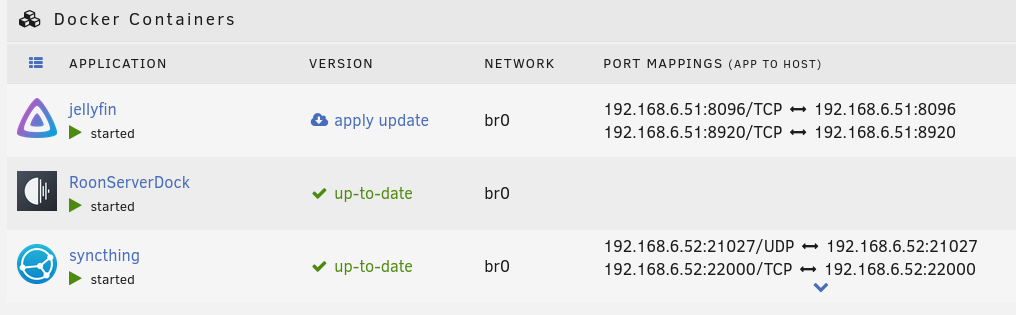

@fun.hat I think you're barking up the wrong tree there. Here's the line for Roonserver in my Docker tab
I'll slap some more pics down below...
Roon > Settings > ARC
pic with blue buttons is my Netger Orbi router WAN settings. You gotta make sure your WAN side of your router has an addressable external IP address. Another way you can check this, is visit whatismyip.com from any computer on your network. Then make sure you see that same IP address in the WAN setting in your router. That will make sure that you don't have a double nat situation roon forums.
Definitely breeze through some of this stuff, see if anything jumps out at you as applying to your situation
https://community.roonlabs.com/c/support/port-forwarding-resources/104
And finally the port forwarding services that I have is the one with all the redactions. My server ip is 192.168.11.54
oh, and the docker settings, with More Settings (?) expanded at the bottom.
Something else you wanna watch out for is cgnat: carrier grade NAT, that means the IP address you've been given IS NOT accessible from the www. Check out lists of ISPs to see if you are in that situation. Might be that a static IP from your ISP would sort that out. Or some tailscale network wide VPN would also sort that out.
Edited by rutherford
Yeah, I am aware of that stuff from my NUC. I got it working. Only thing I can figure that changed it is I had to set the NAT port forward rule to apply to UDP/TCP. I had it as just TCP when Roon was on my NUC and it worked fine. Not sure why it's any different in the docker container, but all seems well now.

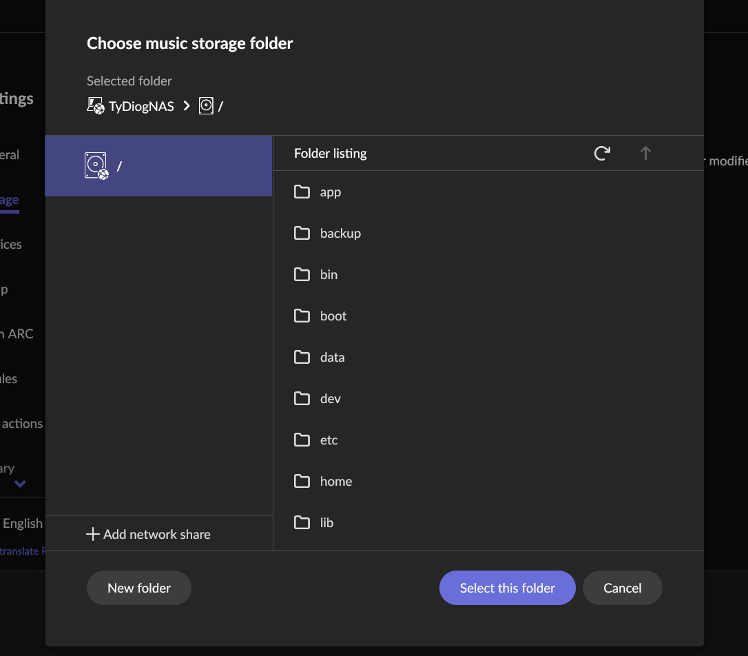

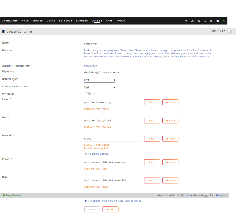

Hi - hoping someone can help me out as I'm clueless really to unraid.
I've been using Roon from my laptop with music on few large USB drives.
Followed migration advice from Roon - I've got my music files all on the server, got the RoonServer docker installed and mapped and running.
Logged out of Roon software then logged in via my latest Roon backup, after following Roon's instruction to 'forget' all my old USB drive shares, so I retain all my playlists etc.
Able to connect to RS on my server no problem but cannot then add the music folder on the server. When I click on 'add folder' under Roon's storage all I can access is the RS docker install on the server.
Under RoonServer logs it says
But I have no idea what that means.
I can access my media shares via SMB on laptop and other devices fine.
Tried reading various threads but have not find a solution.
Any advice/tips would be great.
TIA
Post docker run
The idea behind Docker is that the software has everything it needs to run all inside its own walled garden. You specify a few little holes it has to see through in the docker config page on the unraid template. Port 55000 is open to it. You have your unraid path /mnt/user/Music mapped over to /music
and a few other paths mapped.
Roon, inside its little garden, thinks it has a /music folder, and has read write access to that folder. In fact, that /music folder is mapped to an external to the garden folder at /mmt/user/Music
So scroll down a bit to the part where the folder /music resides and see if all your music files are in there.
When we put a slash as the first thing, it means root directory. When we don’t specify a slash first, is a relative directory.
let’s say my Documents folder is in my username folder. I’d type that like Documents/
if my documents was on my “C:” directly, I’d type /Documents
I'm assuming you’re a windows user and have some experience with Windows Explorer.
Thanks for the explanation and help rutherford.
All populating now by the looks of it.
Cheers again.

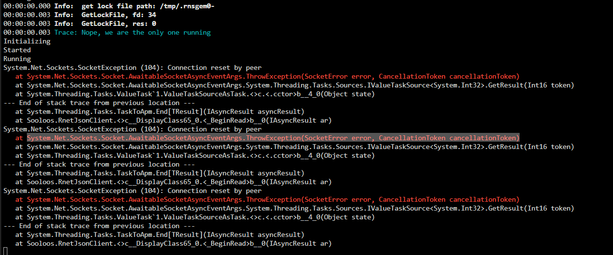

So I've seen this error posted a lot before but it always seems somewhat unrelated to the issue the user is having
image.thumb.png.8f00d62eb2234eada7dc98b61b0c1c46.pngM
My Issue is that after using Roon for a while and then taking a break it just wont find the roon server again and I have to restart the container.
I've tried to reinstall the container and remove all the config files but that did not help.
It was working fine for months and the only thing I have changed is some network equipment.
