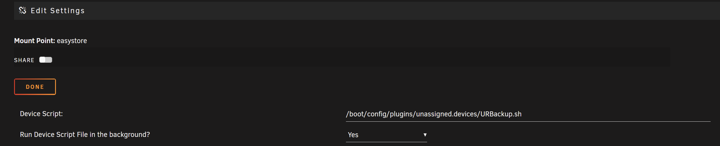

I have and external 14TB USB drive as an unassigned device and use this script (modified for the four shares I wish to backup) to back them up automatically when the external USB drive is plugged into the server.
Since you can assign a device script to be run when the device is mounted, this makes it real easy.
