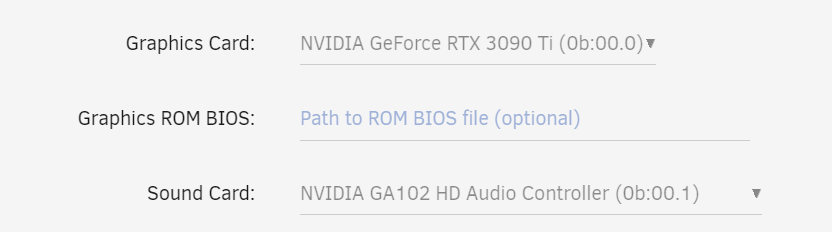

October 20, 20224 yr Hello, I'm trying to setup a passthrough to my RTX 3090 TI with my Windows 11 VM to do some cloud gaming. There is no screen connected to the card, just a dummy HDMI plug. My unraid system has 2 cards : RTX 3090 Ti for VM Gaming Quadro P620 for Unraid, Plex, dockers, ... The Windows 11 VM is not new, it was working perfectly with VNC and RDP has been allowed. I have a NVME SSD and a network card already configured in passthrough to the VM. Here's what I'v done as of now : Bind to VFIO the card : Because I had a warning message in the KVM logs, I modified my syslinux.cfg with video=efifb:off (no warning anymore) The VM has been configured with the graphic card : I added the multifunction='on' to the XML template. I tried to modify the VM type from Q35-6.2 to Q35-7.1 The VM starts but does not go online, I cannot reach it through RDP, it seems the network stack does not even go up as I can't ping it. I have attached my diagnostic file and the XML of my VM. dune-diagnostics-20221020-1412.zip VM_Template.xml Edited October 20, 20224 yr by hot22shot

October 20, 20224 yr Author Not sure I have the same issue as I can go back and forth from VNC to the 3090 (even though I have a black screen) without the message you have. I'll try to plug a monitor on the 3090 to see if something is shown at boot. Edit : I tried to plug a monitor on the HDMI connector of the GPU, without any luck. Nothing is displayed and the monitor just goes in save mode because it does not receive any signal. I also tried to create a recreate the VM and point it to my old vdisk, same result. With some dumb luck I have successfully dumped the vbios of my card with @SpaceInvaderOne script, but even with that it does not work. RTX3090TIFE.rom Edited October 20, 20224 yr by hot22shot
