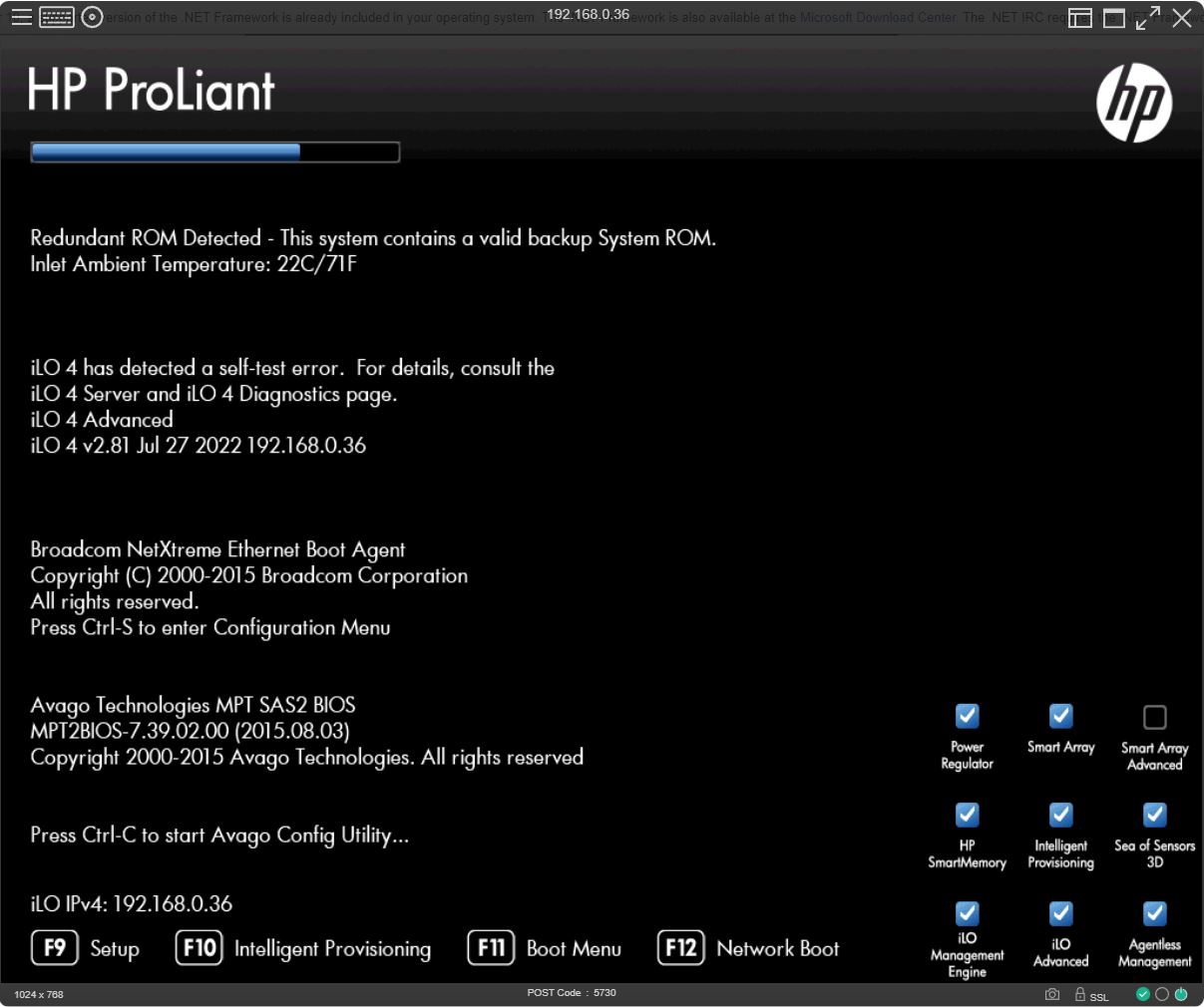

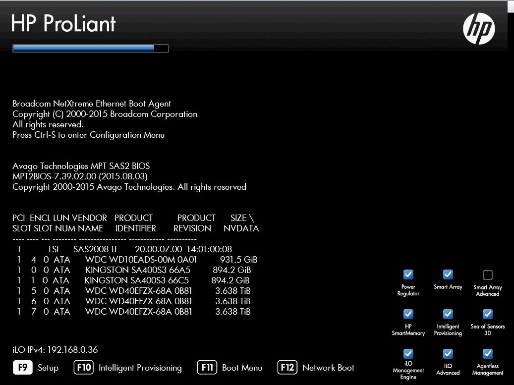

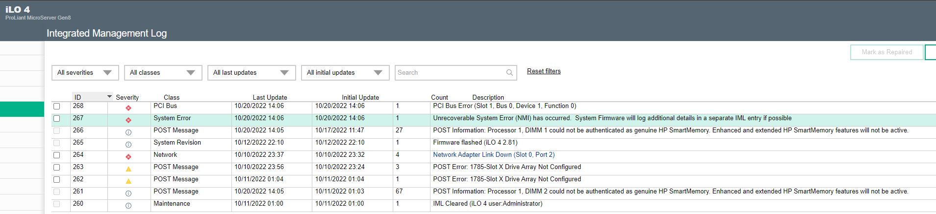

I've correctly flashed the firmware to P20 IT mode on LSI 9211-8i (LSI SAS-2008), but I'm facing issues in doing this last part as when I press Ctrl+C when asked, I get the following error: "nmi detected. please consult the integrated management log".
I must say, my HP iLO health status is deprecated, it works fine as I could test apart from the fact I cannot access to "Intellingent Provisioning" when I press F10 at boot, but have no problem in normal computer usage and remote control from iLO works perfectly...

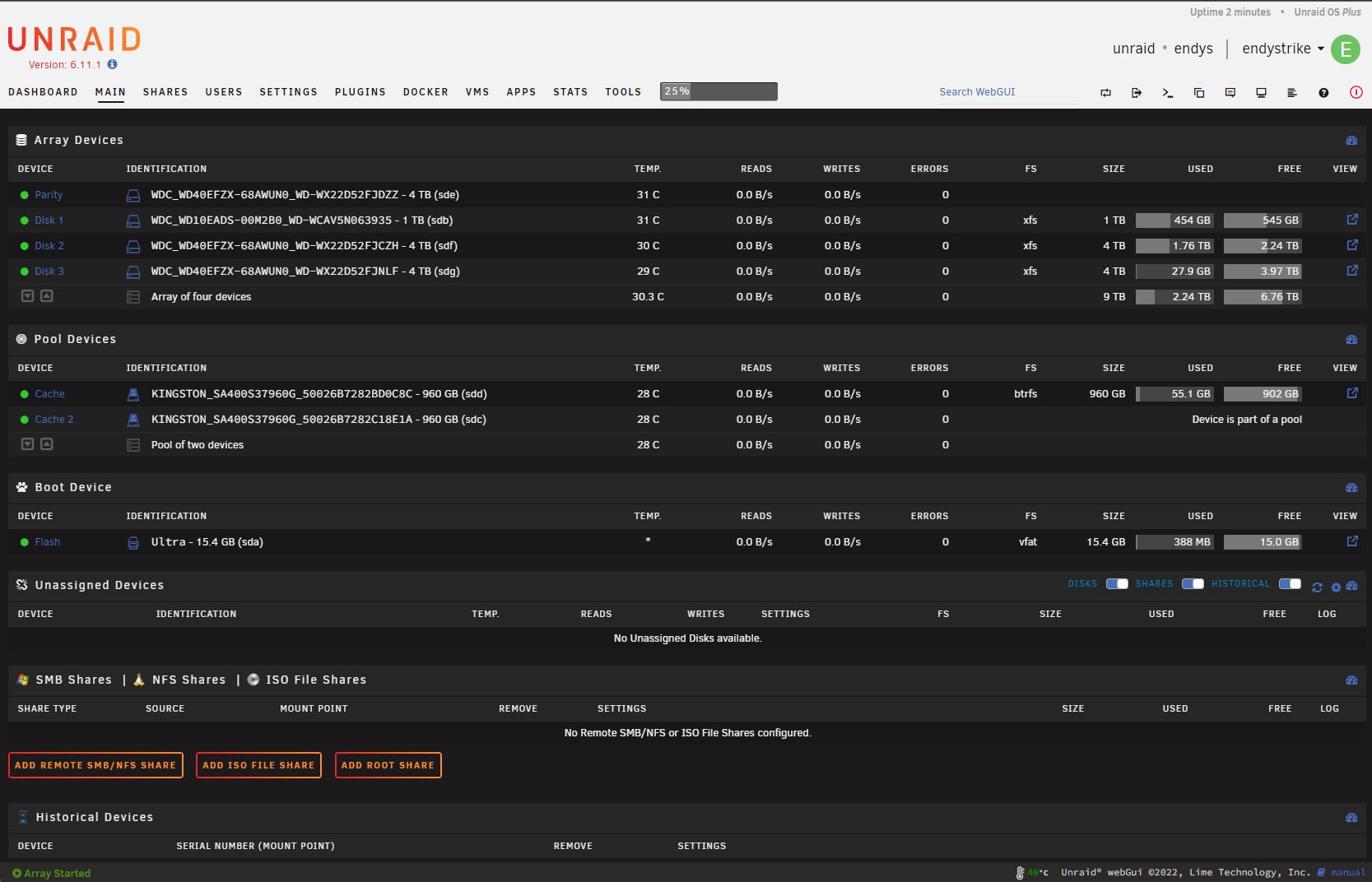

I've also disabled from BIOS the "HP RAID Integrated card", in fact it's not shown anymore in posts and in Unraid disks are shown correctly from LSI 9211-8i cards, they run perfectly and way faster than before... ;)
2061005026_2022-10-2017_04_18-endys_Main.thumb.jpg.5bec7e2856d5b6e18a59662d10c541ee.jpg
