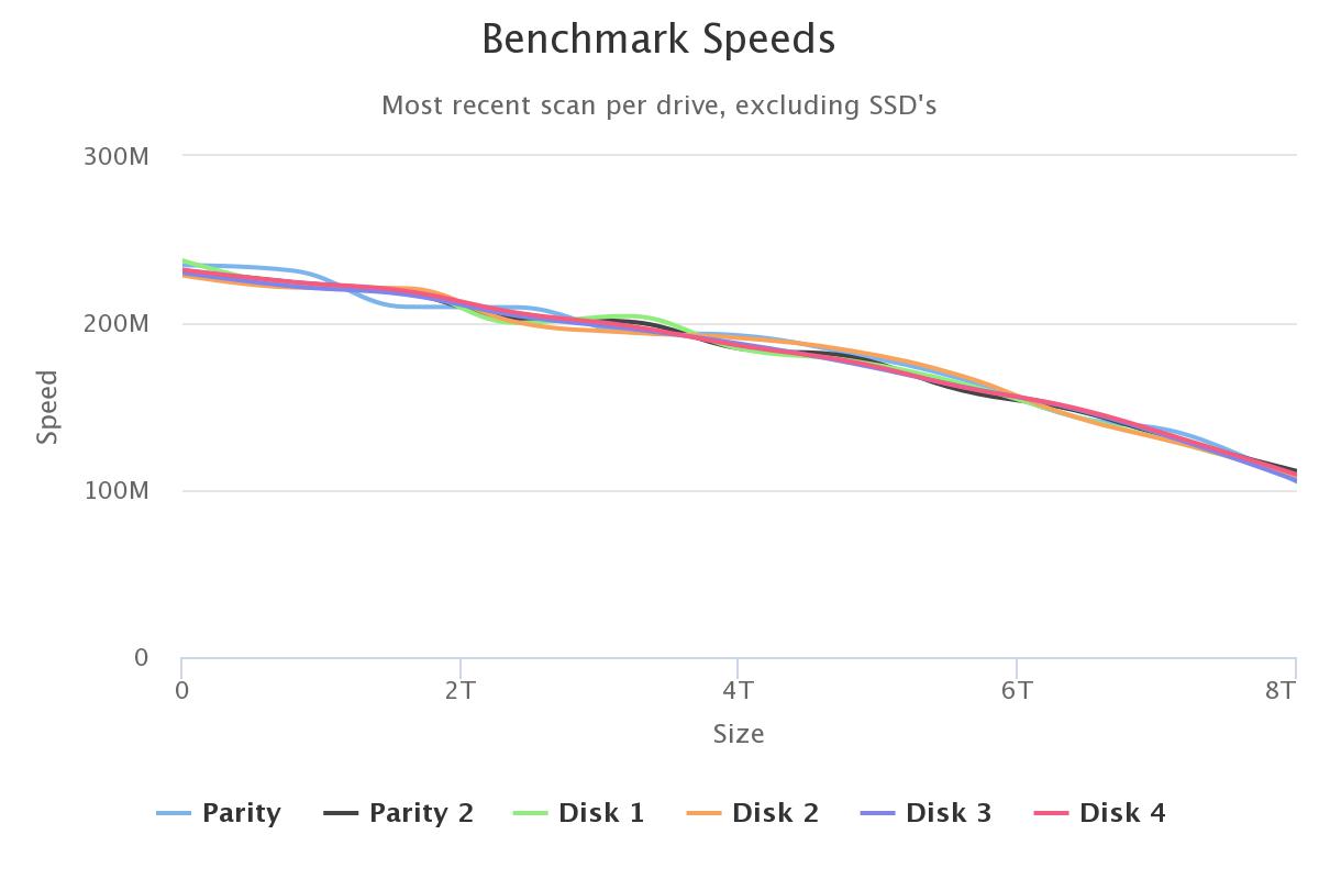

Run the diskspeed docker, it will test disks individually and controller bandwidth with all together.
It doesn't give a controller option.
All disks run at expected speed as per my original post.
Post the screenshot from the test.
Not sure why you won't just accept that I have done it and per drive performance is fine.
Not that one, the controller test.
As I said, It gives no option for that.
