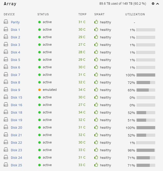

What about disabled disk9? Can't tell if emulated disk9 is mountable since array was never started in those diagnostics. You have a lot of disks and only single parity. Do any of your disks have SMART warnings on the Dashboard page?
Disk 9 seems to have had a glitch (wires?) and is in the process of rebuilding.
No SMART warnings on the Dashboard. I cannot see any sign that the SSD is detected in the logs, but then again I don't really know what I am looking at.
