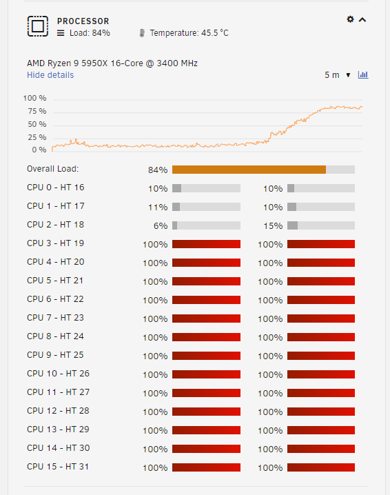

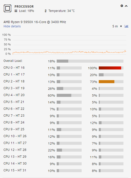

I have noticed on my system the time the system hits the hightest temps is when I have a few cores boosting to max clock. That will drive the CPU up as high as it can't go. When the entire system is under load it settles much lower. Here is what I mean.
This is the system at relative idle os just doing simple tasks. Hovering around 33-34 degrees
Under significant load it settles around 46 degrees. This is load created from setiathome using all of the cores
Okay, so as I was trying to create the condition I know I observed previously my system is making a liar out of me. I have confirmed it is boosting all the way to 4.5Ghz on 8 threads and the temps are staying below the highest I have seen of 46.  My fans are ramping up allot though so one question i would ask is what is your fan profile like. Do you hear your fans ramp up, or have you made keeping it all as quite as possible a priority. The reason i saw this before could be simply related to the fan profile i had i guess. I think in the past i did try to put a focus on noise reduction.
