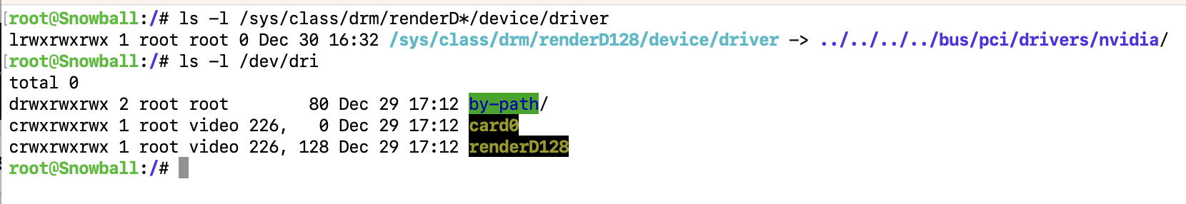

I have multiple GPUs.  i5 10400 and NVidia 1050 (see image)
When setting up the Plex Container and adding the --device=/dev/dri should I use /dev/dri/card? to select the card I wish to use?  If i leave /card? off will Plex just select card0?

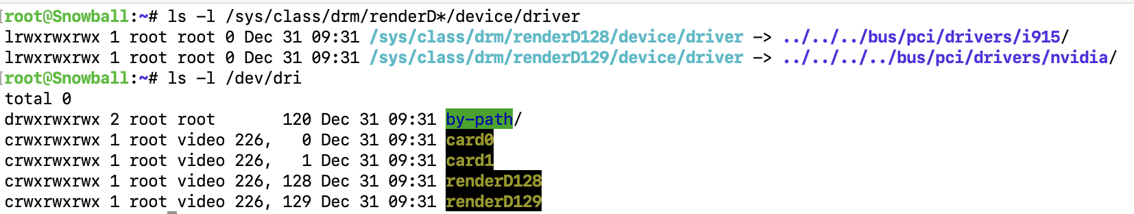

*PUSH* Same issue. I have 1 IGPU and 2 additional GPU's. Plex is not using the IGPU when the others are installed and not passthroughed to the VM's.

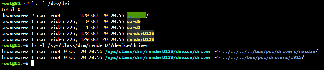

I just built out an Intel 13900K which also has an nVidia 1660 card on it. The graphics card is not used by any VMs; it would be nice to somehow load share / balance between the two cards. Unsure how OP got both the nVidia and i905 drivers to show up in /dev/dri, but here is my outputs.

So I kept all the nVidia configuration in place which I knew was working and then added the /dev/dri as a new device. Once I did that, the iGPU was the first targeted GPU to do the work. Unfortunately I'm a bit out of time to try and max out the iGPU and see if it'll roll over to the nVidia card.
Accord to this page (https://forums.serverbuilds.net/t/guide-hardware-transcoding-the-jdm-way-quicksync-and-nvenc/1408/2) it should work like this - "Plex will use QuickSync first in case of both a iGPU and Nvidia GPU installed."
