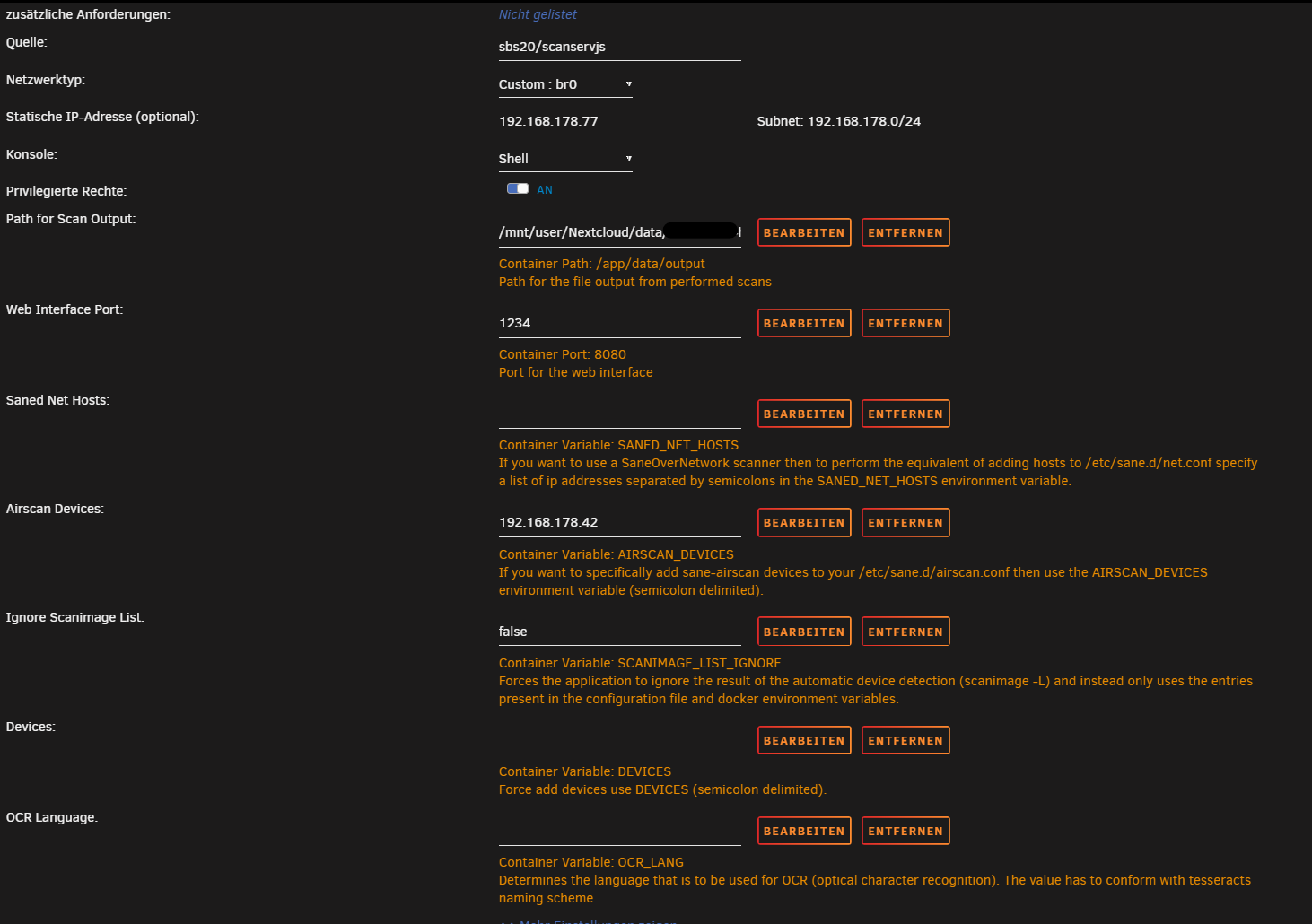

November 24, 20224 yr Hi, I have a similiar problem. Printer: Samsung C460FW This printer is connected over Wifi with address 192.168.178.42 and works fine with all other devices (Windows, Smartphones, etc.). I've installed the scanservjs image from Apps in UNRAID and configured my device with this IP. I've got the error "[object Object]" in the webinterface and no device found. If I try to scan with scanimage in the container it works fine. I use this command: scanimage -d 'airscan:w1:C460W' --format=png --batch='scan_out%d.png' --batch-count=1 --source Flatbed --resolution 150 --mode Color The "airscan:w1:C460W" can be replaced with the IP, it does not make any difference. In the log from the container I see this log: text error warn system array login # Test using the following form: # export SANED_NET_HOSTS="a|b" AIRSCAN_DEVICES="c|d" DELIMITER="|"; ./run.sh # turn off globbing set -f + set -f # split at newlines only (airscan devices can have spaces in) IFS=' ' + IFS= # Get a custom delimiter but default to ; DELIMITER=${DELIMITER:-;} + DELIMITER=; # Insert a list of net hosts if [ ! -z "$SANED_NET_HOSTS" ]; then hosts=$(echo $SANED_NET_HOSTS | sed "s/$DELIMITER/\n/") for host in $hosts; do echo $host >> /etc/sane.d/net.conf done fi + [ ! -z ] # Insert airscan devices if [ ! -z "$AIRSCAN_DEVICES" ]; then devices=$(echo $AIRSCAN_DEVICES | sed "s/$DELIMITER/\n/") for device in $devices; do sed -i "/^\[devices\]/a $device" /etc/sane.d/airscan.conf done fi + [ ! -z 192.168.178.42 ] + echo 192.168.178.42 + sed s/;/\n/ + devices=192.168.178.42 + sed -i /^\[devices\]/a 192.168.178.42 /etc/sane.d/airscan.conf unset IFS + unset IFS set +f + set +f node ./server/server.js + node ./server/server.js [2022-11-24T12:18:12.100Z] INFO (server): Started [2022-11-24T12:19:10.914Z] DEBUG (Http): request: { method: 'GET', path: '/context' } [2022-11-24T12:19:10.917Z] DEBUG (Devices): devices.json contains no devices. Reloading [2022-11-24T12:19:10.917Z] DEBUG (Devices): Config.devices: [] [2022-11-24T12:19:10.979Z] DEBUG (Http): request: { method: 'POST', path: '/preview' } [2022-11-24T12:19:10.981Z] DEBUG (Devices): devices.json contains no devices. Reloading [2022-11-24T12:19:10.981Z] DEBUG (Devices): Config.devices: [] [2022-11-24T12:19:22.834Z] DEBUG (Http): request: { method: 'GET', path: '/context' } [2022-11-24T12:19:22.835Z] DEBUG (Devices): devices.json contains no devices. Reloading [2022-11-24T12:19:22.835Z] DEBUG (Devices): Config.devices: [] [2022-11-24T12:19:22.898Z] DEBUG (Http): request: { method: 'POST', path: '/preview' } [2022-11-24T12:19:22.899Z] DEBUG (Devices): devices.json contains no devices. Reloading [2022-11-24T12:19:22.899Z] DEBUG (Devices): Config.devices: [] [2022-11-24T12:31:13.332Z] DEBUG (Http): request: { method: 'GET', path: '/context' } [2022-11-24T12:31:13.333Z] DEBUG (Devices): devices.json contains no devices. Reloading [2022-11-24T12:31:13.333Z] DEBUG (Devices): Config.devices: [] [2022-11-24T12:31:13.398Z] DEBUG (Http): request: { method: 'POST', path: '/preview' } [2022-11-24T12:31:13.399Z] DEBUG (Devices): devices.json contains no devices. Reloading [2022-11-24T12:31:13.399Z] DEBUG (Devices): Config.devices: [] My docker setting looks like this: If I enter the IP address into Devices, then I got this (Invalid Argument): node ./server/server.js + node ./server/server.js [2022-11-24T12:38:44.341Z] ERROR (Devices): Ignoring 192.168.178.42. Error: Error: Command failed: /usr/bin/scanimage -d '192.168.178.42' -A Output format is not set, using pnm as a default. scanimage: open of device 192.168.178.42 failed: Invalid argument [2022-11-24T12:38:44.390Z] ERROR (Devices): Ignoring 192.168.178.42. Error: Error: Command failed: /usr/bin/scanimage -d '192.168.178.42' -A Output format is not set, using pnm as a default. scanimage: open of device 192.168.178.42 failed: Invalid argument [2022-11-24T12:38:39.707Z] INFO (server): Started [2022-11-24T12:38:44.310Z] DEBUG (Http): request: { method: 'GET', path: '/context' } [2022-11-24T12:38:44.313Z] DEBUG (Devices): devices.json contains no devices. Reloading [2022-11-24T12:38:44.313Z] DEBUG (Devices): Config.devices: [ '192.168.178.42' ] [2022-11-24T12:38:44.384Z] DEBUG (Http): request: { method: 'POST', path: '/preview' } [2022-11-24T12:38:44.386Z] DEBUG (Devices): devices.json contains no devices. Reloading [2022-11-24T12:38:44.386Z] DEBUG (Devices): Config.devices: [ '192.168.178.42' ] I've tried the last 2 days similiar solutions and so on and don't have any idea how to fix this I hope some other person have an idea for this. Thanks! Regards trekki

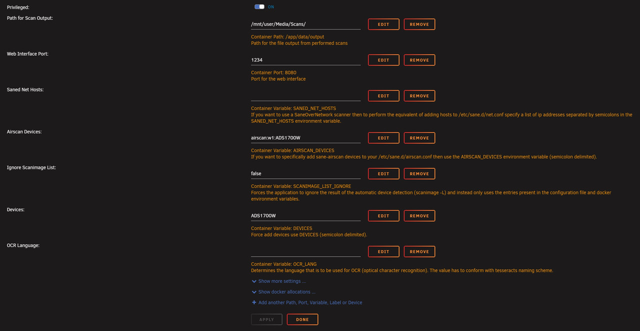

December 1, 20232 yr I had this working with an old Canon Pixima 410 but my replacement scanner will not load in the web interface. I have tried several variations including subbing in the IP address and leaving the Devices field blank in the docker settings menu on Unraid. My Brother ADS-1700W scanner isn't selectable regardless which values I use. From what I understand, I shouldn't need to install additional drivers if the scanimage -L command shows my device. # scanimage -L Created directory: /var/lib/snmp/cert_indexes device `airscan:w1:ADS1700W' is a WSD ADS1700W ip=192.168.1.123 Current docker settings:

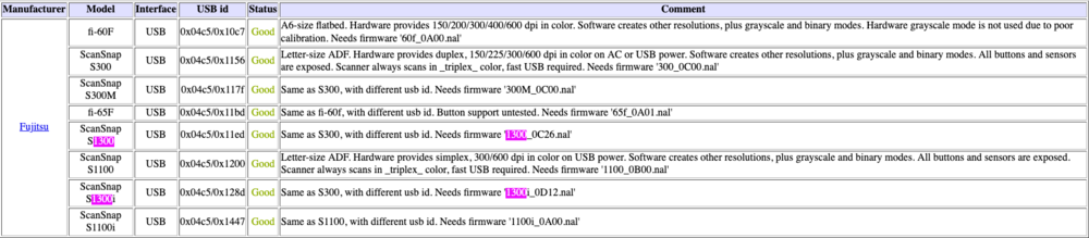

July 9, 20242 yr Hello, I have a Fujitsu S1300. the drivers are not included as part of the sane package. I have the driver and can get sane working in Linux Mint. I need to figure out how to get the driver into the Docker image. Could anyone give me some directions please. Thank you.
March 2Mar 2 On 7/9/2024 at 1:06 PM, Keith Ellis said:Hello, I have a Fujitsu S1300. the drivers are not included as part of the sane package. I have the driver and can get sane working in Linux Mint. I need to figure out how to get the driver into the Docker image. Could anyone give me some directions please.Thank you.I got my S1300i working by following these instructions:https://github.com/stevleibelt/general_vendor_products/tree/master/fujitsu/scansnap_s1300i#find your scanner sane-find-scanner # example output # found USB scanner (vendor=0x04c5 [FUJITSU], product=0x128d [ScanSnap S1300i]) at libusb:001:004 cat >> /etc/sane.d/fujitsu.conf <<DELIM # [FUJITSU], [ScanSnap S1300i] # <connection-type> <vendor-id> <device-id> usb 0x04c5 0x128d DELIM mkdir -p /usr/share/sane/epjitsu cd /usr/share/sane/epjitsu/ wget "https://github.com/stevleibelt/general_vendor_products/blob/master/fujitsu/scansnap_s1300i/1300i_0D12.nal?raw=true" --output-document=1300i_0D12.nalWe have different scanners, so you'll need to make adjustments. Run all of the commands from the scanserv-js docker terminal. You'll need to download and copy the firmware (file_name.nal) file into the docker container. This site will tell you which firmware file to download:http://www.sane-project.org/sane-backends.htmlHope this help.

September 27Sep 27 Whats the correct Entrys in the Template?The WebUI say no Device Found.Is Host or Custom Network required? The Default is Bridge. Any other Changes in the Template?# scanimage -L Created directory: /var/lib/snmp/cert_indexes <!DOCTYPE HTML PUBLIC "-//W3C//DTD HTML 4.01//EN " "http://www.w3.org/TR/html4/strict.dtd"> <html> <head> <meta http-equiv="Content-Type" content="text/html; charset=utf-8"> <meta name="Author" content="SEIKO EPSON"> <meta name="viewport" content="width=device-width, user-scalable=yes, initial-scale=1.0"> <meta name="format-detection" content="telephone=no"> <meta http-equiv="X-UA-Compatible" content="IE=edge"> <script type="text/javascript"> var path = location.href; var Ret; Ret = path.indexOf("/PRESENTATION/HTML/TOP/INDEX.HTML", 0); if (-1 < Ret) { } else { Ret = path.indexOf("PRESENTATION",0); if (-1 < Ret) { document.write("<meta http-equiv = 'refresh' content='0; URL= ./HTML/TOP/INDEX.HTML'>"); } else { document.write("<meta http-equiv = 'refresh' content='0; URL= ./PRESENTATION/HTML/TOP/INDEX.HTML'>"); } } </script> </head> <body><noscript>Aktivieren Sie die JavaScript-Einstellung des Browsers.</noscript></body></HTML>device `escl:https://192.168.xxx.xx:443' is a Epson ET-4850 Series platen,adf scanner device `airscan:e0:EPSON ET-4850 Series' is a eSCL EPSON ET-4850 Series ip=192.168.xxx.xx # ipps://EPSON%20ET-4850%20Series._ipps._tcp.local/ from a Scan Software under KDE.<?xml version="1.0"?> <Container version="2"> <Name>scanservjs</Name> <Repository>sbs20/scanservjs</Repository> <Registry>https://hub.docker.com/r/sbs20/scanservjs</Registry> <Network>bridge</Network> <MyIP/> <MyMAC/> <Shell>sh</Shell> <Privileged>true</Privileged> <Support>https://forums.unraid.net/topic/130023-scanserv-js-support-thread</Support> <Project>https://github.com/sbs20/scanservjs</Project> <ReadMe/> <Overview>scanservjs is a web UI frontend for your scanner. You can perform scans using your USB or network scanner through this web UI. The application allows you to share one or more scanners (using SANE) on a network without the need for drivers or complicated installation. To discover your devices, open the docker console and run: scanimage -L This will return a list of discovered devices. Copy the device id e.g. "epson2:libusb:001:002" and put it into the devices variable.</Overview> <Category>Drivers: Tools:Utilities MediaApp:Photos</Category> <WebUI>http://[IP]:[PORT:8080]</WebUI> <TemplateURL>https://raw.githubusercontent.com/moritzfl/unraid-templates/main/scanserv-js/scanserv-js.xml</TemplateURL> <Icon>https://github.com/sbs20/scanservjs/blob/master/app-ui/src/icons/android-chrome-512x512.png?raw=true</Icon> <ExtraParams/> <PostArgs/> <CPUset/> <DateInstalled>1790536200</DateInstalled> <DonateText/> <DonateLink/> <Requires/> <Config Name="Path for Scan Output" Target="/var/lib/scanservjs/output" Default="" Mode="rw" Description="Path for the file output from performed scans" Type="Path" Display="always" Required="false" Mask="false">/mnt/user/Scan</Config> <Config Name="Web Interface Port" Target="8080" Default="" Mode="tcp" Description="Port for the web interface" Type="Port" Display="always" Required="false" Mask="false">1234</Config> <Config Name="Saned Net Hosts" Target="SANED_NET_HOSTS" Default="" Mode="" Description="If you want to use a SaneOverNetwork scanner then to perform the equivalent of adding hosts to /etc/sane.d/net.conf specify a list of ip addresses separated by semicolons in the SANED_NET_HOSTS environment variable." Type="Variable" Display="always" Required="false" Mask="false"/> <Config Name="Airscan Devices" Target="AIRSCAN_DEVICES" Default="" Mode="" Description="If you want to specifically add sane-airscan devices to your /etc/sane.d/airscan.conf then use the AIRSCAN_DEVICES environment variable (semicolon delimited)." Type="Variable" Display="always" Required="false" Mask="false">airscan:e0:EPSON ET-4850 Series;escl:https://192.168.xxx.xx:443</Config> <Config Name="Ignore Scanimage List" Target="SCANIMAGE_LIST_IGNORE" Default="false | true" Mode="" Description="Forces the application to ignore the result of the automatic device detection (scanimage -L) and instead only uses the entries present in the configuration file and docker environment variables." Type="Variable" Display="always" Required="false" Mask="false">false </Config> <Config Name="Devices" Target="DEVICES" Default="" Mode="" Description="Force add devices use DEVICES (semicolon delimited)." Type="Variable" Display="always" Required="false" Mask="false"/> <Config Name="OCR Language" Target="OCR_LANG" Default="" Mode="" Description="Determines the language that is to be used for OCR (optical character recognition). The value has to conform with tesseracts naming scheme." Type="Variable" Display="always" Required="false" Mask="false">deu</Config> <Config Name="AppData Config Path" Target="/etc/scanservjs" Default="" Mode="rw" Description="Folder for persisting configuration data" Type="Path" Display="advanced-hide" Required="true" Mask="false">/mnt/user/appdata/scanservjs</Config> <Config Name="dbus" Target="/var/run/dbus" Default="eng | deu | fra | spa" Mode="rw" Description="dbus (needed for automatic detection of network scanners through bonjour)" Type="Path" Display="advanced" Required="false" Mask="false">/var/run/dbus</Config> <TailscaleStateDir/> </Container>
