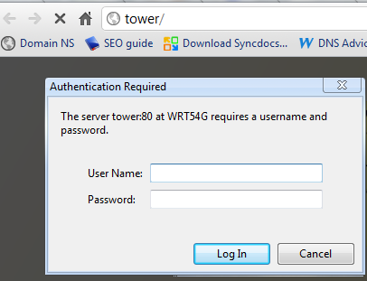

Hello,
Unlike of anything I found in any tutorial for unRaid I get prompted for User/Password at first access to tower (screenshot attached)...
The default root/blanc is not working..
According to the guides I checked the creation of additional users is done only through the web interface, therefore as a noob that I am in Linux world I am lost.
Please advice.
Seba
That's your ROUTER asking for credentials, unless you managed to find a way to run unRAID on your Linksys WRT54G!
Thank you for the idea, seems to be right, although I don't know what to do about it...
Why would the router ask for credentials for accessing a different machine in the network?
Correct me if I'm wrong, but for 2 machines in the same lan it should be more or less like a blind HUB...
It seems there was an older router on the network with a static IP.
Thanks for pointing me to the obvious! :'(
