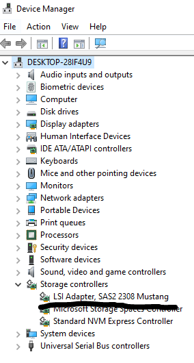

Assuming the card is defect I put it into my Windows machine and there it worked fine. (at least I could boot and the PCIe device was shown)

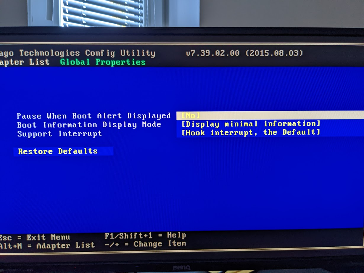

This is the card menu:
I dont really see anything there.

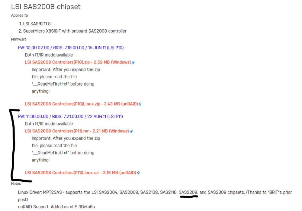

I went to the link you sent, downloaded this:
And When I follow the readme I arrive at this error trying to list the card:
I guess I need to get into a DOS menu to launch the  sas2flash -o -e 5 command? Not sure which .img to use with rufus? The bootfile in here: https://wiki.unraid.net/Crossflashing_Controllers#sas2flash Seems to be deleted?

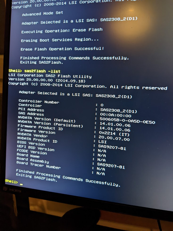

Ok I managed to delete the BIOS version:
Now on my Windows machine it boots directly into the bios, but on the Unraid machine it still gets stuck in the bootloop. Taping the 5 & 6 PCI pins still works.
