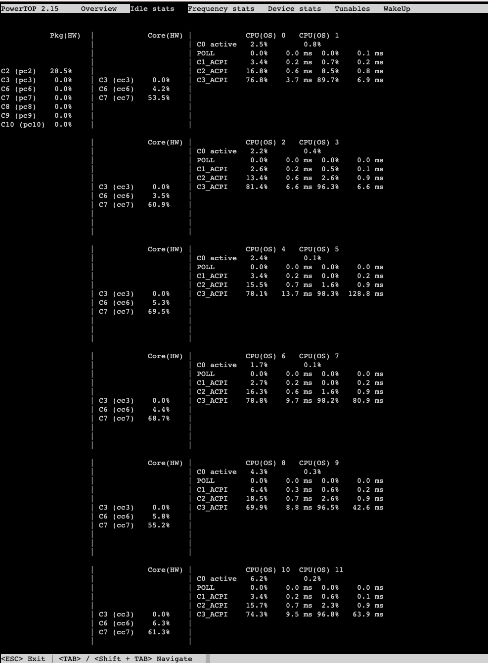

Also did the "powertop --auto-tune", and I saw that all the isolated p-cores ("Isolated CPUs") that I configured in the CPU pinning settings were never going below 3.5GHz..., and then I realised this was because these cores are not at all managed by Unraid OS any more, so they are not getting into a lower power mode even thought they are not in use (the VM using these p-cores is currently not started).
So I did revert that setting to remove all CPU isolation, and once this was done, the P-cores where finally going into a C7 state with a very low frequency.
Now, the server is chugging along at ~46W, the CPU is at 32°C, and mobo at 28°C 🙂

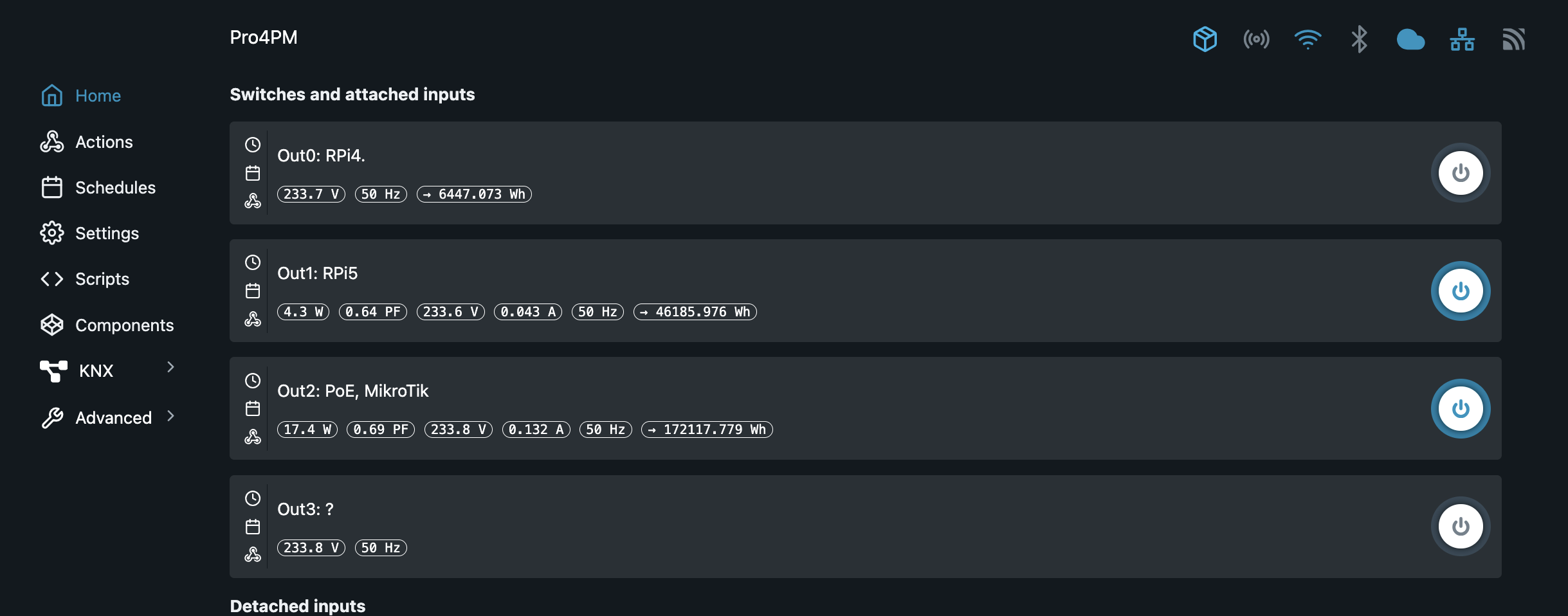

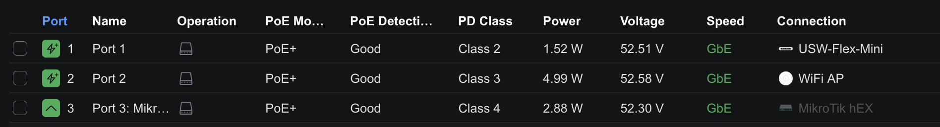

Look beyond your server. Network switches, routers and access points can consume a surprising amount of power. Managed devices tend to consume more power than unmanaged and might not be worth the extra cost of the device and/or operation if you have a simple network. Tri band access points consume more power than dual band. If the air where you live is not congested, you can get fine performance with dual band APs. Lots of empty ports use power, a smaller switch might be a better choice.
☝️ good adivce @Morris0
For example my:
  • Wi-Fi 6 AP from Ubiquiti (U6-Lite) consumes 4 ~ 5 W (powered by PoE)
  • main router Mikrotik hEX consumes 2.5 ~ 3W (only 5 ports)
  • Unifi mini switch 5 ports (USW-Flex-Mini): ~1.5W
  • and PoE switch (USW-Lite-8-PoE) with only 8 ports where 4 are with PoE consumes ~8 W
= in total ~17W (see third item - Out2: PoE, MikroTik):
