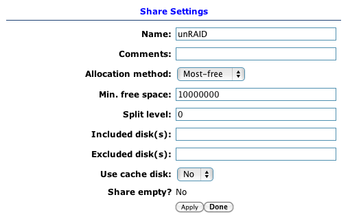

Can you take a screenshot of your User Share that's set to split level 0?

The share is "unRAID". Inside there, I have folders for Videos, which has Movies, TV, Recorded TV. Inside "unRAID" I also have other folders for music, etc.
I don't want to have a bunch of different network shares, each with different hard coded split levels. I also don't want to rename all my files to include a special character like "[" to achieve different split levels on one share.
From what I've read, split level 0 should achieve what I want perfectly. I will manually create the folders on each disk that I want that particular folder to split across (via disk shares). Unfortunately, it doesn't seem to work reliably :(
I did some manual tests last night, and it does appear to work as described. I can't reliably reproduce the strange behaviour. However, this is not the first time that files have seemingly randomly ended up on the wrong disk.
Screenshots attached of the unRAID share settings, and the global system share settings.
i believe split level only works on the share not the folders in it.
since the share is present on all disks afaik it can use any of those disks to put files in
