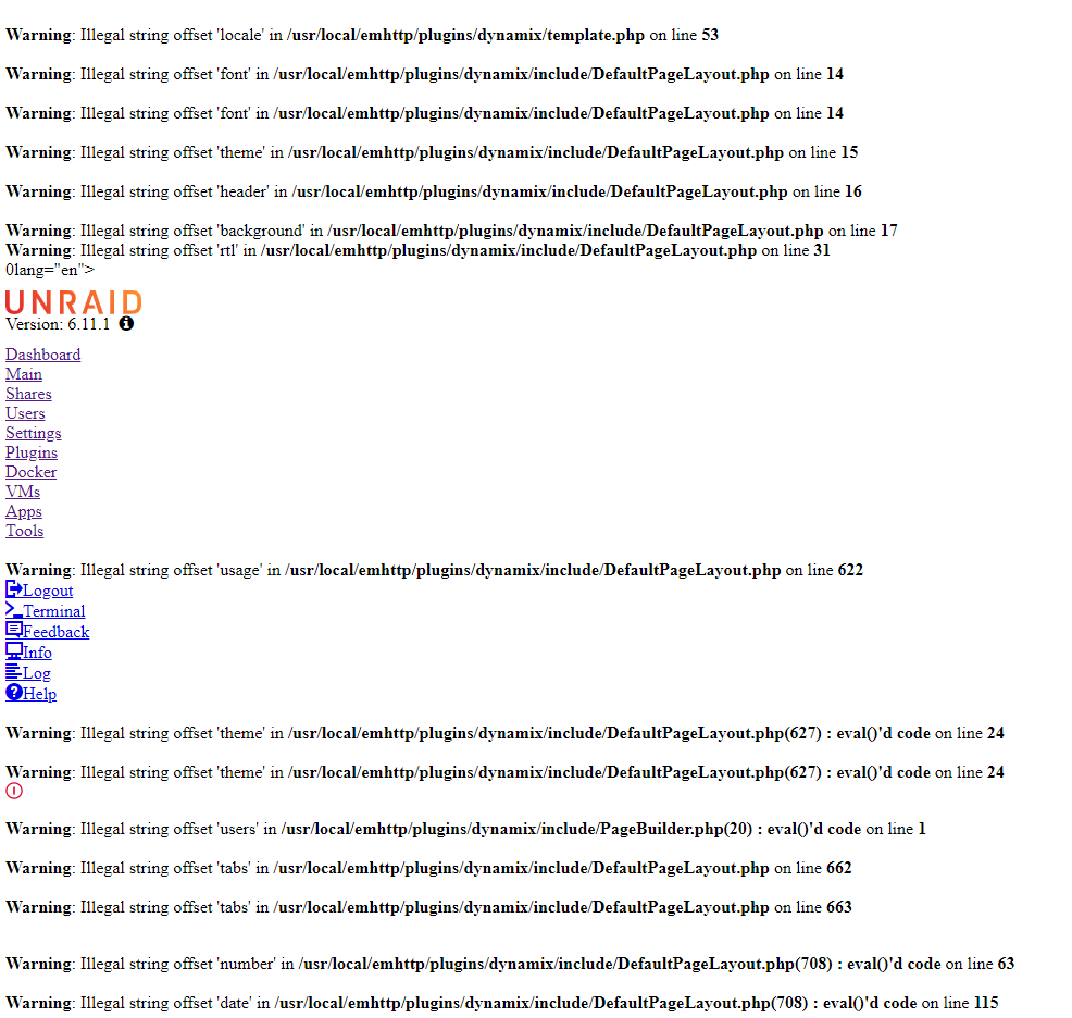

Been a few times getting something similar where the webgui errors out until I reboot the server (at this point cant go a day without having to reboot the server, and I just have it on, doing nothing..)
 This is the current one, and the worst so far. I click through the dashboard, main, shares, ect and its all this. Googling has brought me to unraid support where people are told to delete smart files, but I dont know how to do that yet.
Going through the syslog file from diagnostics, started throwing these codes yesterday morning:
segfault at 0 ip 0000000000000000 sp 00007fff81442c68 error 14 in smartctl[400000+4000]
Then this morning, started throwing this or similar:
 Illegal string offset 'date' in /usr/local/emhttp/plugins/dynamix/include/Helpers.php on line 4
And about an hour ago started throwing these, didnt know any of this until I checked pretty recently and am unable to even log in with another browser.
php-fpm[6069]: [WARNING] [pool www] child 17047 exited on signal 6 (SIGABRT) after 11.255864 seconds from start
The second ones with the /php files is the one causing my webgui problems I think.

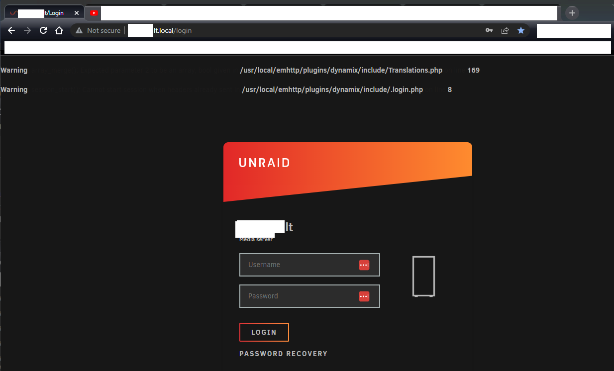

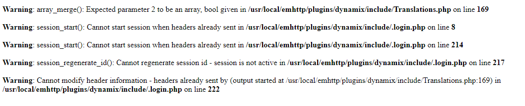

Any way to restart unraid without a hard reset (pull power plug) and wait two days for a parity check? I am getting this page with errors at the top for login screen, then the 2nd picture after logging into server this morning. Unknown where to click to shut it down..
After shutting down, and starting in safe mode to check, how long should I run it to determine plugins are the problem? It lasted almost a month until it happened again with another parity check, and a power outage in between..

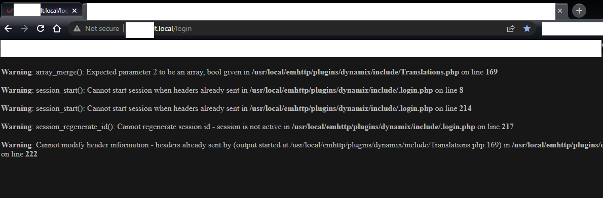

This is what I get when I try to log in to the server:
By console I meant to use a keybaord and monitor on the server or IPMI if you have it.

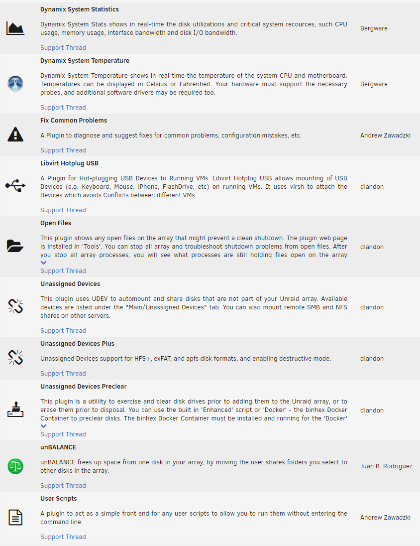

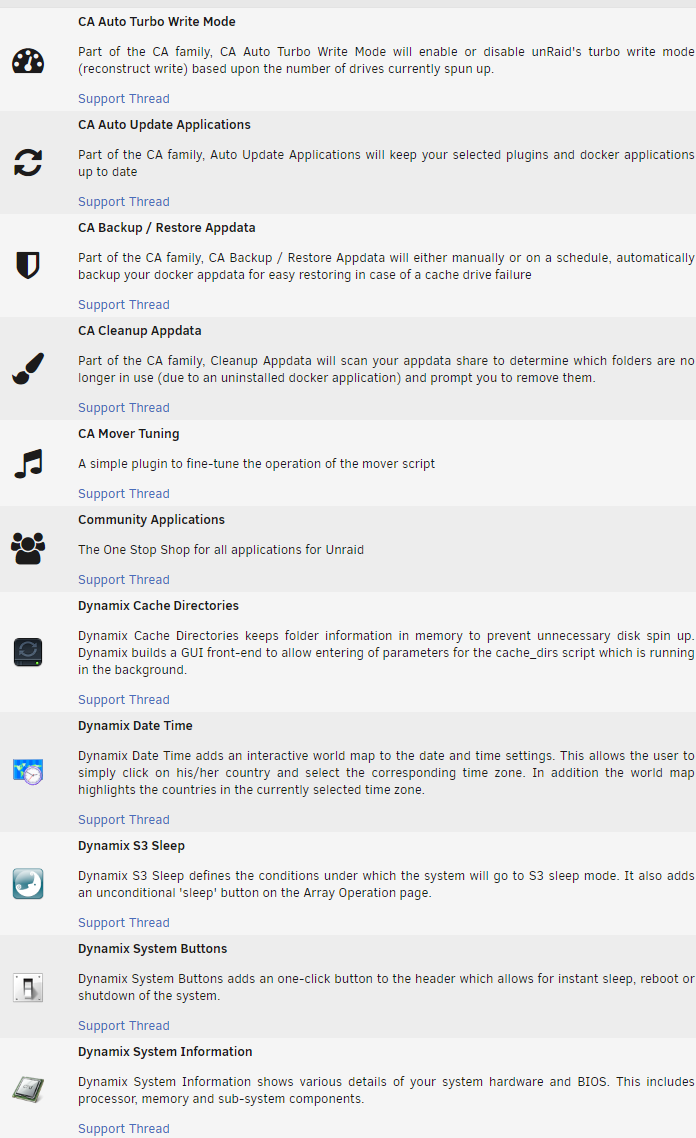

Heres my plugin page. I have everything basically at stock settings until I actually start using them. Mainly set up the backup application for the USB/Appdata/ect, and currently using Preclear (damn 16tb drives take forever). Im scratching my head from the descriptions to even find something tangentially related to weird webpage errors preventing usage of Unraid through the web portal. Edit: Also using moving tuner to run a check every hour on SSD to see if its over 70% threshold.
Im not using any Dockers or VM's yet. Kinda wanna get this figured out first before relying on the server to start hosting plex/gameservers/ect. Next order of business while tracking down this problem; finish the Parity check (2 more days) from the last forced shutdown, pull the parity drive for RMA (reallocated sectors going up) and replace with the one undergoing preclear right now, then figure out how to get my UPS to send shutdown signals. Also, find out why the drive I literally just shucked today isnt being detected by Unraid whatsoever, even though the new 16tb one is (same 4port sata cable and power being used).

WOW... that's a load of plugins... I have been using unraid for 10y now... and I have only 2 plugins...
something that I learned in the military is... KISS... Keep It Simple Stupid...
Take things slowly and make measurable changes... just starting out and adding all of these changes will make it hard to figure out if something is wrong...
IMO... remove the plugins and start from near stock... and then layer on the addons... this will make it simple to figure out what broke...
Few here will want to troubleshoot a 100 changes in a short time frame... where as if you take your time to load the array and layer in the plugins, things will be easier to troubleshoot...
Best of luck

Thanks, yeah... Got excited and did the Youtube search "Top X plugins for Unraid", and just followed one of the listings. Going to remove a bunch and wait and see if it helps.

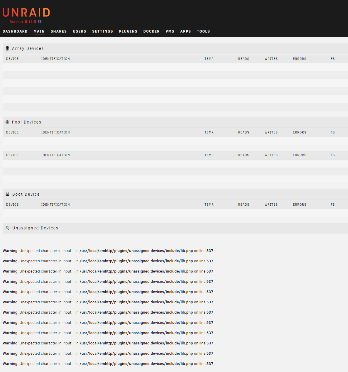

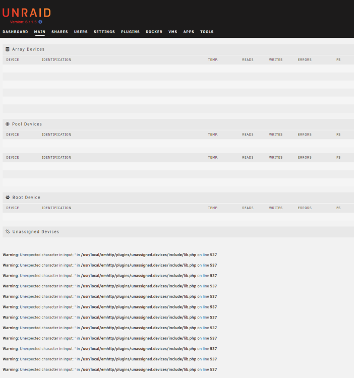

Got a new one today lol: Luckily I can still hit the restart button, but the Array and Pools seem to have disappeared. Cant reach network drives in windows. Dashboard seems fine, just everything in Main is gone and cant actually use.
The warning error mentions pluging/unassigned.devices. I am going to go out on a limb and think that is the one causing all this. Dynamix was shown in my original errors... Hopefully its the Sleep one that I never used or set up. I really use the other plugins... Hmm wonder if its the Cache Directories in memory one, and my memory is throwing errors causing the problem?
Some of those plugins aren't useful unless you have dockers or VMs. And you do have Docker and VM Manager enabled in Settings. Your system share has files on the array, probably because you enabled Docker and/or VM Manager before you had created the pool for those.
Earlier you said you didn't have any dockers or VMs. Is that still true?
