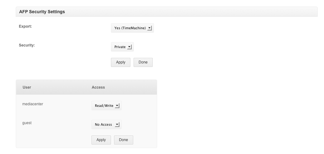

This is how I have mine setup. Apart from a few small authentication log issues, no problems with two Macs to the same share.
funny you're weub gui looks very different from mine - much cleaner.  It also has the options for quest under AFP where mine doesn't.  Other than that I'm setup the same way
