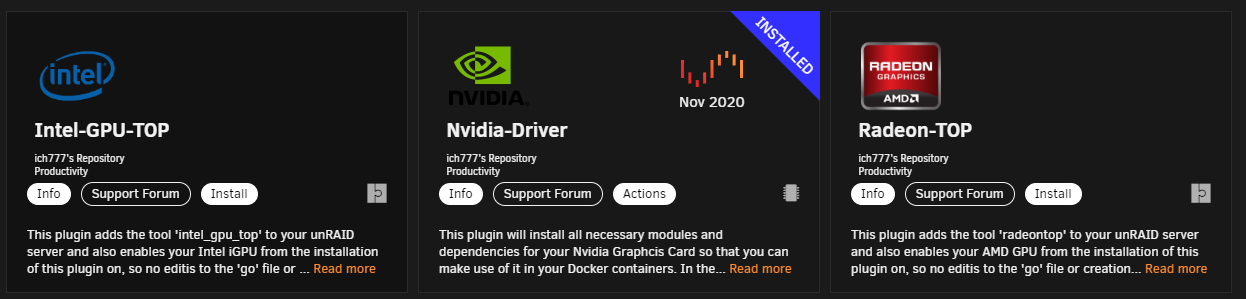

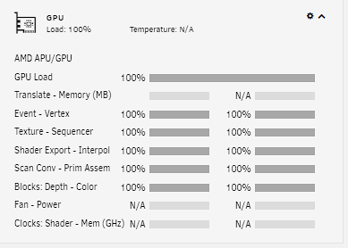

Thanks Squid for the tip. I have installed Radeon-Top and also GPU Statistics but infortunately no data displayed. I wonder if my Graphic Card is recognized or compatible with this plugins ?
Executing radeontop on a command line i have this result :
Failed to find DRM devices: error 2 (no such file or directory)
Failed to open DRM node, no VRAM support.
