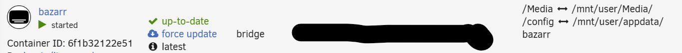

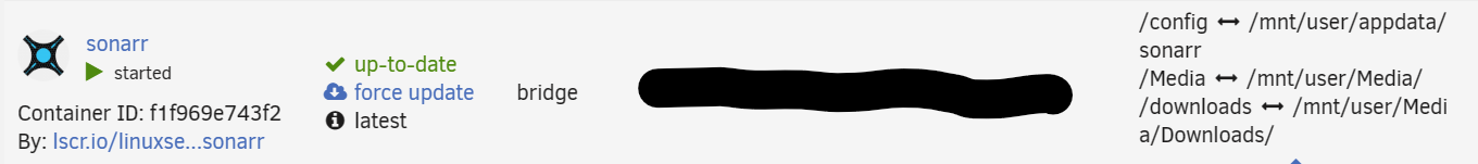

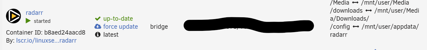

Sorry I just saw this. Here are screen shots of how I have each configured.
Bazaar
Sonarr
Radarr

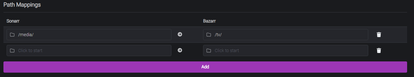

My solution to the same issue for others that may find themselves here;
The trash guides instructions say not to add path mappings to your Sonarr (presumably Radarr also but untested) setups if you are within the same location however as shown here the mappings are slightly different. I had to add a path mapping for both like below
