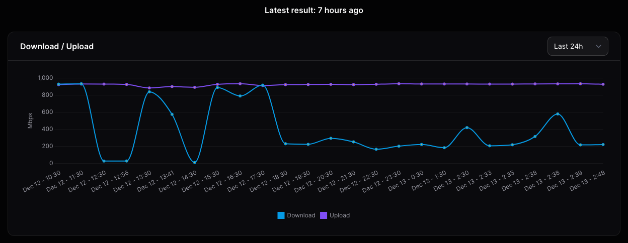

Hello, This is for the unraid docker version of this app. My speedtest results keeps showing the Latest results 7 hours ago. And when you look at the time line, the most recent speedtest listed as 7 hours prior to current time. Incase I didnt make any sense, if I manually run a speedtest, and the current time is 10:00am on Dec 13th. It will show on the graph as DEC-13 - 3:00. Is there a fix for this.

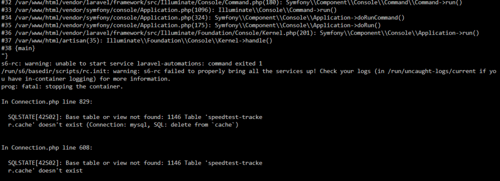

I can't get this to run whatsoever. I installed the MySQL-Official addon (Docker), used the same database name, user name & password on both. I tried using the Unraid IP address and the docker container name (mysql), but I can't get anywhere. No matter the DB_HOST, it always fails.  It comes up with a "connection refused" error every single time. Hoping someone can help. I can send more info if it's needed, but here's the end of the log, where it errors out and closes.
#39 {main}
s6-rc: warning: unable to start service laravel-automations: command exited 1
/run/s6/basedir/scripts/rc.init: warning: s6-rc failed to properly bring all the services up! Check your logs (in /run/uncaught-logs/current if you have in-container logging) for more information.
prog: fatal: stopping the container.
In Connection.php line 822:
  SQLSTATE[HY000] [2002] php_network_getaddresses: getaddrinfo for mysql fail
  ed: Name or service not known (Connection: mysql, SQL: select table_name as
   `name`, (data_length + index_length) as `size`, table_comment as `comment`
  , engine as `engine`, table_collation as `collation` from information_schem
  a.tables where table_schema = 'db' and table_type in ('BASE TABLE', 'SYSTEM
   VERSIONED') order by table_name)
In Connector.php line 65:
  PDO::__construct(): php_network_getaddresses: getaddrinfo for mysql failed:
I uninstalled MySQL & install MariaDB-Official, instead. I'm not getting a 'Connection refused' error. Instead, I'm getting an 'Access Denied' error. Again, I've verified that the dbname, username & passwords match.
Log for Speedtest-Tracker:
#36 {main}
  SQLSTATE[HY000] [1045] Access denied for user 'dbuser'@'172.17.0.1' (using
  password: YES) (Connection: mysql, SQL: select table_name as `name`, (data_
  length + index_length) as `size`, table_comment as `comment`, engine as `en
  gine`, table_collation as `collation` from information_schema.tables where
  table_schema = 'mydb' and table_type in ('BASE TABLE', 'SYSTEM VERSIONED')
  password: YES)
Log for MariaDB:
2024-01-28 20:53:46 3 [Warning] Access denied for user 'dbuser'@'172.17.0.1' (using password: YES)
2024-01-28 20:54:31 4 [Warning] Access denied for user 'dbuser'@'172.17.0.1' (using password: YES)
Edited by malaki86
Added log snippet
