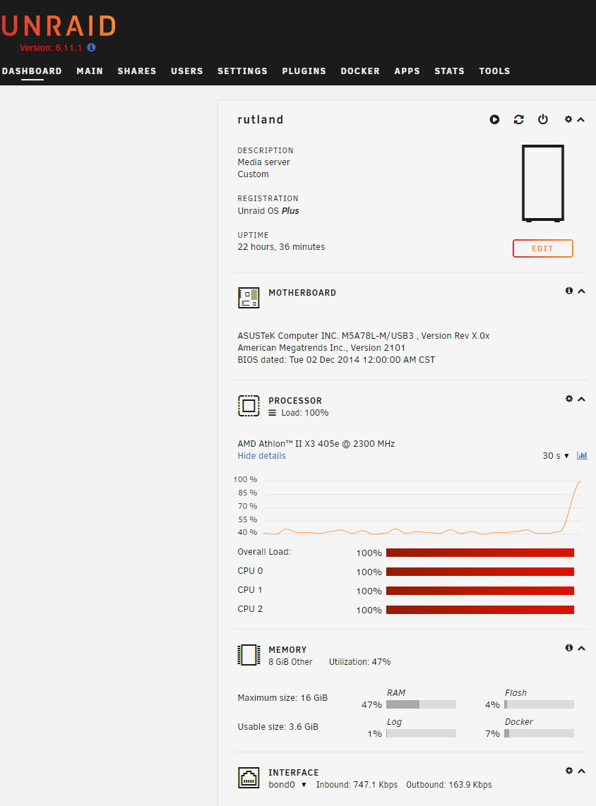

WebUI was still responsive, and it showed all 3 cores pegged at 100% (another first).
shfs is stuck 68% and smbd at 28%

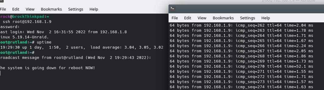

I have hit the "Reboot" button, just before I did that I sent continuous  pings and it's responding, as soon as I hit reboot the pings stopped, as one would expect, but shows that something is happening, however, it did not reboot has uptime is still at 23hrs.
So, what next, hard power off using the physical power button?
wait time is very high in top, but the other odd thing is the webUI shows CPUs pegged at 100%, but when usign ssh and htop, there isn't much going on, 2% for shfs, emptd 1% etc.
I gave and hard powered off, "Power Off" in UI did nothing, also powerdown -r in command line did nothing.

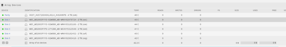

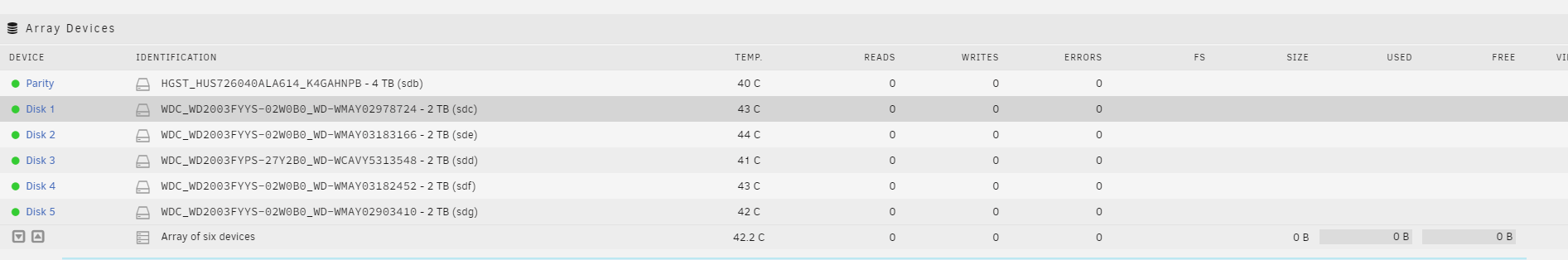

Also the drive all still have green balls next to them, and I have zero read writes from all the disks, also reporting temps of 43C which is the sort of temps I get when the drives are spinning, so it's like the UI is not refreshing, and the array is still stuck at Starting Array and all the disks are spinning.

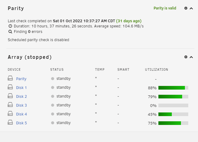

I left it overnight, wondering if it indeed was misleading, was started doing a parity check and the UI is just misleading me, it was still the same as I left but with one minor difference, in the top right corner the "Parity has completed" pop-up dialog box was shown, it wasn't before, so I do indeed now wonder if it completed the parity check and it's all UI issuses.

Screenshot below, shows the live output of the console, while pinging as I hit the Reboot button, and it does not reboot.

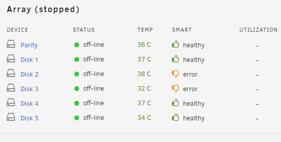

Did a hard power off, then activated Safe Mode, rebooted.The drives showed as off-line in the window under Array in the Dashboard, which is as one would expect.

I think the disk are constantly spinning, as the drives temps are on the high side.

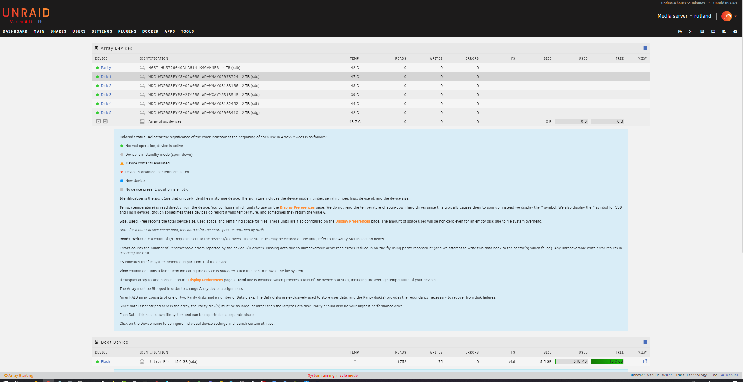

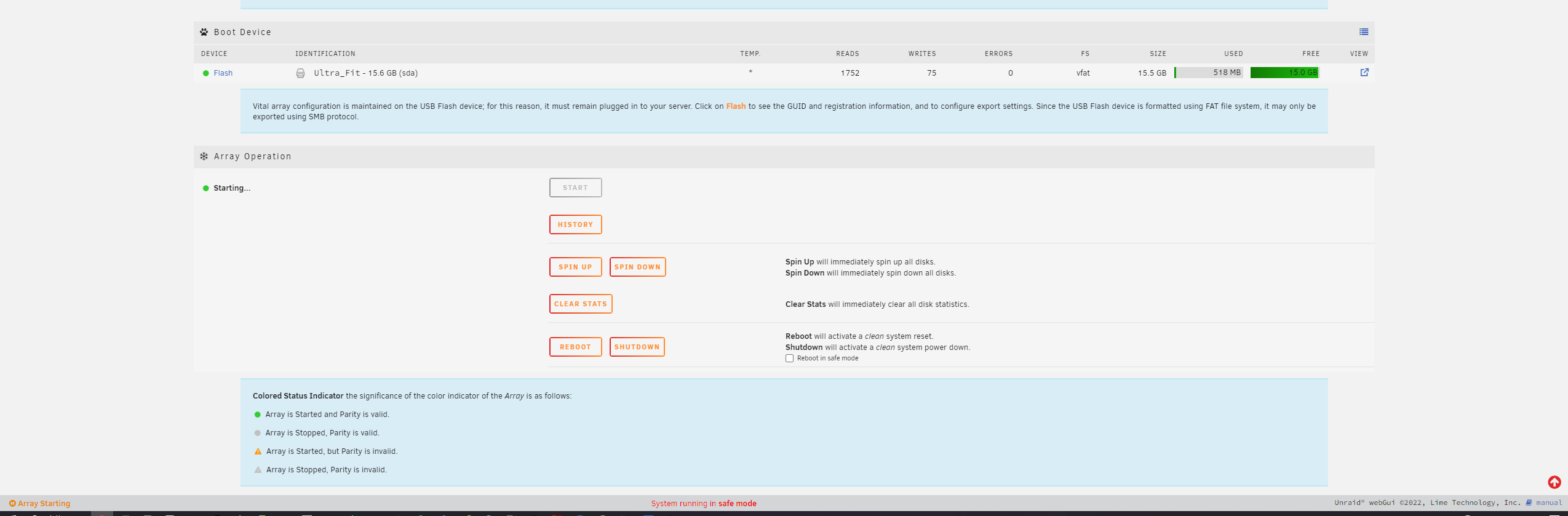

Post a screenshot of the main GUI page, according to the syslog array didn't start.
Here we go
Edited by fishface

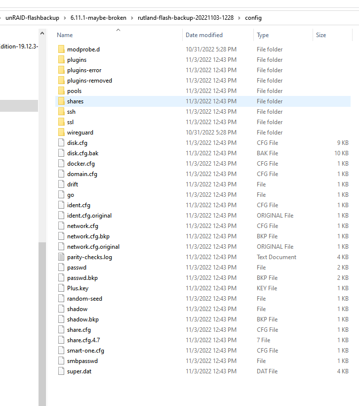

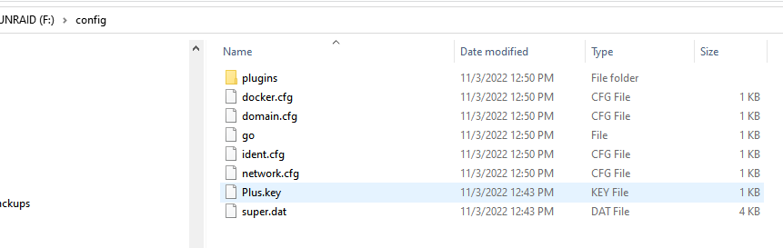

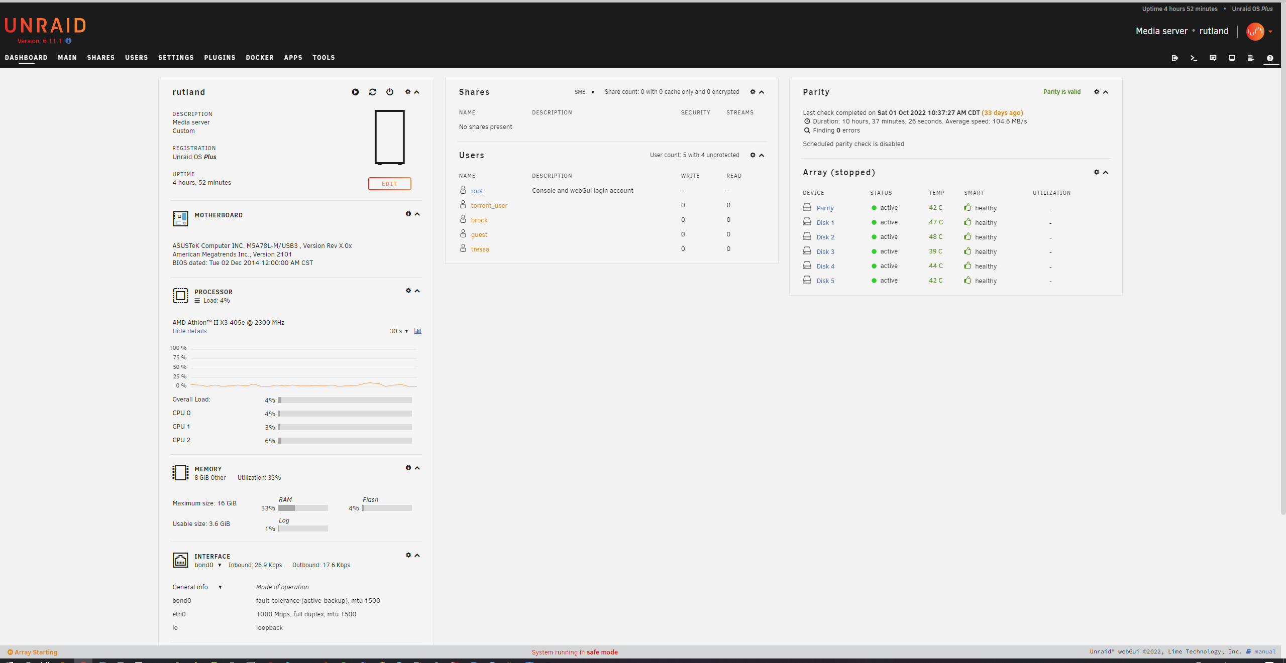

Just checking something, the first screenshot shows the contents of my 6.11.1 broken config directory, the second screenshot is the backup now copied to the original USB thumb drive, with the super.dat and the key.PLUS file copied over from the 6.11.1 broken config directory.
My query is this, new USB thumb drive config directory has a lot less content/files - is this expected?

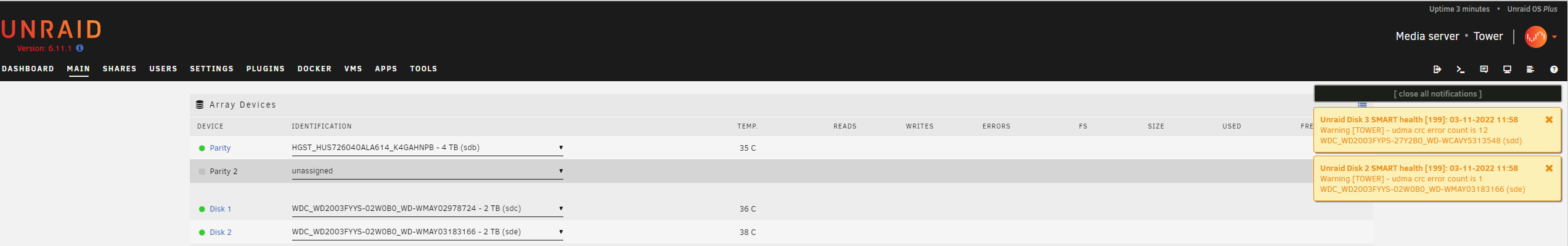

Could be issues with disk2 and 3, even though they recently passed a SMART last week.
And of course, it has lost all my shares configs, but I guess I can copy that over from the backup once the other issues have been fixed.
Edited by fishface
SMART warning are likely about the existing UDMA CRC errors, you can acknowledge them, and start the array to see if it works better.
