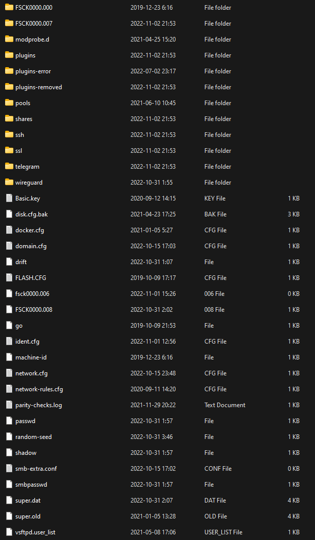

Yes. I took the entire "config" folder and used it to overwrite the one the UNRAID-Tool created when making the drive.
It looks like this now (I left the FSCK folders in just to be sure):
The FSCK folders won't be accessed by anything. Don't know if you can manually get anything of the lost config from them or not.
