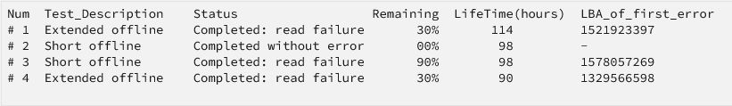

The drive failed the extended SMART test, I would let it sync parity, pending sectors should go to zero when done, then run an extended SMART test, or a non correcting parity check.

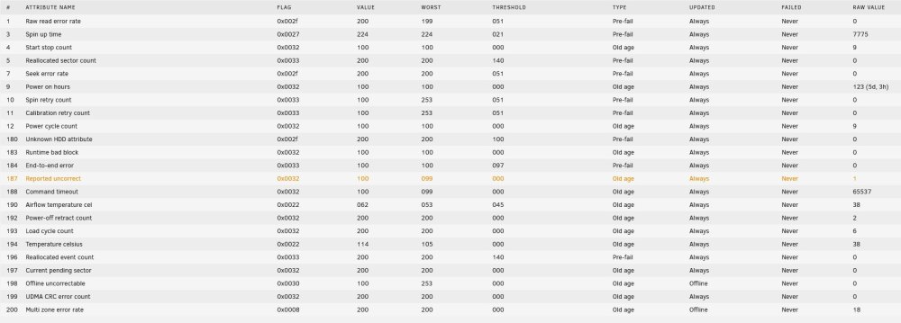

I think the problem is that this is the server for my father.  He wants something to back his photography up to.  The disk displaying a SMART error is a visually discomforting thing.  Obviously because these are "new" disks (2 years old, but not been used for anything) it should not have any errors.  So, how important are SMART errors?  Like, is this server actually fine and dandy, but just has a single bad sector and should be good to go?  Or is the error a signal that there is something wrong on the drive that could, potentially, lead to my father losing data later?

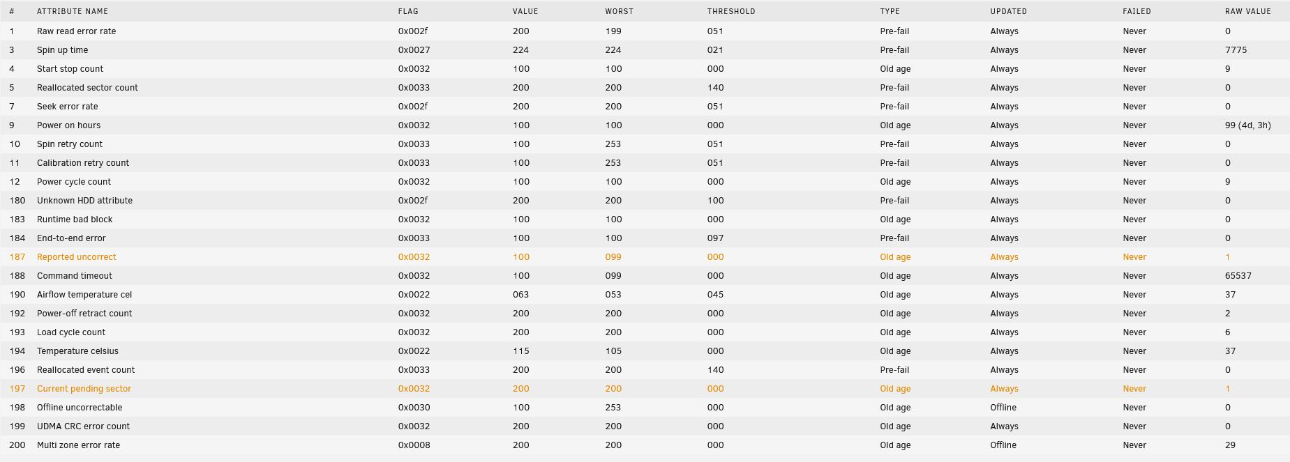

It it still showing pending sectors? It should have gone to zero after the sync.
So, the pending sector errors are gone, as you described.  The one that has remained is the #187 reported incorrect error.  This has a RAW value of 1.

I am reading up trying to understand what it all means... and the guy above talks about it.  There is one side of my mind which says... it appears to be a singular error and that in and of itself it is probably one of those things and it is fine.  The other side of my mind says... well, this is the parity drive (is it more serious if the parity drive fails?), it is not for me but a close relative, they are storing data which is highly precious to them, it could be an indicator of future trouble, ideally you would want to start of with no errors and it might be easier to nip it in the bud now.
But it is hard for me to make a call, because the word "error" is, due to my ignorance of servers and Unraid and SMART, highly emotive.  This might be nothing to worry about.
That would be OK for now, as long as an extended SMART test or parity check completes without any errors.

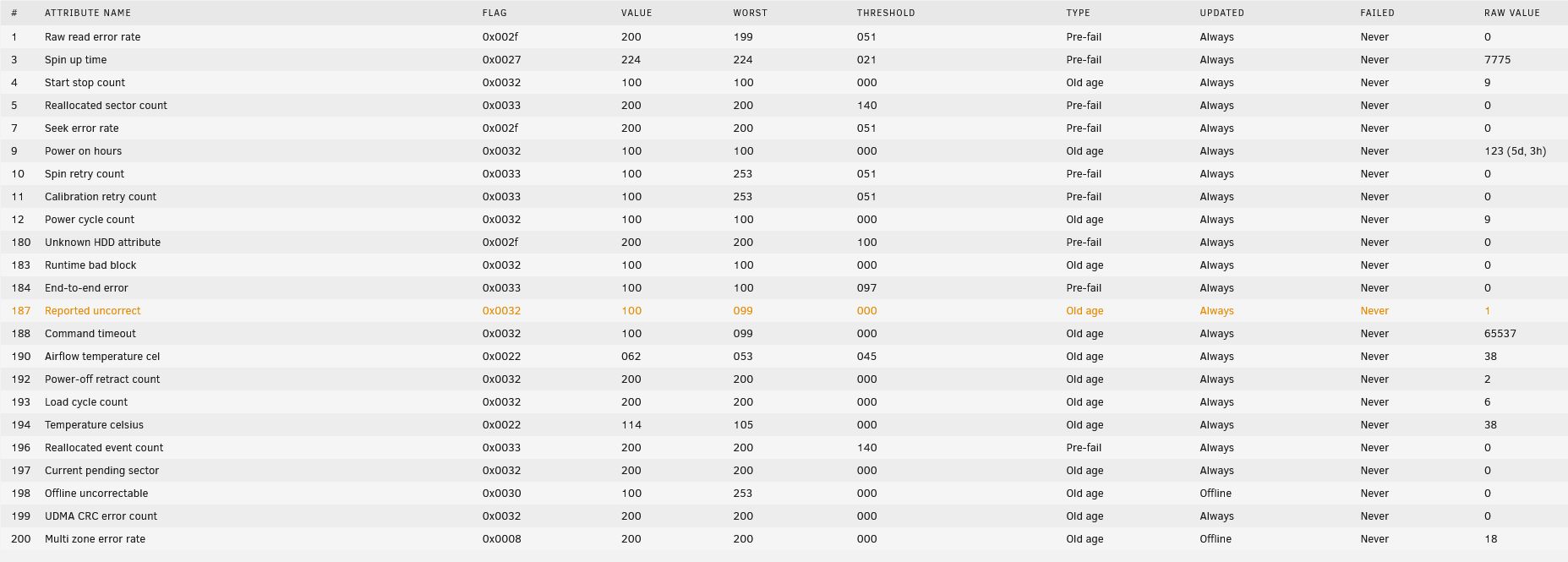

So, on the back of our discussion I started the array, formated the drives and then did an extended test.  It returned with read failure.
45 minutes ago, Loosetooth said:
Nope, after.
In that case the disk should be replaced.

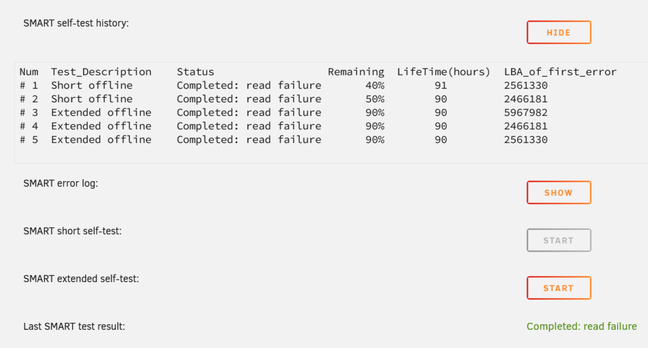

Crikey... I am still having problems.
I swapped out the parity drive with SMART error showing... and replaced it with a drive of exactly the same type and age.
I did not know if there was a certain protocol or way that I should do that... so I took the array offline, turned the server off.  Replaced drive and then turned everything back on.  On the "MAIN" page of Unraid I then assigned the new drive, in the drop down menu, as the new parity drive.  I then hit "START" so that it would do a parity check and rebuild the array.
This it did overnight.
I now have green everywhere on the dashboard.... but...
When I run a SMART self test it comes back as "READ FAILURE".  But it does not turn amber.  Extended tests complete almost instantly... and short tests run for a while, but then return the same result.  But it all comes back green, ie it does not turn amber.
Is this another bad drive, or something else at play here?

Post new diags.
11 minutes ago, JorgeB said:
Post new diags.
I actually dragged that drive out and replaced it again (I have two microservers and 8 drives, now 6).  I SMART tested the third drive and it came back sound and am rebuilding/doing parity sync with the third drive.  Will the diags still be relevant or have I effectively wiped them?
eaufarm-diagnostics-20221104-1100.zip
If it's a different drive there won't be a SMART report, but looks like the other one was also failing.
