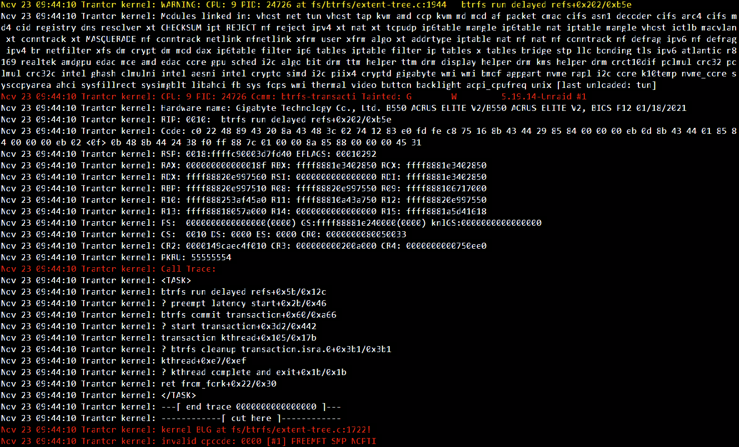

could this have caused the btrfs corruption I had, given that memtest did not find any RAM issues?
The screenshot doesn't show the complete call trace, if the server crashed, preventing the download of the diags before rebooting, enable the syslog server and post that if it happens again.
