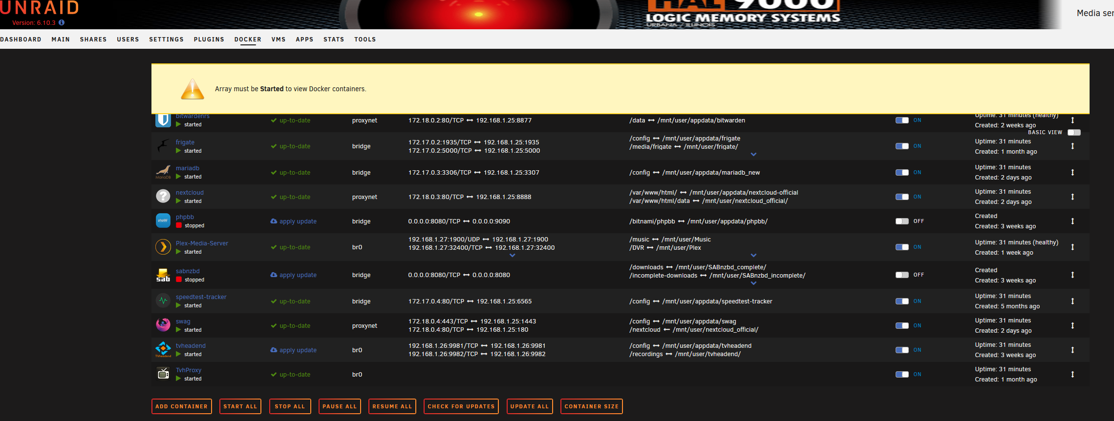

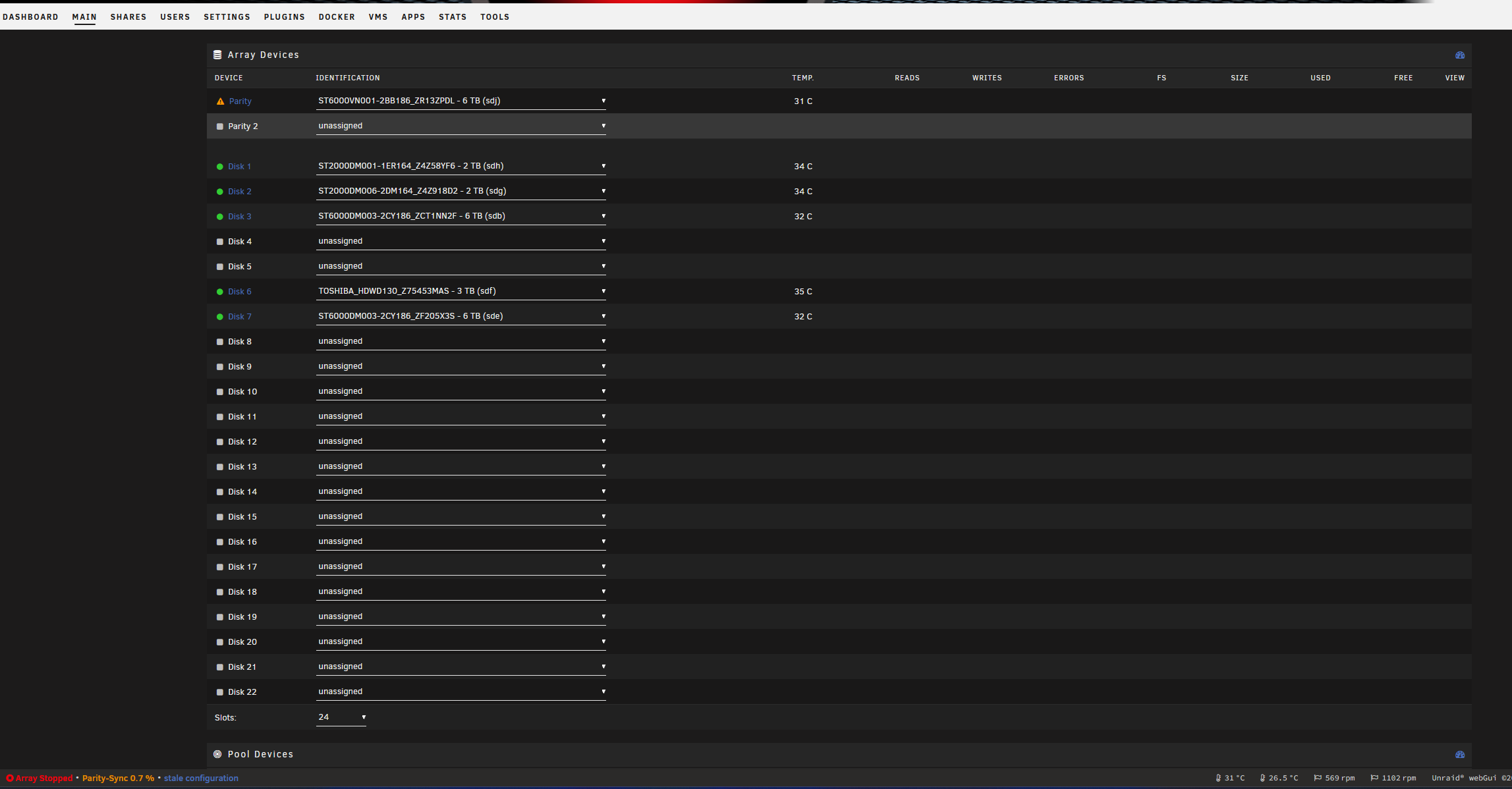

I have removed 2 data disks from my system by following https://wiki.unraid.net/Manual/Storage_Management#Removing_data_disk.28s.29
That all went well, I started the array but the GUI does not look correct and seems to believe the array is not started yet it does seem to be rebuilding parity as the % is changing and my dockers are running?
What should I do, leave it, or reboot (but won't that cancel the parity sync?) ?
Tried clearing browser cache, different browser etc

If you are using Firefox try a different browser and/or clear cache.
Yes, I normally use Firefox but as per my post I cleared cache and tried Edge, same issue.
Am I safe to leave it like this, or should I reboot?
You can reboot, parity sync will start over.
Ok great, thanks.
Thanks for the help, did a reboot, came up stopped, did a start and all looks good with a new parity sync beginning
