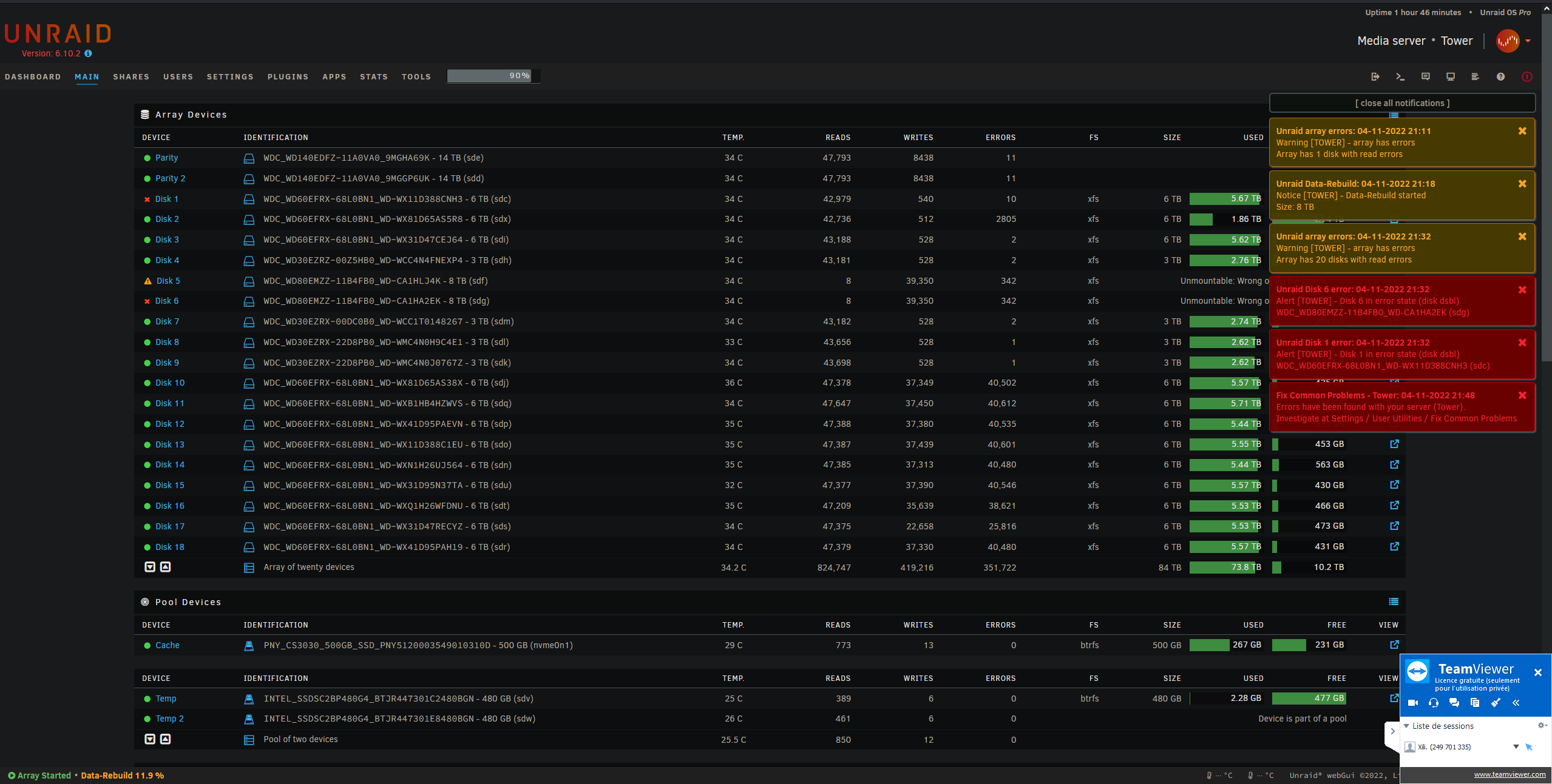

[HELP] 2-3 drive fail + 1 drive read error
Hello
I come to ask for help because I find myself in a delicate situation and I would not want to do more stupidity than what I have already done….
Already excuse me for the google translation….
To explain the situation, I have an array of 18hdds (3to to 6to), and two parity disks of 14 (following a start of disk renewal) + nvme cache and tmp in sdd
I had the brilliant idea of wanting to eject the small and old hdds from the array, namely 2to 3to 3to. So I replaced 2 disks with two 6to that I had on the side, reconstruction OK + 2 days without worries.
I changed the last one by another of 6to, and during the reconstruction of the latter I have one of the two previous ones which fails and stops me the reconstruction.
It is then at this moment that I realize that I have re-injected disks that unraid had excluded me from a few months ago……
big dump on my part.
I no longer have the exact details of what I tried with these 3 disks, but now I find myself with a system that has 2 hdd fail (disk5 and 6), and one that has read errors (disk 2) making the system very slow. And potentially who risks letting go of me.
So I ordered 2 8to disks urgently and shut down the machine while waiting.

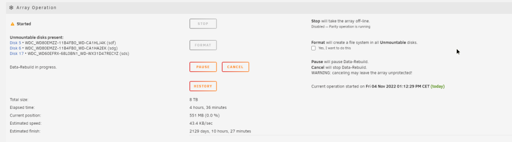

Today, after checking the integrity of the new disks, I injected them instead of the two fails to try to rebuild despite the reading problems on a 3rd
I hoped that it would pass, but I find myself with a reconstruction certainly in progress, but extremely slow (which I will not let go to the end as it is) and with many errors a priori… In addition a disc (17 m ' indicates "unmoutable . wrong or no file system)
Concretely what do I have on my array.
A lot (too much) of media, which are recoverable, even if it's boring if I lose everything, it's not dramatic.
On the other hand, I have 1.5to of nextcloud (obviously without backup, I didn't take the time to take care of my google drive ban), with personal/family docs, photos, for which I'm much more annoyed .
All my appdata is on nvme cache so safe.
At the moment I have the reconstruction in progress, but too slow for me to let it run. So unless it speeds up the solution will not work (especially since it seems to make a lot of mistakes…. I don’t know what I thought about it, if I should let it run or not….
I plan to stop the machine, make a new config, without the 3 disks, indicating to unraid that the config is functional... without certainty that it works?). and take the 3 disks one part to mount on another machine to recover their content (I don't know if unraid cuts the files or not .... If so in this case it is not manageable
Last possibility, launch the machine with mounted disk and go to recover my Nextcloud, even if very slow and it takes me 1 month, it will be manageable unlike the current reconstruction time

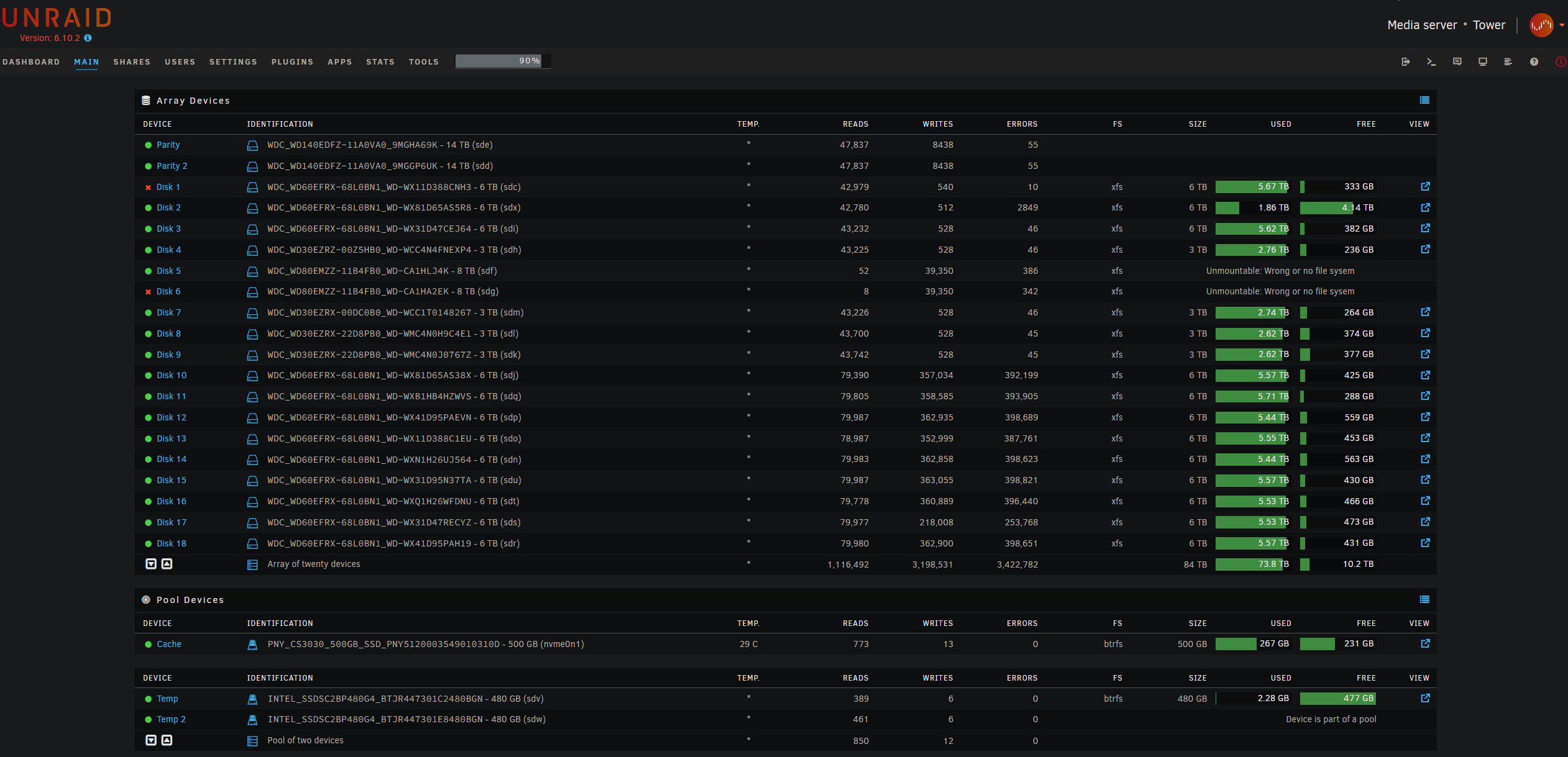

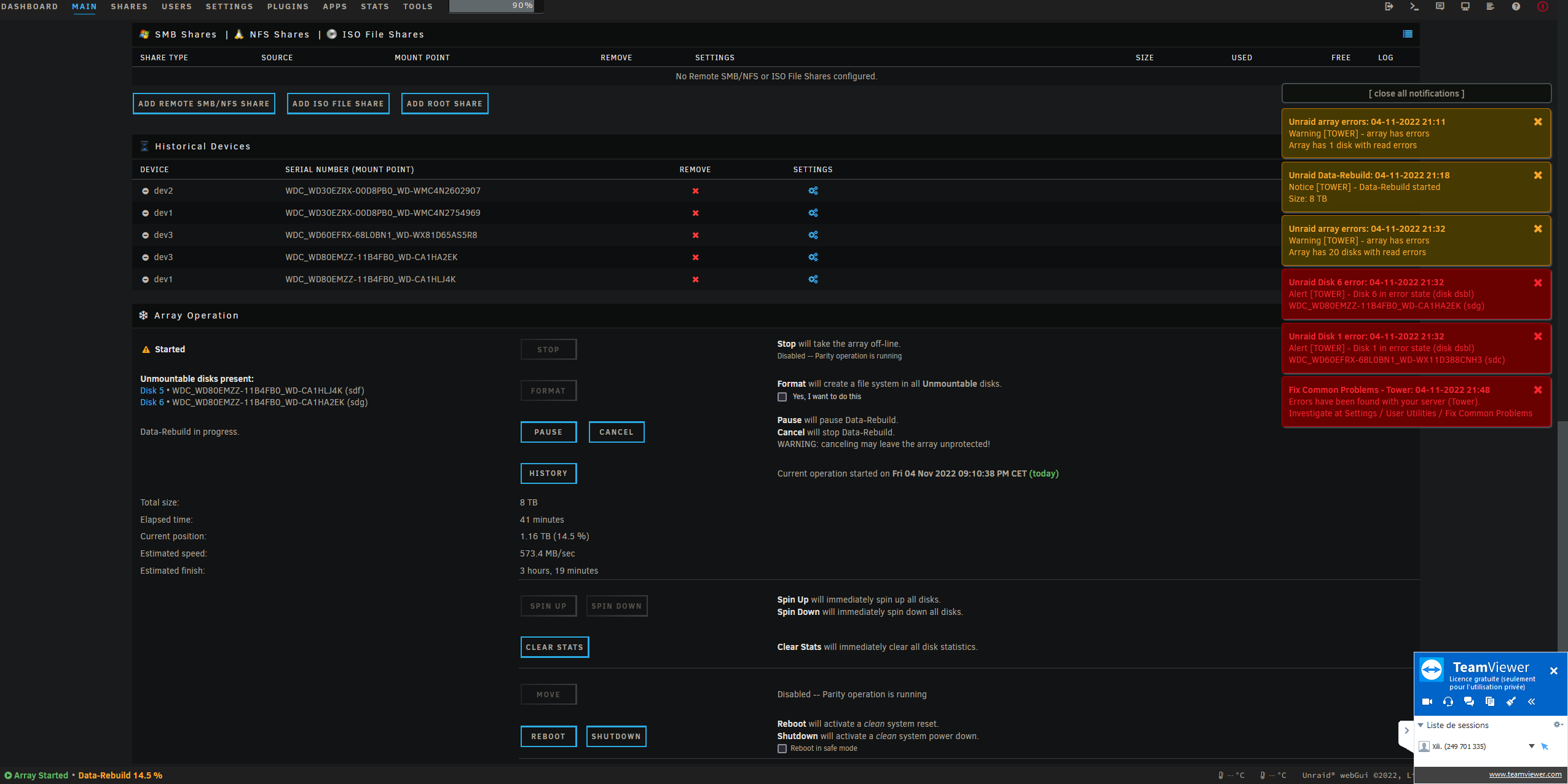

Well

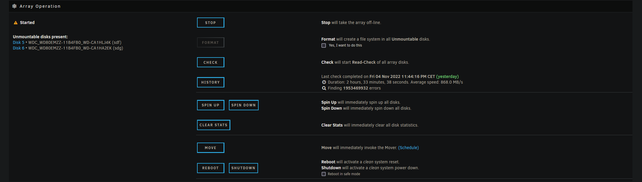

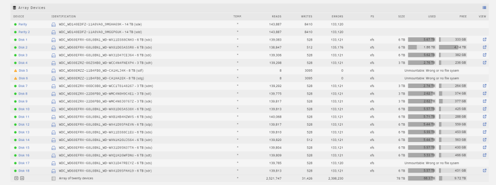

Unraid tried a rebuild with the two 8TB drives after the array booted. worries, one of the two discs is in error, the other is going to the end (strangely fast reconstruction and a lot of errors) ... but does not seem to be exploitable "Unmountable" surely because it does not have been forced at the beginning of the process. And during all that disk 1 is put in error, while it is a priori good
it doesn't seem terrible to me

OK,
I disabled IOMMU, remove everything that was on the pci. There remains only adaptec card that I changed port, and it is well fixed, and the nvme cache.
I did not dare to start the array (even in maintenance), for fear of making things worse, because I have:
- disk 1 which appears deactivated by unraid
- disk 5 seems OK, but not formatted, and I guess empty
- new disc 6 tested OK, which appears disabled by unraid.
I await your instructions.
Thank you for your help

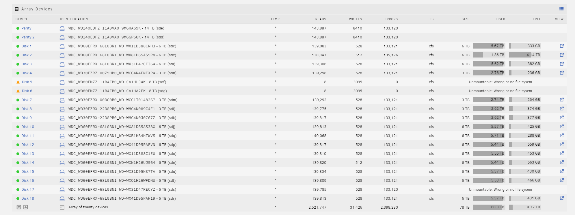

very fast start this time, I started in maintenance mode
tower-diagnostics-20221106-1425.zip
Still seeing the same HBA issues, do you have a different HBA you could use? Ideally an LSI.
