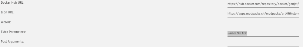

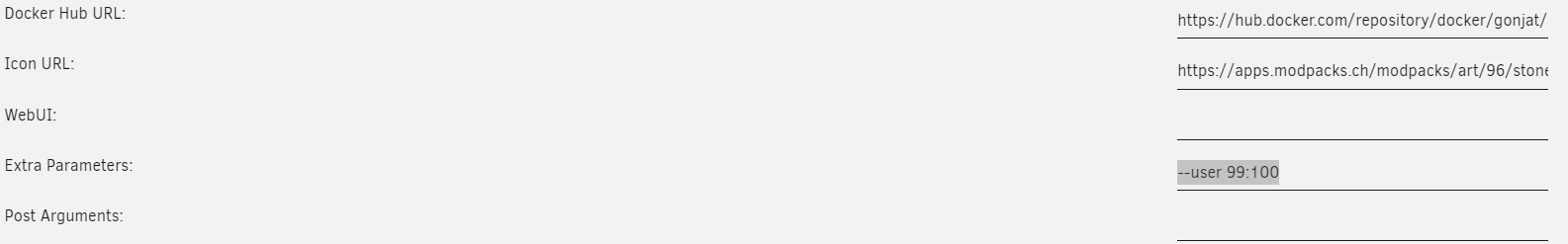

I have seen this issue before, remove your data folder in the appdata location and restart the docker to recreate it. the times I have seen this before is the data folder was created in with incomplete permissions.
So question. I did the extra args adding of --user 99:100 which fixed the permissions issue.  I have been running this fine up until this morning when I updated the docker. I assume this was to update to version 1.3.0.  Now my container won't start.  I get the below output from logs when I try to boot it.
Any ideas or suggestions? I guess I am going to backup my server.properties file, and my world folder, and try and reinstall, but hate doing that as I've lost stuff before doing that.
Edit: So updated, I manually changed it to pull from the 1.2.0 version (I also had to delete 3 modpacks that were added in 1.3.0, accelerated-decay-forge-0.1.1+mc1.18.2.jar #1584, eccentrictome-1.18.2-1.9.0.jar #1801, metalbarrels-1.18.2-4.3.jar #1693)
, and the docker boots fine.  So I'm not sure what changed from 1.2.0 to 1.3.0 besides the modpack version, but something is causing it to not boot correctly. I can do whatever testing or provide any logs that are necessary, just let me know.
Edit 2: So I have been playing and everything is perfect, except now the JustHammers mod isn't working. I can craft the hammers, but they only break 1 block, not the 3x3x1 like they should. Nothing that I have done should have impacted this modpack so not sure how to fix it. Hopefully you can fix the 1.3.0 update and I can just update and have everything working again!

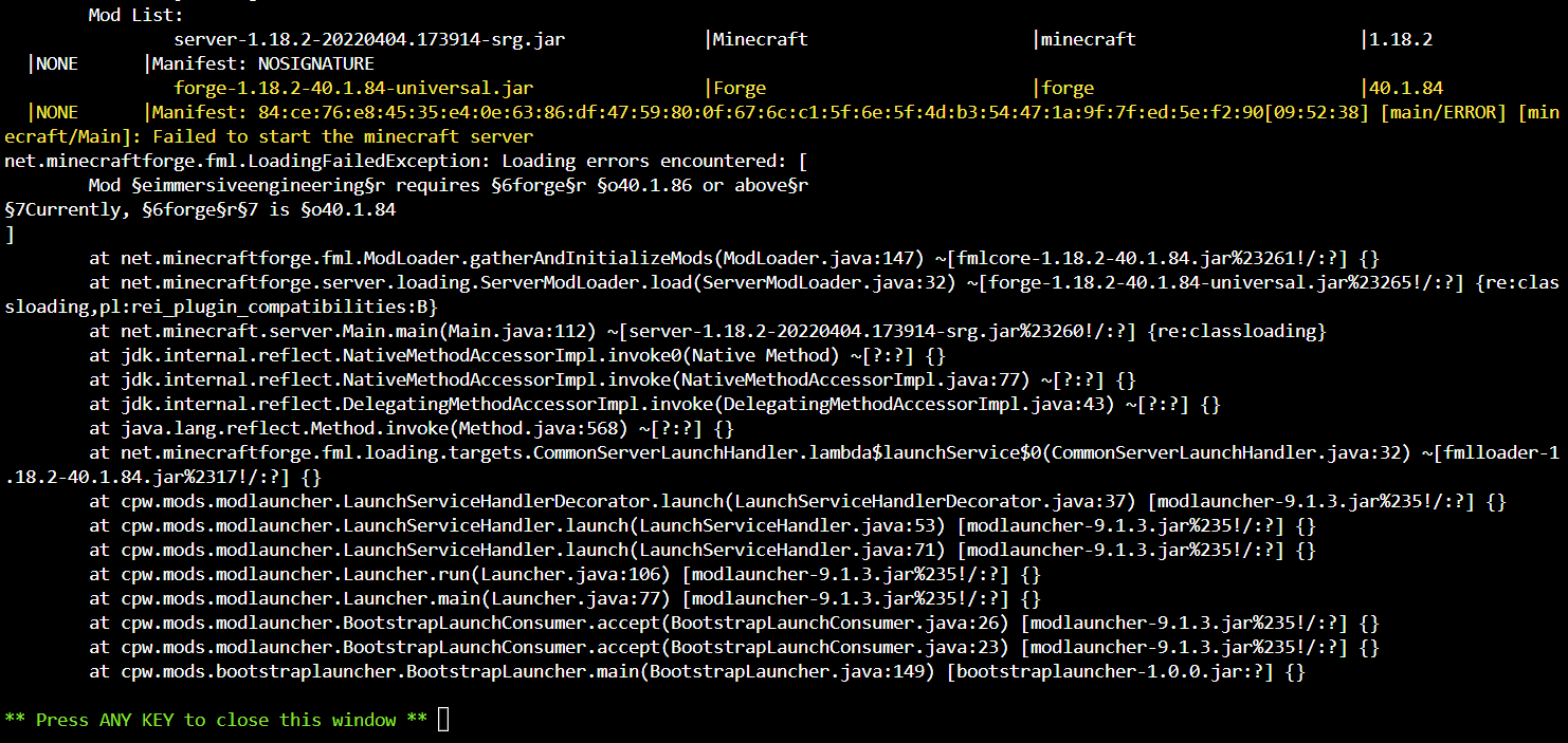

+ cd /data
+ [[ -f serverinstall_100_2288 ]]
+ [[ -n Powered By Dockers Awesome Sauce! ]]
+ sed -i '/motd\s*=/ c motd=Powered By Dockers Awesome Sauce!' /data/server.properties
+ [[ -n ChaosCraft ]]
+ sed -i '/level-name\s*=/ c level-name=ChaosCraft' /data/server.properties
+ [[ -n '' ]]
+ [[ true = \f\a\l\s\e ]]
+ echo eula=true
+ [[ -n -Xms6144m -Xmx10240m ]]
+ echo -Xms6144m -Xmx10240m
+ awk -v RS=, '{print}'
+ curl -o log4j2_112-116.xml https://launcher.mojang.com/v1/objects/02937d122c86ce73319ef9975b58896fc1b491d1/log4j2_112-116.xml
  % Total    % Received % Xferd  Average Speed   Time    Time     Time  Current
                                 Dload  Upload   Total   Spent    Left  Speed
100  1131  100  1131    0     0   7964      0 --:--:-- --:--:-- --:--:--  7964
+ chmod +x start.sh
+ ./start.sh
Exception in thread "main" java.io.UncheckedIOException: java.util.zip.ZipException: zip END header not found
        at [email protected]/cpw.mods.niofs.union.UnionFileSystem.openFileSystem(UnionFileSystem.java:59)
        at java.base/java.util.stream.ReferencePipeline$3$1.accept(Unknown Source)
        at java.base/java.util.stream.ReferencePipeline$2$1.accept(Unknown Source)
        at java.base/java.util.AbstractList$RandomAccessSpliterator.forEachRemaining(Unknown Source)
        at java.base/java.util.stream.AbstractPipeline.copyInto(Unknown Source)
        at java.base/java.util.stream.AbstractPipeline.wrapAndCopyInto(Unknown Source)
        at java.base/java.util.stream.ReduceOps$ReduceOp.evaluateSequential(Unknown Source)
        at java.base/java.util.stream.AbstractPipeline.evaluate(Unknown Source)
        at java.base/java.util.stream.ReferencePipeline.collect(Unknown Source)
        at [email protected]/cpw.mods.niofs.union.UnionFileSystem.<init>(UnionFileSystem.java:52)
        at [email protected]/cpw.mods.niofs.union.UnionFileSystemProvider.newFileSystemInternal(UnionFileSystemProvider.java:115)
        at [email protected]/cpw.mods.niofs.union.UnionFileSystemProvider.newFileSystem(UnionFileSystemProvider.java:105)
        at [email protected]/cpw.mods.jarhandling.impl.Jar.<init>(Jar.java:75)
        at [email protected]/cpw.mods.jarhandling.SecureJar.from(SecureJar.java:58)
        at MC-BOOTSTRAP/[email protected]/net.minecraftforge.fml.loading.moddiscovery.ModJarMetadata.buildFile(ModJarMetadata.java:41)
        at MC-BOOTSTRAP/[email protected]/net.minecraftforge.fml.loading.moddiscovery.MinecraftLocator.scanMods(MinecraftLocator.java:33)
        at MC-BOOTSTRAP/[email protected]/net.minecraftforge.fml.loading.moddiscovery.ModDiscoverer.discoverMods(ModDiscoverer.java:59)
        at MC-BOOTSTRAP/[email protected]/net.minecraftforge.fml.loading.FMLLoader.beginModScan(FMLLoader.java:166)
        at MC-BOOTSTRAP/[email protected]/net.minecraftforge.fml.loading.FMLServiceProvider.beginScanning(FMLServiceProvider.java:86)
        at MC-BOOTSTRAP/[email protected]/cpw.mods.modlauncher.TransformationServiceDecorator.runScan(TransformationServiceDecorator.java:112)
        at MC-BOOTSTRAP/[email protected]/cpw.mods.modlauncher.TransformationServicesHandler.lambda$runScanningTransformationServices$8(TransformationServicesHandler.java:100)
        at java.base/java.util.HashMap$ValueSpliterator.forEachRemaining(Unknown Source)
        at java.base/java.util.stream.AbstractPipeline.evaluateToArrayNode(Unknown Source)
        at java.base/java.util.stream.ReferencePipeline.toArray(Unknown Source)
        at java.base/java.util.stream.ReferencePipeline.toList(Unknown Source)
        at MC-BOOTSTRAP/[email protected]/cpw.mods.modlauncher.TransformationServicesHandler.runScanningTransformationServices(TransformationServicesHandler.java:102)
        at MC-BOOTSTRAP/[email protected]/cpw.mods.modlauncher.TransformationServicesHandler.initializeTransformationServices(TransformationServicesHandler.java:55)
        at MC-BOOTSTRAP/[email protected]/cpw.mods.modlauncher.Launcher.run(Launcher.java:87)
        at MC-BOOTSTRAP/[email protected]/cpw.mods.modlauncher.Launcher.main(Launcher.java:77)
        at MC-BOOTSTRAP/[email protected]/cpw.mods.modlauncher.BootstrapLaunchConsumer.accept(BootstrapLaunchConsumer.java:26)
        at MC-BOOTSTRAP/[email protected]/cpw.mods.modlauncher.BootstrapLaunchConsumer.accept(BootstrapLaunchConsumer.java:23)
        at [email protected]/cpw.mods.bootstraplauncher.BootstrapLauncher.main(BootstrapLauncher.java:149)
Caused by: java.util.zip.ZipException: zip END header not found
        at jdk.zipfs/jdk.nio.zipfs.ZipFileSystem.findEND(Unknown Source)
        at jdk.zipfs/jdk.nio.zipfs.ZipFileSystem.initCEN(Unknown Source)
        at jdk.zipfs/jdk.nio.zipfs.ZipFileSystem.<init>(Unknown Source)
        at jdk.zipfs/jdk.nio.zipfs.ZipFileSystemProvider.getZipFileSystem(Unknown Source)
        at jdk.zipfs/jdk.nio.zipfs.ZipFileSystemProvider.newFileSystem(Unknown Source)
        at java.base/java.nio.file.FileSystems.newFileSystem(Unknown Source)
        at [email protected]/cpw.mods.niofs.union.UnionFileSystem.openFileSystem(UnionFileSystem.java:57)
        ... 36 more
[Log4jPatcher] [INFO] Transforming org/apache/logging/log4j/core/pattern/MessagePatternConverter
[Log4jPatcher] [WARN]  Unable to find noLookups:Z field in org/apache/logging/log4j/core/pattern/MessagePatternConverter
[Log4jPatcher] [INFO] Transforming org/apache/logging/log4j/core/lookup/JndiLookup
2022-11-16 05:48:53,610 main WARN Advanced terminal features are not available in this environment
[05:48:53] [main/INFO] [cp.mo.mo.Launcher/MODLAUNCHER]: ModLauncher running: args [--launchTarget, forgeserver, --fml.forgeVersion, 40.1.84, --fml.mcVersion, 1.18.2, --fml.forgeGroup, net.minecraftforge, --fml.mcpVersion, 20220404.173914, nogui]
[05:48:53] [main/INFO] [cp.mo.mo.Launcher/MODLAUNCHER]: ModLauncher 9.1.3+9.1.3+main.9b69c82a starting: java version 17.0.2 by Eclipse Adoptium
[05:48:55] [main/INFO] [mixin/]: SpongePowered MIXIN Subsystem Version=0.8.5 Source=union:/data/libraries/org/spongepowered/mixin/0.8.5/mixin-0.8.5.jar%2314!/ Service=ModLauncher Env=SERVER
** Press ANY KEY to close this window **
Edited by DarthLlama
Hi DarthLlama sorry for the late reply. Haven't been feeling great this week and have been resting for most of it. I will be able to take a look shortly and try to push a fixed update of 1.3.0 if I can figure out the cause. Hopefully I can get it sorted quickly for you. Thanks for all the information so far!
Edited by GonjaT
typo
DarthLlama,
Please do the following and report back if the issue is fixed and or persists.
1. Please navigate to your Stoneblock 3 appdata folder and delete the "serverinstall_100_2288" file. (Only this file needs to be removed. Backup the server properties and world folder too if you want.)
2. Change the tag to gonjat/docker-ftbstoneblock3 or gonjat/docker-ftbstoneblock3:1.3.0
3. Test to see if the problems have been resolved.
I hope the image I just re-pushed to dockerhub fixed the issue.
Thanks.

Hey GonjaT!
No sweat about it, I hope you are feeling better. So I did what you said, uninstalled the serverinstall_100_2283 file (Mine was 2283 not 2288?) Backed up the server properties and world folder just in case. Then I updated the tag to gonjat/docker-ftbstoneblock3 (just removed the ":1.2.0" flag I had added), then saved it and let it update. Updated my client also, logged in, and all working!!!!
Thanks so much for the reply and quick fix!

On FTB-One, I get passed the permission issues and have the following issues listed below. Seems to also be trying to load from version 1.18.2-40.1.84 when it downloaded version 1.19-14.0.63.
P.S. Enjoy the Holidays.
2022/12/14 08:00:52 Installed!
+ [[ -n Sanchez Family Games ]]
+ sed -i '/motd\s*=/ c motd=Sanchez Family Games' /data/server.properties
sed: can't read /data/server.properties: No such file or directory
+ [[ -n world ]]
+ sed -i '/level-name\s*=/ c level-name=world' /data/server.properties
+ [[ -n SilentStray ]]
+ echo SilentStray
+ echo eula=true
100  1131  100  1131    0     0   9750      0 --:--:-- --:--:-- --:--:--  9666
+ jre/jdk-17.0.2+8-jre/bin/java -javaagent:log4jfix/Log4jPatcher-1.0.0.jar -XX:+UseG1GC -XX:+UnlockExperimentalVMOptions -Xmx6144M -Xms4096M @user_jvm_args.txt @libraries/net/minecraftforge/forge/1.18.2-40.1.84/unix_args.txt nogui
Error: could not open `libraries/net/minecraftforge/forge/1.18.2-40.1.84/unix_args.txt'

1 Issue I'm fighting right now is that I cant get the server to show that its online properly in the Minecraft server list. This will be something I iron out over time, but you will still be able to join the server.

Hey @GonjaT. I just updated the docker to the current StoneBlock 3 version (1.5). It updated fine, but when it gets to the end of loading after the update I get the below error.
It looks like it is expecting a different forge version for immersive engineering and isn't finding it? I couldn't find a forge file to update or replace to fix it on my own (I have your docker and another one for StoneBlock 3, as my buddies and I use one for a test world and one for streaming/recording).
Any ideas on what happened and how to fix it?

Edit:  So I compared the Immersive Engineering version between this docker and the one that update and started.  For some reason it was using an older version of IE (ImmersiveEngineering-1.18.2-8.2.2-154.jar). So I copied it to your docker, and renamed the one in your docker (ImmersiveEngineering-1.18.2-8.3.0-155.jar) to add .bak at the end to temp disable it. Then I booted your docker and it booted and works perfectly. Not sure why the newer IE is causing issues. (I also had to do the same on my client PC to make it match the server).

Thanks for the info DarthLlama. This sounds like an FTB issue. I will reach out to them and let them know there is an issue with IE and the potential workaround.

No worries at all. And yeah I found it weird it did that. I assume it's the pack, but wanted to post for others, including the fix I found.
