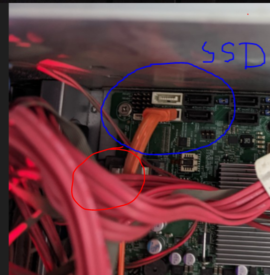

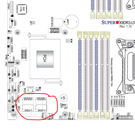

There one miniSAS cable connected to the port circled in red, where does that cable go?
There is 1 mini sas buit-in main board and one cable pluged to front as picture bellow.
The RAID Card have 2 mini sas and 2 cables pluged to front.
So my case have 3 mini sas cable.

Disconnect that miniSAS cable, leave only the cables that go to the LSI, you have two different controllers connected to the same enclosure.
After doing that post new diags after array start.
OK, HBA errors are gone now, cannot say for sure having the two controllers connect was the reason but there's filesystem corruption on disk13:
