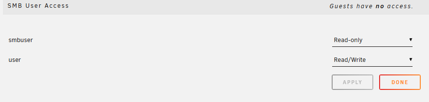

@DanielPT, I believe what the problem may be is the the Group is not set to users
I have just verified what @wgstarks stated.   In fact, even if the owner is another user, a second user can modify files if they are given permission to do so.
As an example, I just deleted a file owned by   smbuser    while logged in as   user   where the permissions were set as follows:
In this case, the actual user would not be able to delete the file!
What I think happens behind the scenes is that all Share Users are members of the   users   Group.  Thus they have the same privileges as the owner if the permissions are set to the defaults of 777 for directories and 666 for files.
As a point of information, either permission script will change the Owner to nobody and the Group to users and the permissions to 777 or 666.
EDIT:  Please note the permissions.  I understand that some Dockers do not set up the permissions correctly for the Group.  If they don't, you will have a problem with Unraid behavior eventually.
